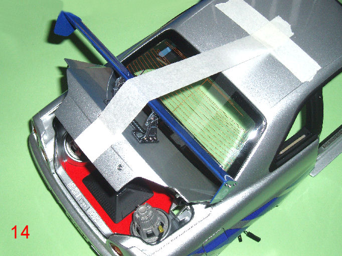

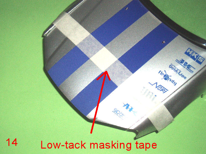

Pic 14: Use low tack masking tape to hold the boot open for now.

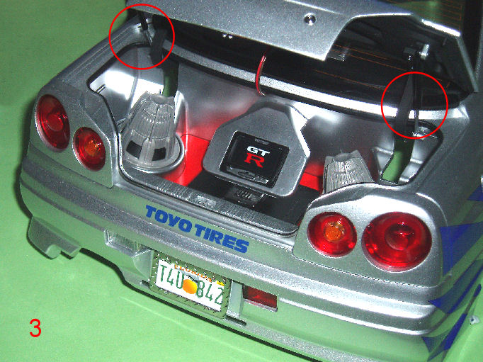

Pic 15: Retrieve the multimedia unit 96G and fit the LED ‘S’ into the hole on the rear. This is VERY fiddly so take your time.
Pic 16: Fit the multimedia unit in place in the boot locating the two pins on the upper edge in the holes in the rear of the boot.

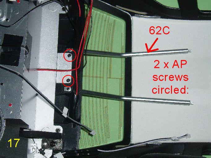

Pic 17: Retrieve the roll cage 62C previously saved and fit it into the rear of the parcel shelf.
The wide bracket should be under the parcel shelf when seen from above as in the picture.
Fix using 2 x AP screws.

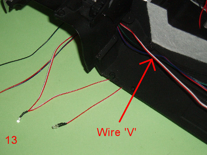

Pic 12: Repeat with the wires/LED’s ‘N’.
Pic 13: Repeat with the wires/LED’s ‘V’.

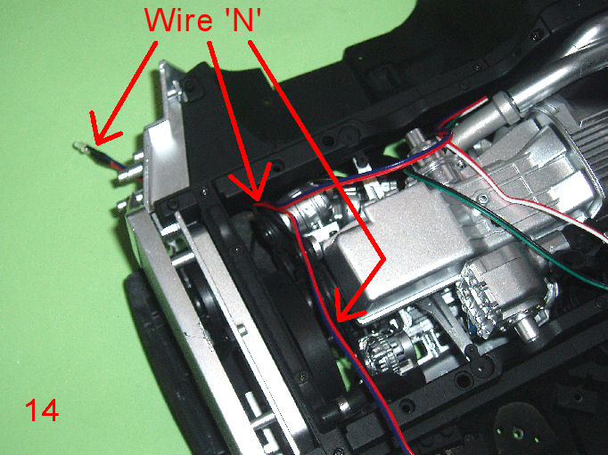

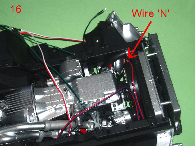

Pic 14: Turn the model upside down and locate the red and blue wires ‘N’.
One of the LED’s is on a longer separate wire.

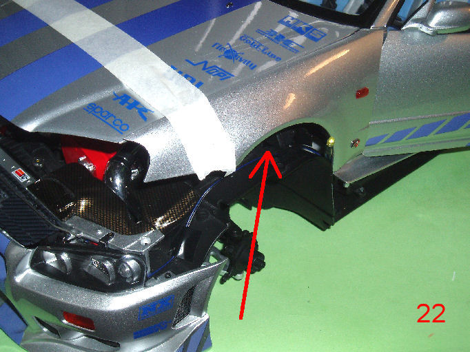

Keep this to one side and feed the other LED down the front side of the engine bay so it comes out at the front of the car.
It sounds fiddly but it’s actually quite easy.

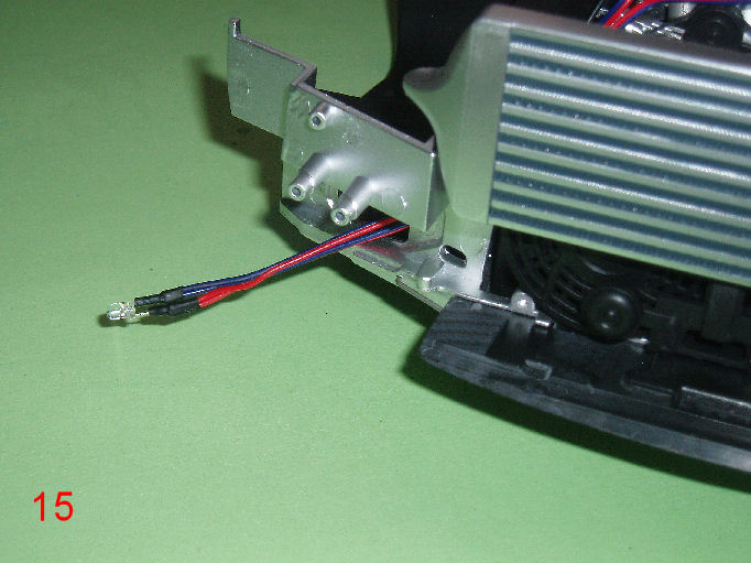

Pic 15: Showing the correct position of the LED.
Pic 16: Feed the other red/blue wire ‘N’ through the other side of the engine bay.
Pic 17: Showing the correct position of the LED.

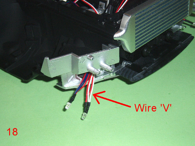

Pic 18: Repeat the whole process with the two LED’s on the red/white wires ‘V’.
Pic 19: Showing the correct position of the LED.

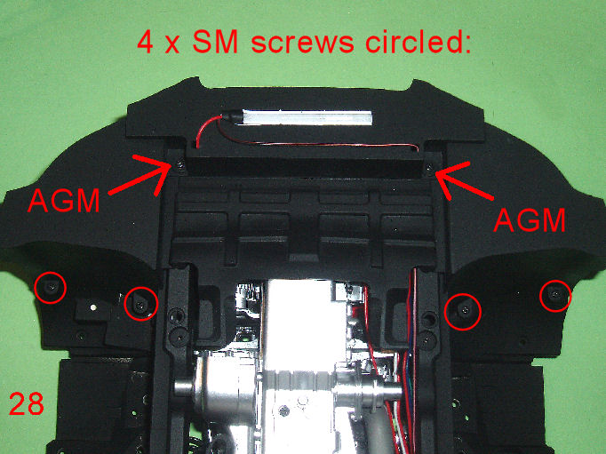

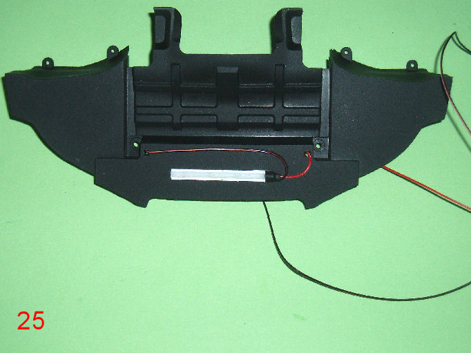

Pic 28: With the model upside down, fit the front panel and secure it with 2 x AGM screws and 4 x SM screws.

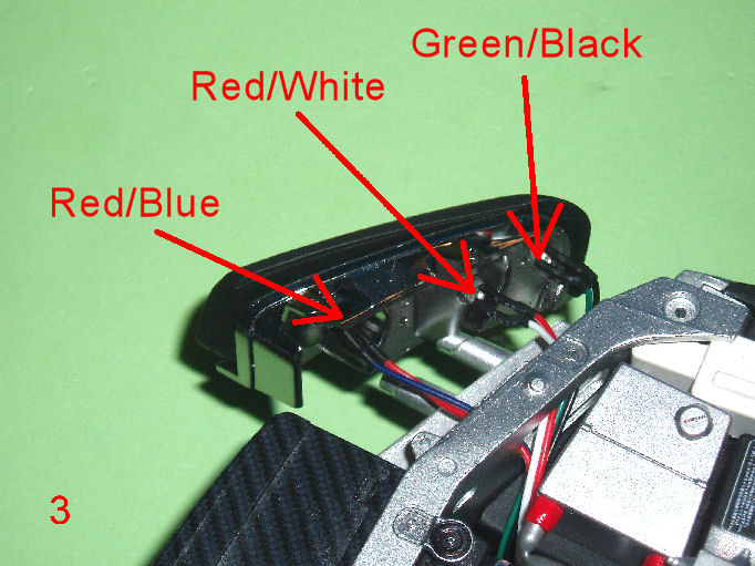

Pic 3: Connect the LED’s into the rear of the light in the order shown.

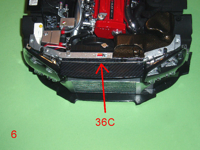

Pic 6: Re-fit the bonnet support 36C removed in the previous stage.

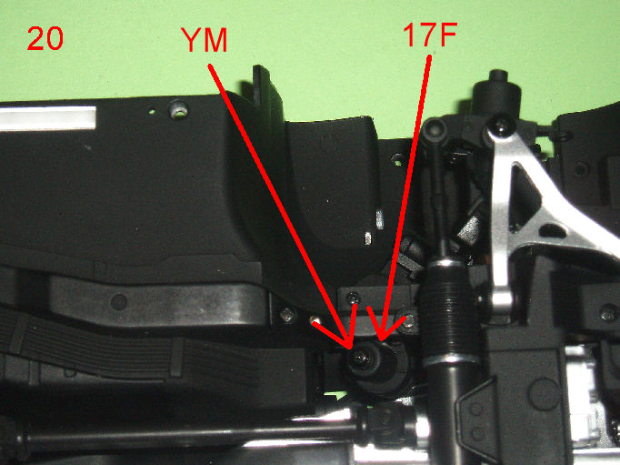

Pic 7: Turn the model upside down and remove the AIM screw and idler arm 17F. The screw can be discarded.
Pic 8: Retrieve the front suspension subframe assembly and fit the idler arm to the locating pin on the right side of 13K. Fix with I x AIM screw.

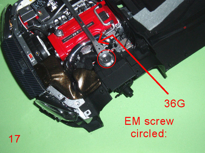

Pic 17: Retrieve the turret bar 36G saved from stage 36 and fit it as shown and fix it using 1 x EM screw through the wheel arch and into the shock absorber underneath.

Pic 19: Fix the parts from above as before using 1 x EM screw.
Pic 20: With the model upside down, fit 1 x YM screw where the idler arm had been previously fitted to 17F.

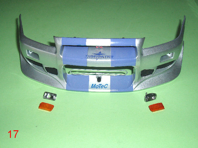

Pic 17: Retrieve the car body front panel and carefully push the sidelight assemblies out from behind.
Pic 18: Locate the LED wires 47C and 47D and run them along the chassis from the rear to exit at the front as shown.

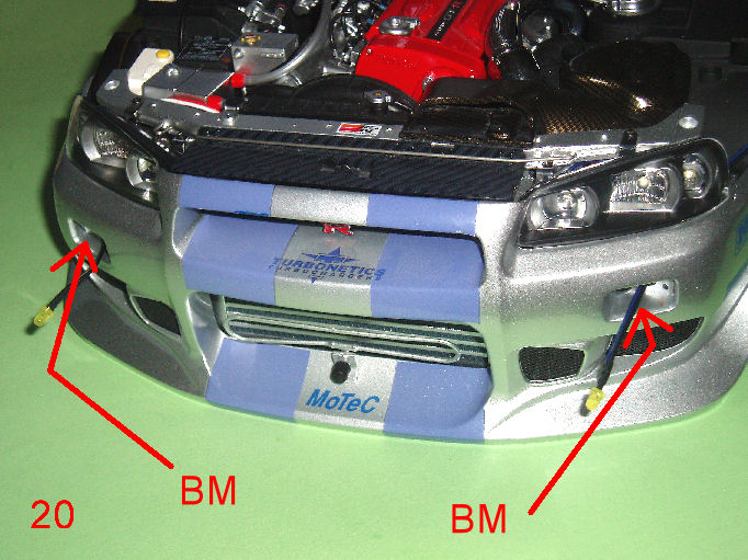

Pic 19: Position the front body with the LED’s exiting from the sidelight apertures.
Pic 20: Fix the front body in place using 2 x BM screws through the light apertures.
Pic 21: Press the LED’S into the light reflectors.
Pic 22: Reassemble the light units as shown.

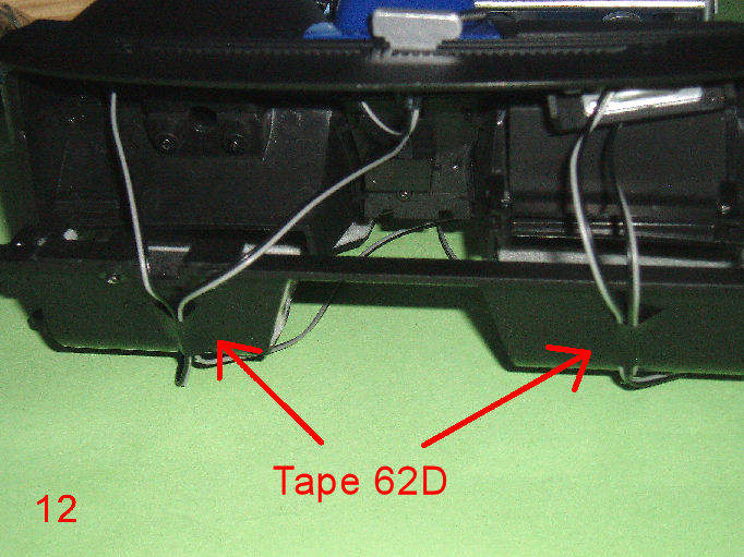

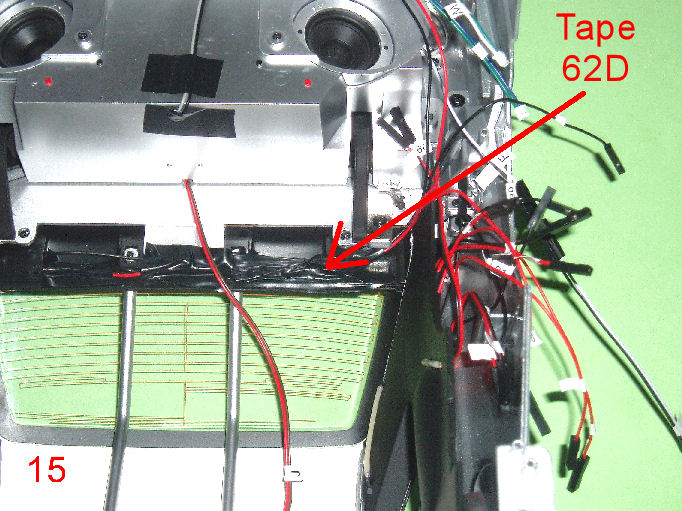

Pic 23: Run the blue wires ‘G’ over the wheel arch as shown and fix using tape 62D.

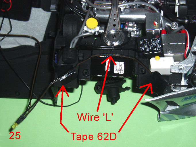

Pic 25: Run the brown wires ‘L’ over the wheel arch as shown and fix using tape 62D.
Pic 26: Making sure the second LED on the wires is free, tape the wires along the floor as shown.

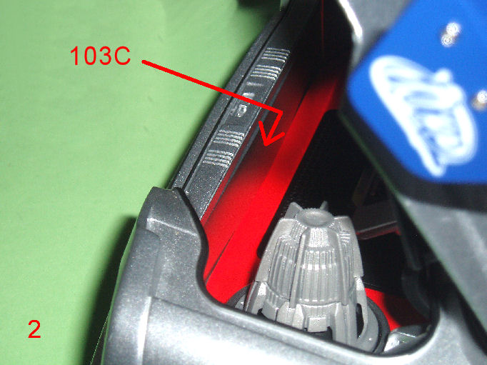

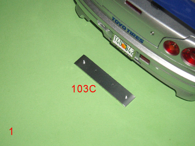

Pic 1: Locate the inner boot panel 103C.
Pic 2: Press-fit the panel inside the boot as shown. It will only fit one way.
Pic 3: The printed instructions do not mention this but you can now fit the boot struts together on each side.

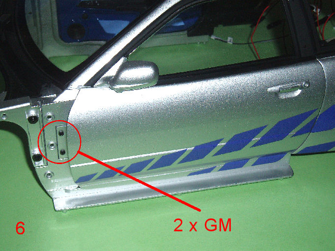

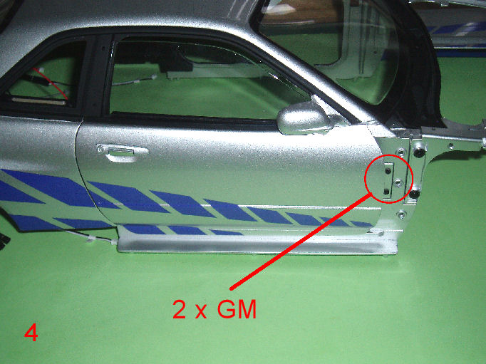

Pic 4: Fit the driver’s door and secure with 2 x GM screws.
Pic 5: You can temporarily tape the door shut. This will be helpful for future parts of this stage.

Pic 7: You can temporarily tape the boot shut. This will be helpful for future parts of this stage.

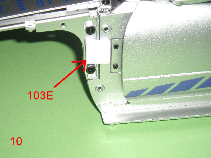

Pic 10: Stick the self-adhesive pad 103E to the body just in front of the door hinge as shown.

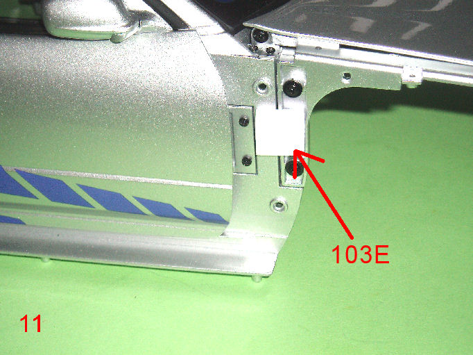

Pic 11: Stick the self-adhesive pad 103E to the other side of the body just in front of the door hinge as shown.

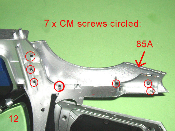

Pic 12: With the model upside down fit the front wing 85A in place and fix from the inside using 6 x CM screws.
NOTE – The printed instructions do not mention the 1 x CM screw that must be fitted from the top of the wing at the front, with the body the right way up. DO NOT fit screws in the two other holes on the top edge of the wing

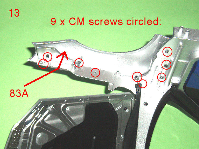

Pic 13: With the model upside down fit the front wing 83A in place and fix from the inside using 6 x CM screws.
NOTE – The printed instructions do not mention the 1 x CM screw that must be fitted from the top of the wing at the front, with the body the right way up. DO NOT fit screws in the other two holes on the top edge of the wing

Pic 15: With the main body upside down in the position shown, tape all of the wires from the left body side so that they exit with the main set of wires on the right.
This does not include any wires from the boot area.
#20 Posted : 20 August 2025 13:02:41
Posts: 5,829
Points: 17,639
STAGE 103C:
Pic 16A: This shows the instructions from the printed set, part 103-11.
Connect all the wires from the body to the PCB in the order shown in the circled image in the printed instructions for 103-11.
NOTE – The larger illustration is incorrect. DO NOT follow that diagram.
Wires ‘1’ must be on the right, at the end of the PCB, with the others following numerically to the left.
Pic 16: Prop the main body on its side as close to the floor section as you can, as shown.
NOTE – As stated in 16A, the larger illustration is incorrect. DO NOT follow that diagram.
When this is done, you can tape all of the connections together using tape 62D to prevent any of the plugs coming undone in the next few steps.
Pic 17: Tuck any loose wires up inside the body panel as shown.

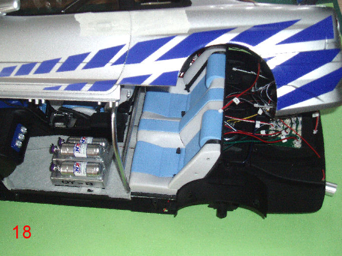

Pic 18: VERY carefully tilt the body over the chassis and prop it up so there is access to the PCB in the boot.
If you do not do this you will be unable to connect the final wiring plugs at the rear.

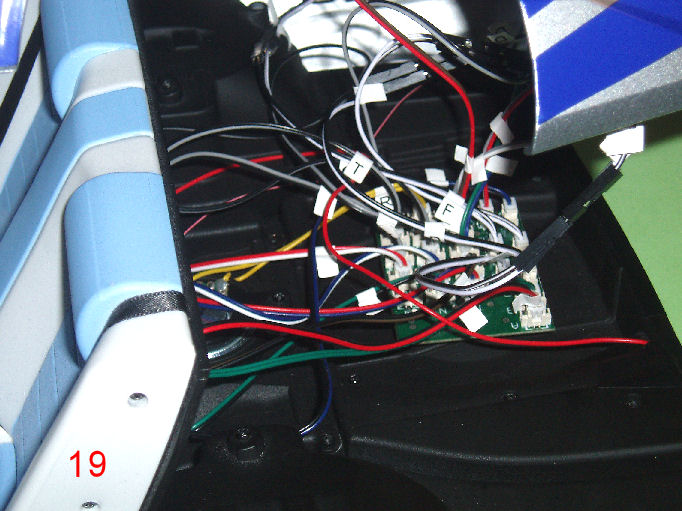

Pic 19: Following the wiring diagram in the printed instructions, connect all of the wires that are not yet plugged in to the PCB.
Take your time here as access to the PCB is quite difficult due to some of the wires being quite short.
MAKE SURE ALL PLUGS ARE CONNECTED.
At this stage you can test all the recently installed electrics.
To avoid a large number of unnecessary pics, follow the guide in the printed instructions.
When you are satisfied everything works properly, proceed with the build.
Pic 20: Carefully fit the body over the top of the chassis, starting at the back.
Pic 21: Make sure the PCB at the side of the car is sitting upright and is not trapped anywhere.
Pic 22: Lift the front of the body and prop it up so there is some access to the inside area.
Do not try to lift it too high as you may dislodge plugs in the side PCB.
