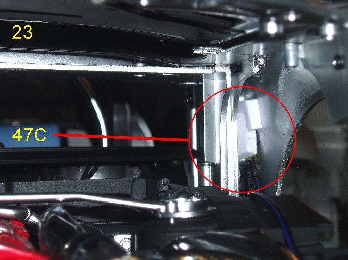

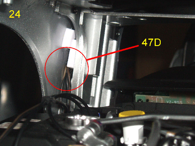

Pic 24: On the other side, using long tweezers, fit the LED 47D into the space between the two previously fitted pads as indicated.
Be patient as this is quite tricky.

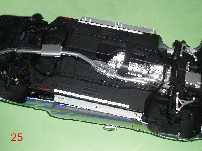

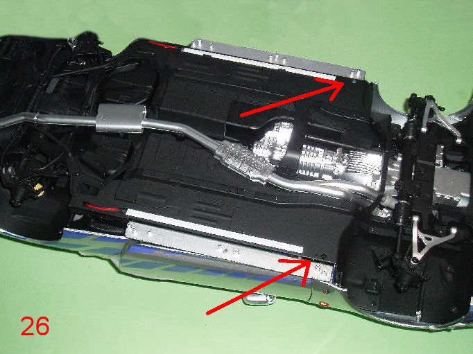

Pic 25: With care, turn the model upside down and lower the chassis into the body making sure no wires are trapped or showing along the edges.
Pic 26: It is possible you might find the chassis will not sit level with the bodywork at one of the indicated edges.

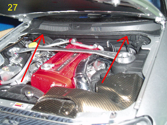

Pic 27: If this is the case, turn the model the right way up and open the bonnet.
Look at the rear firewall where indicated.
You should not be able to see any silver bodywork along the upper edge.
If you can, using a fine flat blade screwdriver, slide it between the top edge of the firewall and the body and carefully lever the firewall forwards at the top where the silver is showing.
The body will drop down into place under its own weight.

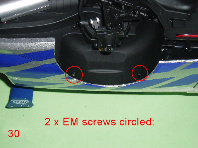

Pic 28: Turn the model over again and inert 2 x EM screws in the wheel arch where shown.

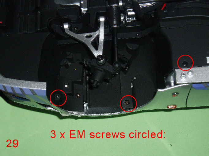

Pic 29: Insert 3 more EM screws where shown.
Pic 30: Repeat on the other rear wheel arch.

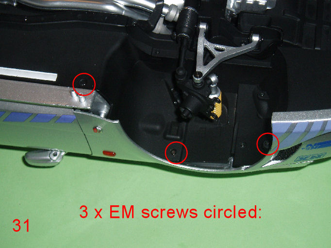

Pic 31: Repeat at the other front wheel arch.

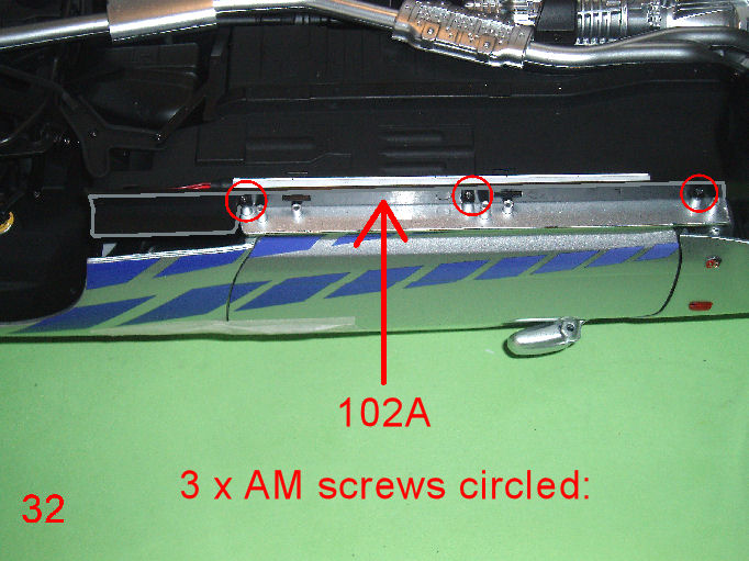

Pic 32: Retrieve the side trim 102A and fit it to the underside of the car as shown.
Fix using 3 x AM screws.

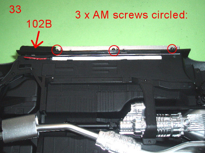

Pic 33: Retrieve the side trim 102B and fit it to the underside of the car as shown.

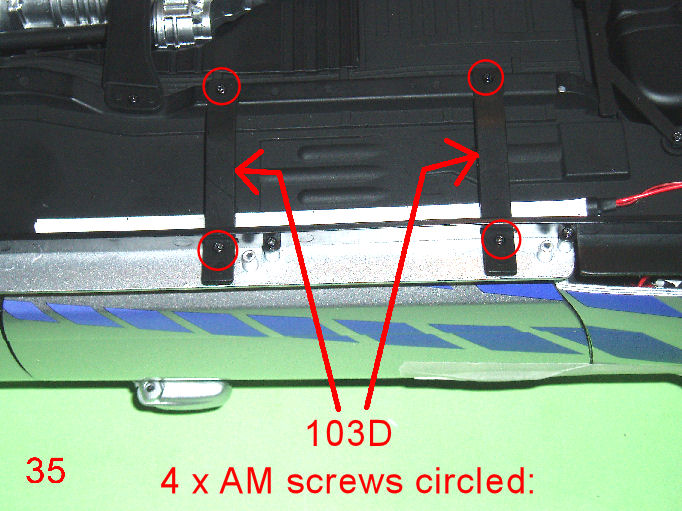

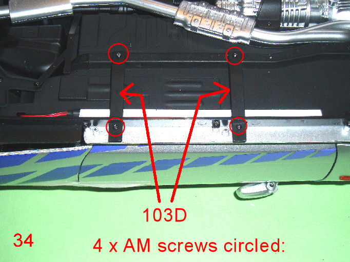

Pic 34: Fit 2 x reinforcement braces 103D as shown and fix with 4 x AM screws.
Pic 35: Repeat on the other side of the car.

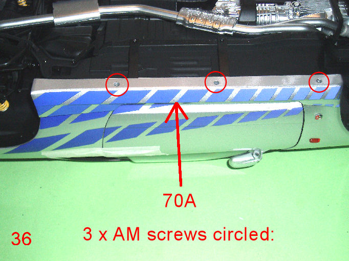

Pic 36: Retrieve the side body trim 70A and fit it in place as shown.

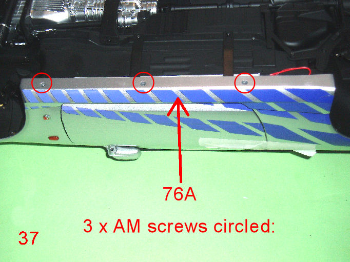

Pic 37: Retrieve the side body trim 76A and fit it in place as shown.

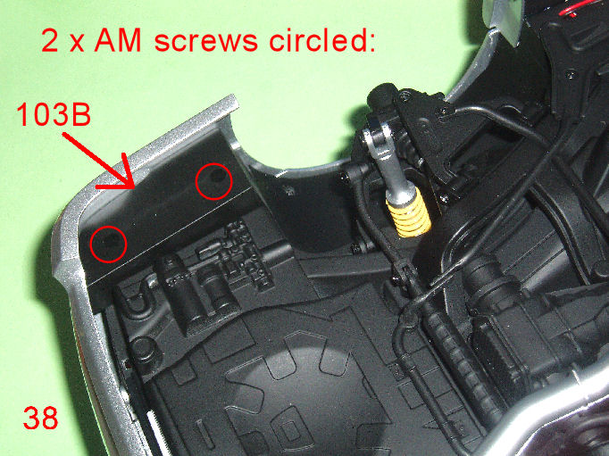

Pic 38: Fit the rear reinforcement 103B as shown and fix with 2 x AM screws.

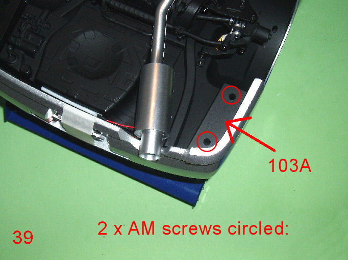

Pic 39: Fit the rear reinforcement 103A as shown and fix with 2 x AM screws.

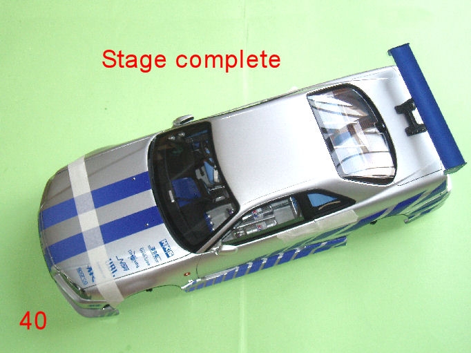

Pic 40: Store the model safely for now.

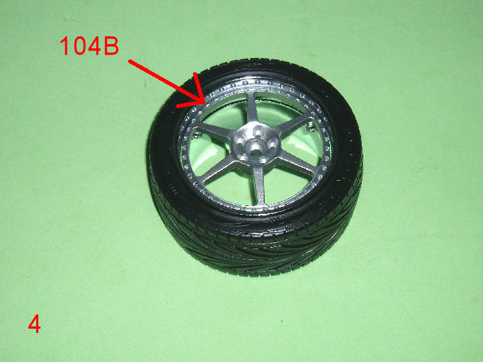

Pic 4: Fit the rim centre 104B to the front of the wheel also checking the screw locations line up.
