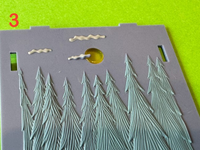

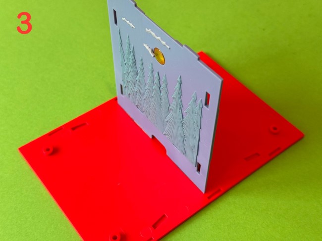

Fit the moon into the hole in the back wall, picture 2. Note: The moon has a flat edge one side and will only fit one way. Picture 3 shows the moon in place.

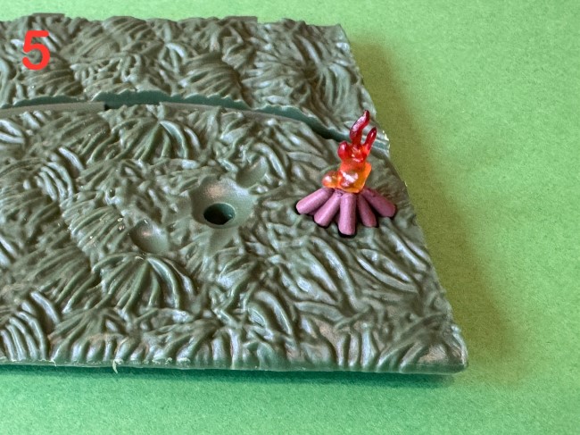

Push fit the camp fire into the grass base as shown in picture 4. Next, place the flames into the camp fire, picture 5. Note: Do NOT glue any of these parts, as these will be removed in the next issue.

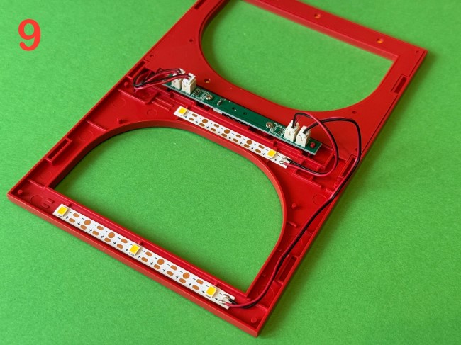

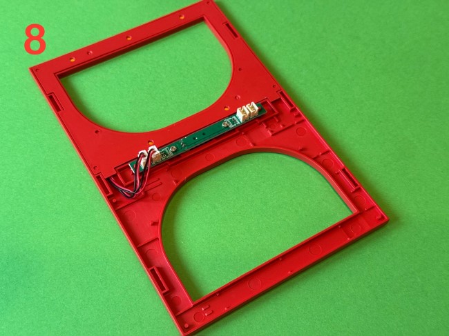

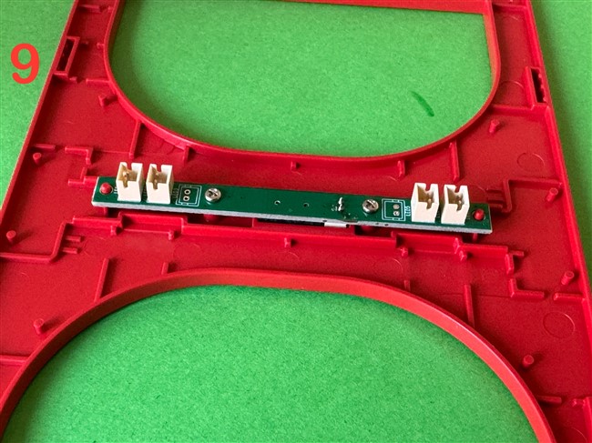

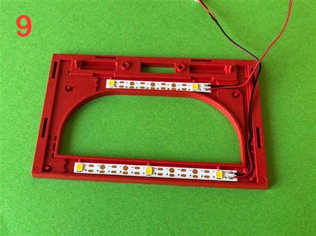

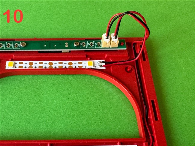

Retrieve the box top assembly from issue 36, picture 8 and add both the LED strips plugging the two sockets into the circuit board, picture 9. You can test the lighting circuit at this stage using the battery box.

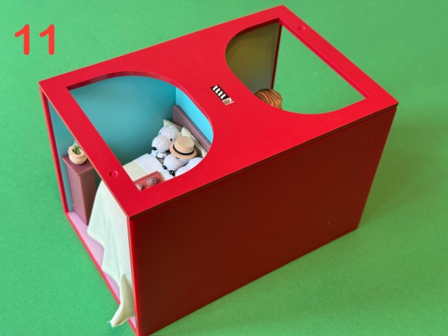

Add the top liner to the box top, picture 10.
Picture 11 shows the completed assembly for this issue.

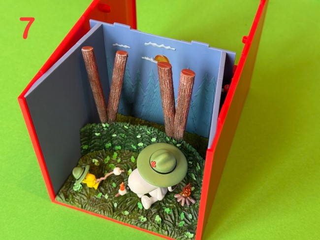

Issue 45
Assembling the Box and moon camp scene.

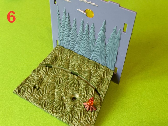

Before we start with this issue, I have painted the base grass and back drop area to give it a little more detail. This is not necessary and only do this if you feel confident in applying paint to the scene.

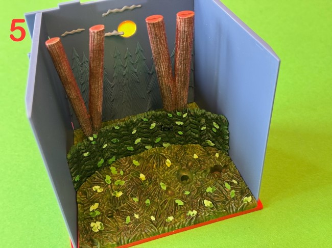

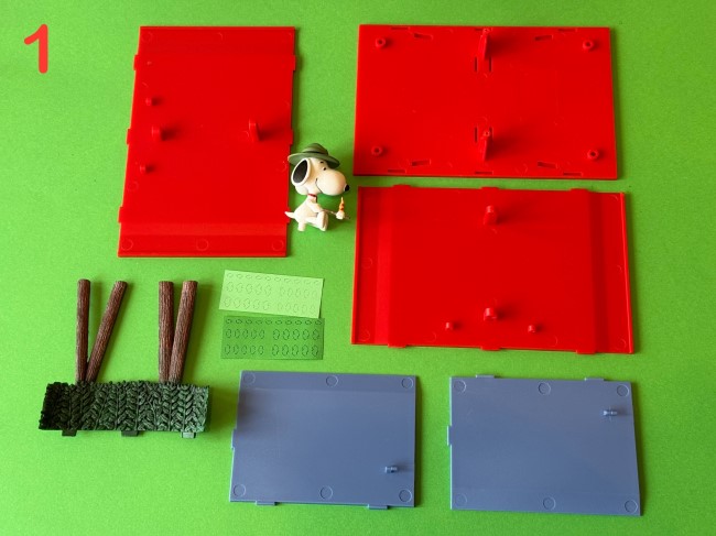

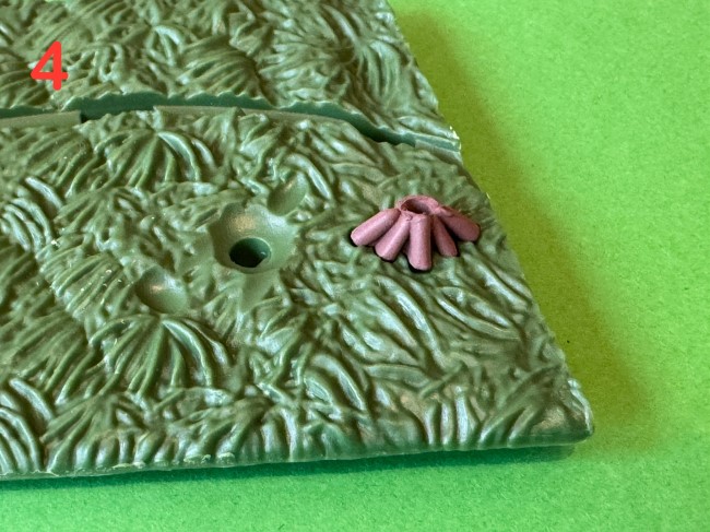

Cut out all the leaves from the two leaf sheets, picture 2. Attach the backdrop to the base and using PVA glue spread the leaves out over the base and the backdrop with the trees.

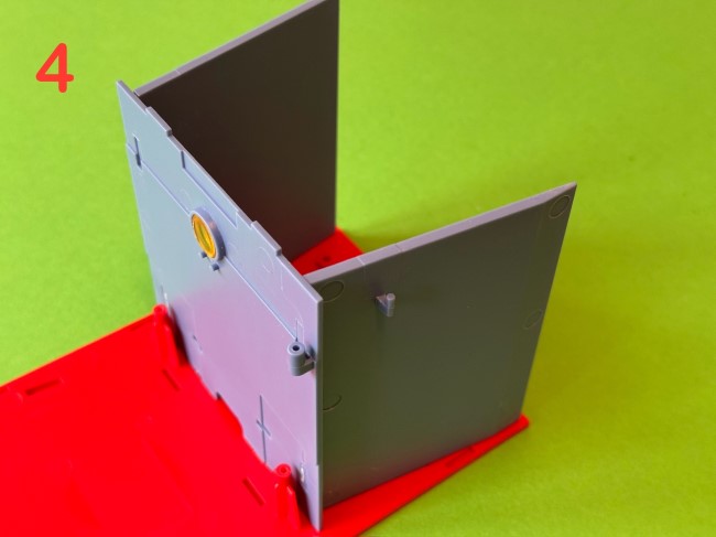

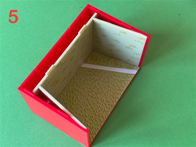

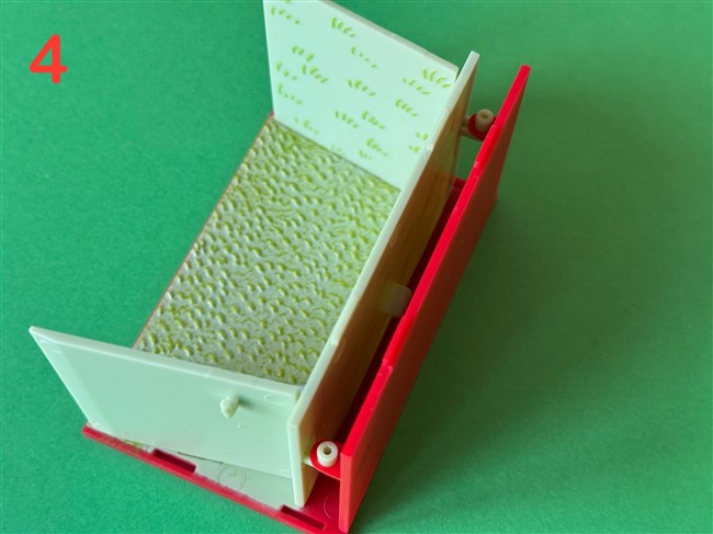

Using quick drying glue, take the back wall from the previous issue and attach it to the base, picture 3. Add the side panel, but DO NOT GLUE these in place, picture 4.

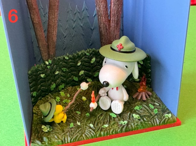

I have placed the grass base and trees in place along with the Woodstock and snoopy figures in the scene, along with the two side panels, pictures 5, 6 and 7. However, you will need to take these apart again in the next issue.

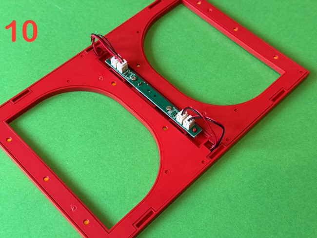

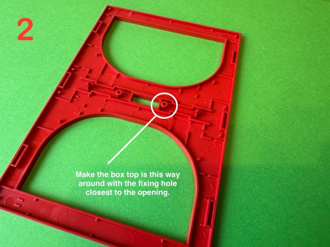

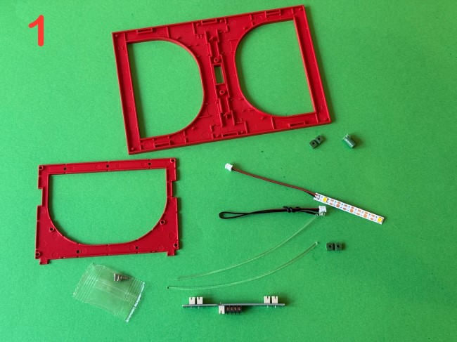

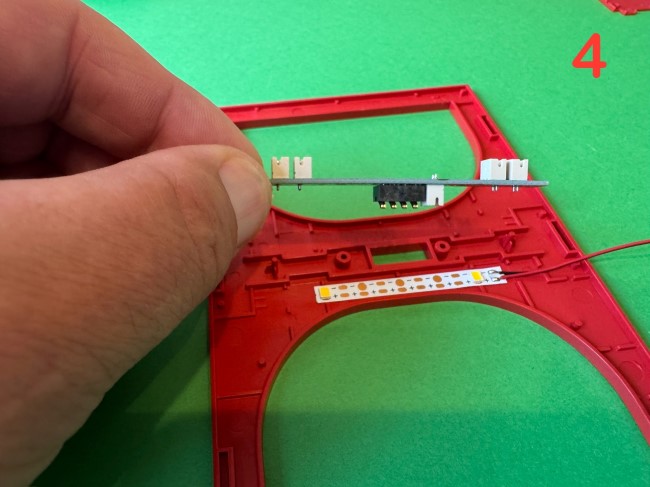

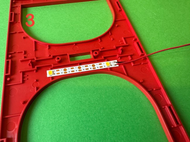

Take the box top and rotate it so the fixing hole closest to the opening is to the right-hand side as illustrated in picture 2. Place the LED strip as shown in picture 3.

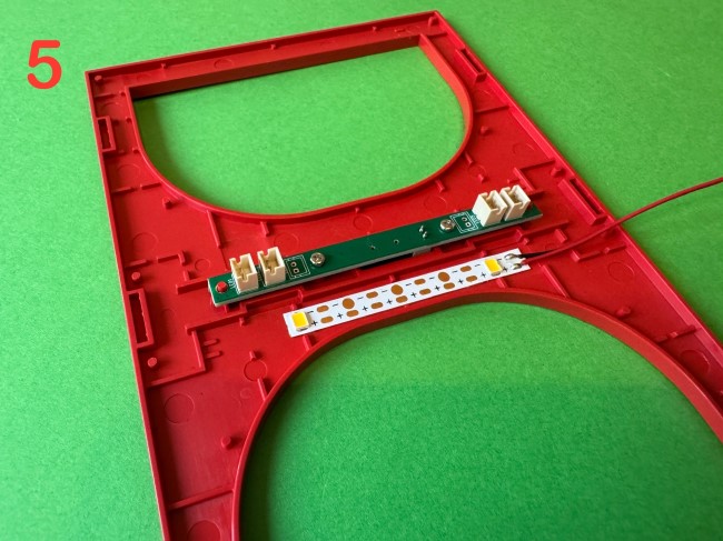

Take the circuit board and place it into the box top making sure you have it the right way around, picture 4. Secure it in place by using two of the screws provided in this issue, picture 5.

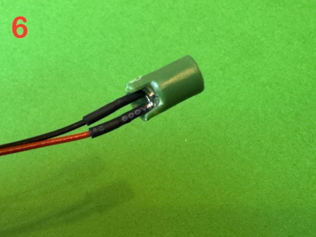

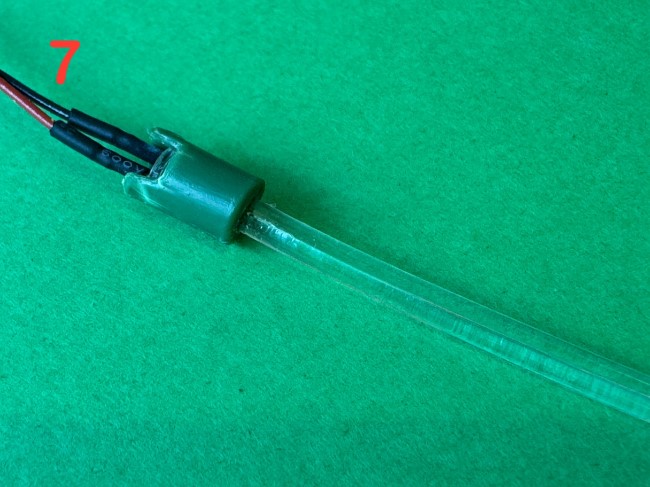

Place the LED bulb and wire into the holder, mounting it as shown in picture 6. You may need a little quick drying glue to hold the bulb in place. Fit the two fiber optic cables into the other end using a little glue to hold them in place, picture 7.

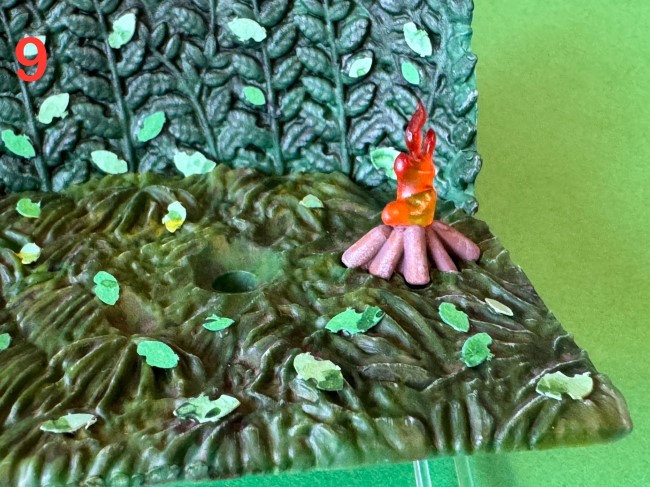

Feed the fiber optic cable from the underside of the grass base where the fire goes and the fit the cable into the bottom of the fire, picture 8.
Glue the fire into position on the grass base, picture 9.

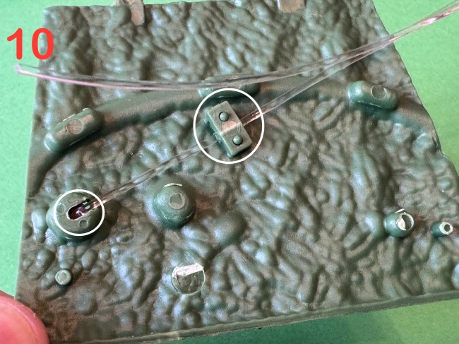

From the bottom of the grass base, feed the cable through the two pins and place the clip to hold it all in place, again use quick drying glue if necessary, picture 10.

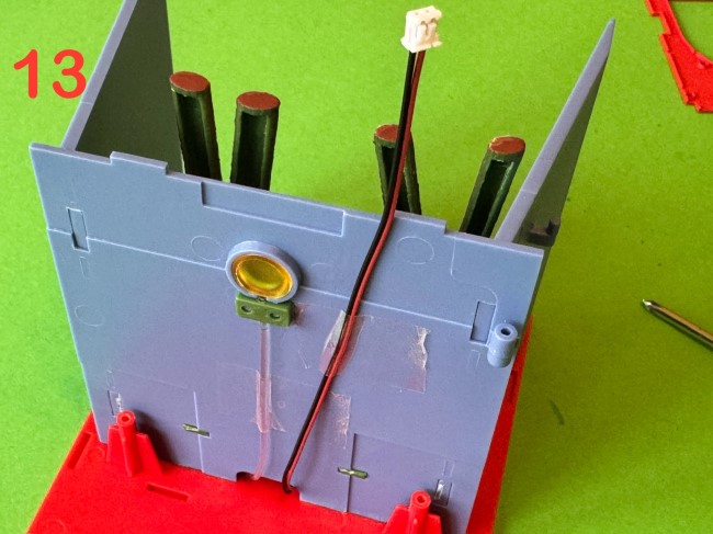

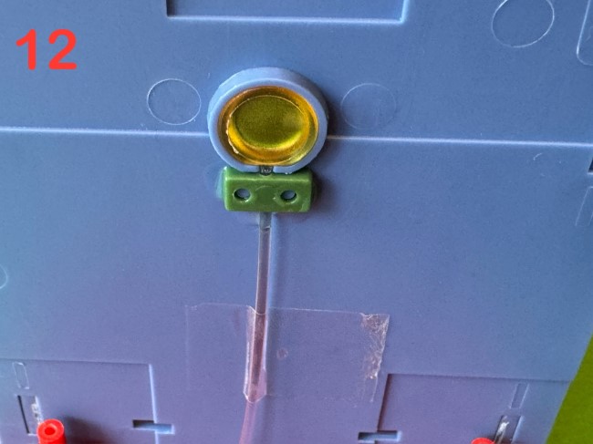

Feed the other fiber optic cable and the wire through the hole in the back wall as shown in picture 11. Feed the fiber optic cable up on the back wall and feed it to the moon. Apply a little quick drying glue. I also held the fiber optic cable in place by using a piece of sticky tape. Place the clip on the two pins to hold it in place, picture 12.
Hold the led wire in place on the back wall with sticky tape as shown in picture 13.

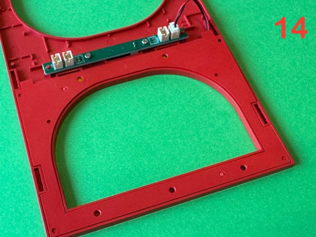

Attach the top liner on the box top, picture 14, then attach the LED cable to the circuit board.

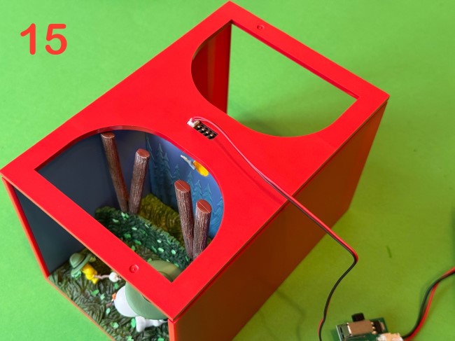

Place the box top, but DO NOT GLUE IN PLACE, over the scene, picture 15.

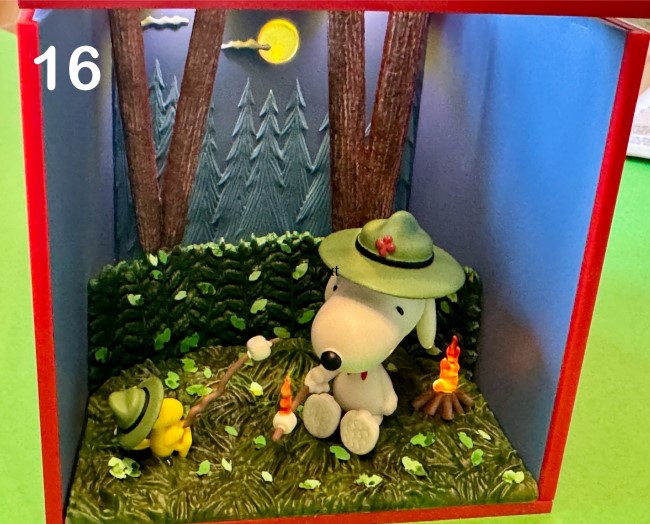

Test the lighting, so the moon and the fire glows, picture 16.

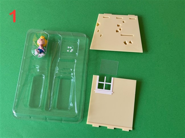

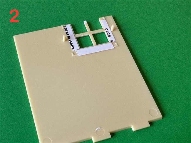

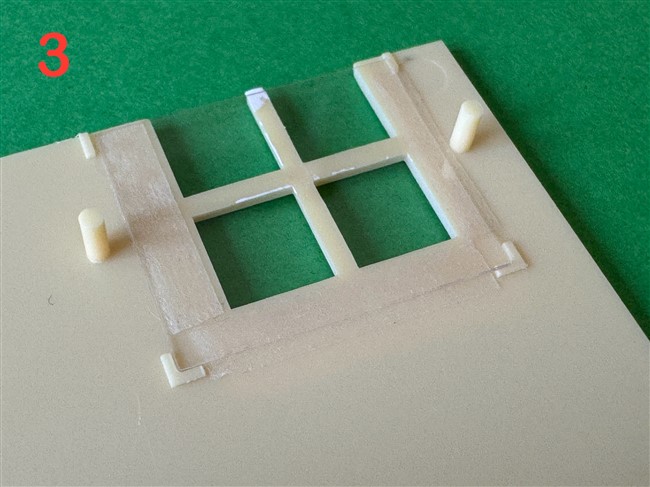

Take the back wall and on the reverse side apply some double-sided tape as shown in picture 2. Remove the backing of the double-sided tape and place the plastic sheet over the tape. There are markings as to where the window is to be placed. Note: The plastic sheet has a protective film on both sides These need to be removed before fixing it to the wall, picture 3.

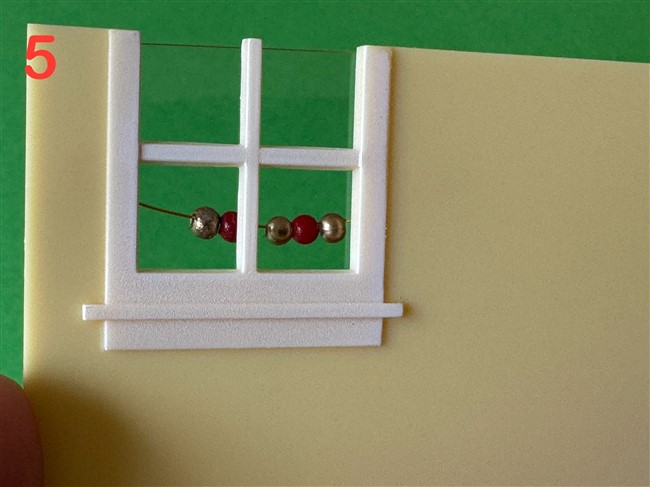

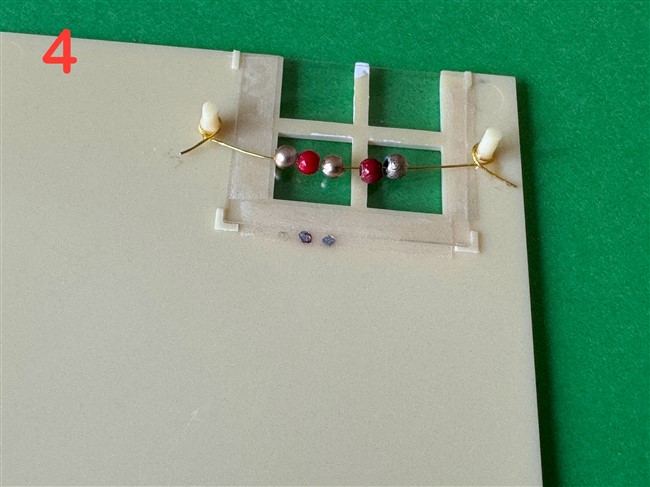

Take the five beads and feed the wire through the holes in them. Note: these can be left as they are or painted different colours. I painted mine red and gold. Thread each end of the wire to the post as shown in picture 4. Picture 5 shows how it looks from the front side.

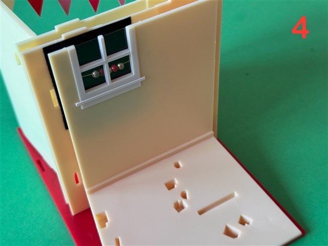

#6 Posted : 27 August 2025 10:24:42
Posts: 7,287
Points: 22,168
Issue 48
Assembling the Christmas Scene

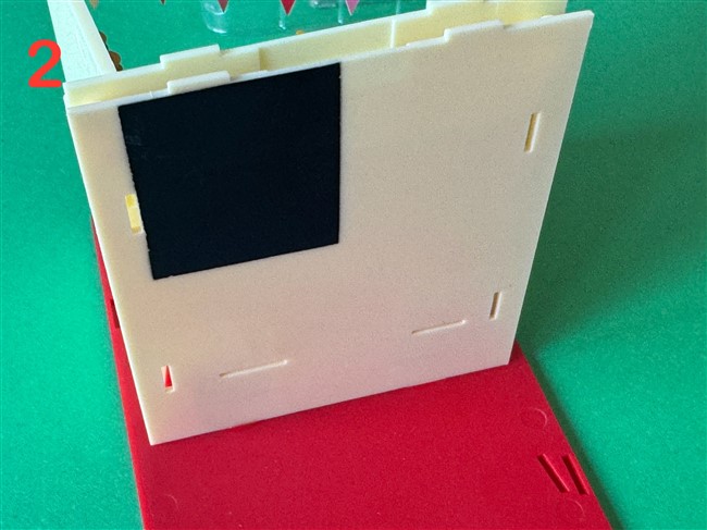

Remove all the floor and back from the Christmas scene you did in the previous issue. Check the orientation of the partition wall, noting that the black rectangle faces the scene. Glue this in place as shown in picture 2. Now glue the floor onto the based, making sure the two tabs secure into the partition wall and that the two holes at the front clip into the posts, picture 3.
Refit the back wall into the floor, picture 4. Attach the two side panels as shown in picture 5, DO NOT GLUE these in place. Note: You will have received a replacement side panel in this pack. If the original side panel does not have a notch cut into the top side, then replace it with the replacement part that does, as shown in picture 6.
Fit the Christmas tree as illustrated in picture 7.

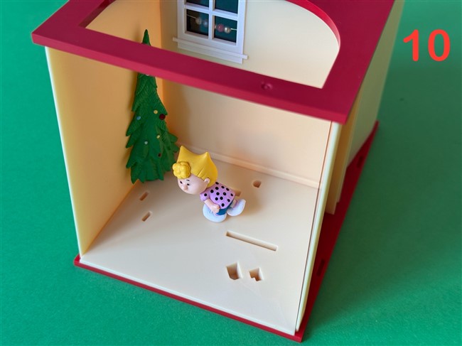

As you have done on previous issues, take the box top, noting its orientation and attach the circuit board using two of the screws supplied, pictures 8 and 9.
Picture 10 shows the assembly for this issue.

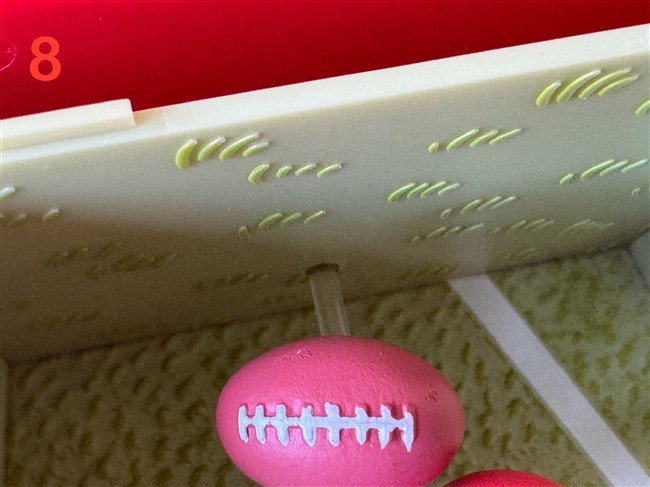

Take the Snoopy figure and the support post and glue it in place as shown in picture 7. Secure the other end of the post to the back wall, picture 8.

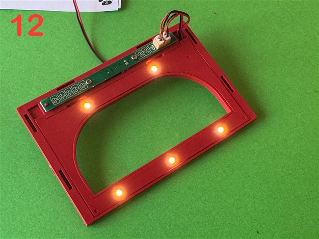

Place the two LED strips into the box top as illustrated in picture 9. Place the circuit board in place using two screws, picture 10. Place the box top liner over the cables as you’ve done in other assemblies, picture 11, along with testing the lighting circuit, picture 12.

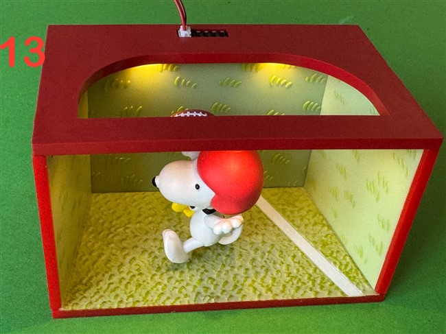

Picture 13 shows the second Premium Figurine complete.
