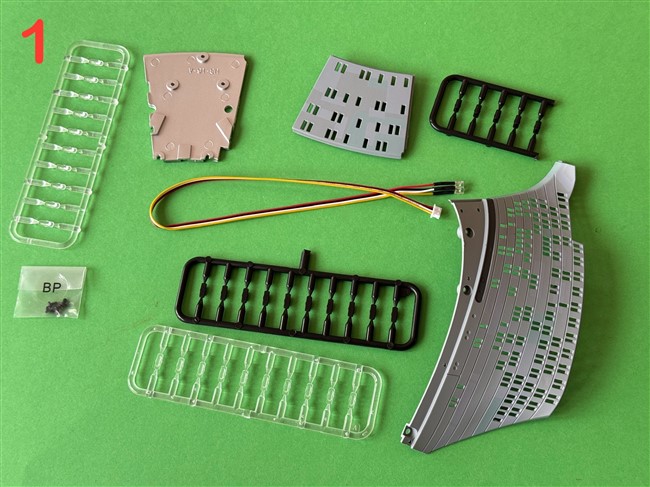

Picture 1 shows the parts for this issue

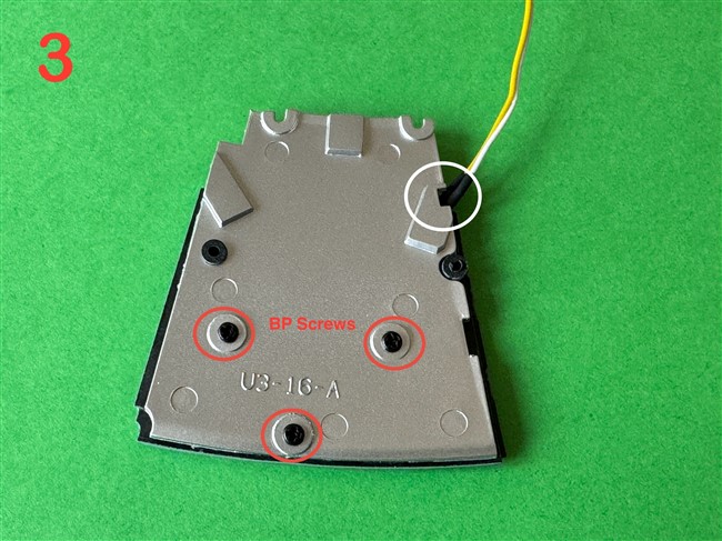

Take the deck panel (30A) and fit clear and dark window pieces as shown in the picture 2. Next, fit the reflector panel (30B) fitting the LED bulb into the reflector side, then secure it using 3 x BP screws, picture 3. Test the lighting using the battery connector as you’ve done before.
