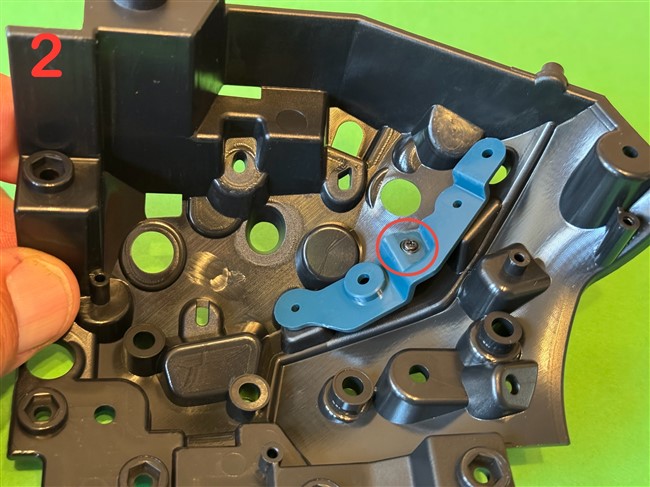

Fit the inner trim bracket inside the left chest frame and secure using an “E” type screw as illustrated in picture 2.

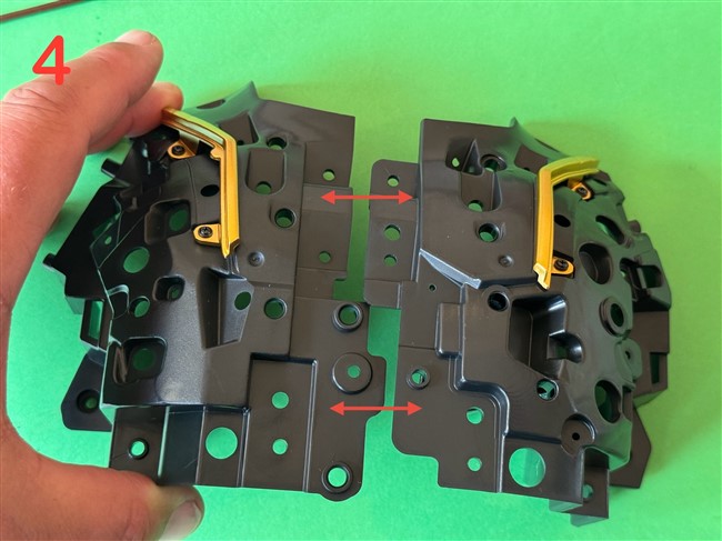

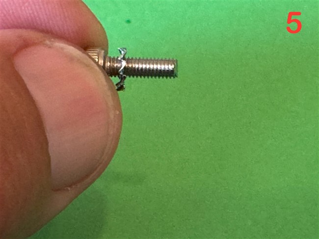

Retrieve the left chest frame and attach the two together, picture 4, using the type “H” bolts. Prepare the bolts by slipping an M3 washer over it, picture 5.
Once the two parts are together, picture 6, place an M3 nut on the inside of the frame as shown in picture 7. Hold this in place and turn the assembly over screwing in the bolt you prepared a moment ago, picture 8.

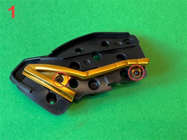

Fit the left breast plate gold trim and push it into position on the left breast plate, securing it using 2 x “E” screws, picture 1.

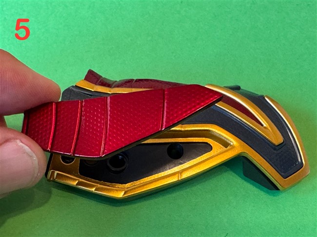

Push fit the breast plate lower red trim in place as shown in picture 2.

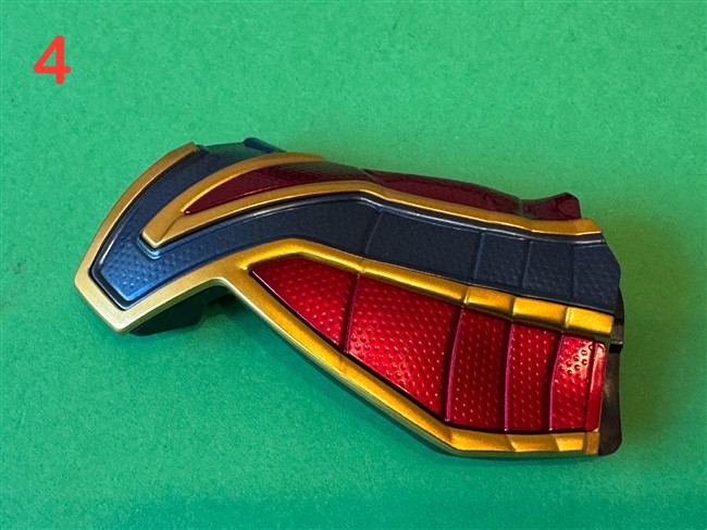

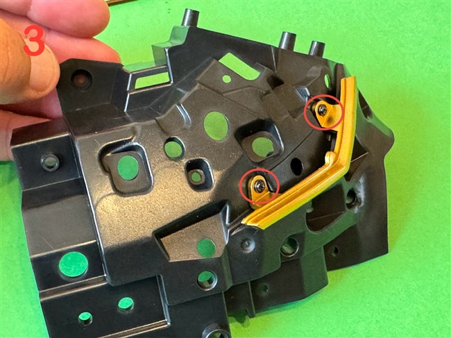

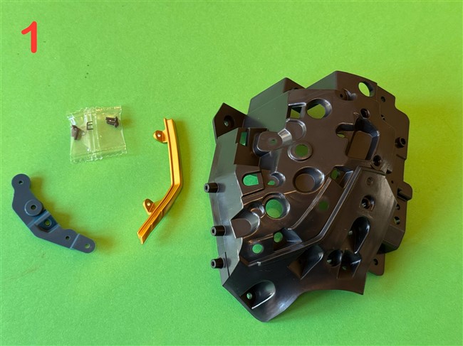

#4 Posted : 10 September 2025 10:23:50
Posts: 7,312
Points: 22,243
Issue 24
The Chest
Retrieve the left breast plate from the previous issue and push the gold trim in place securing it using 2 x “E” screws, picture 2.

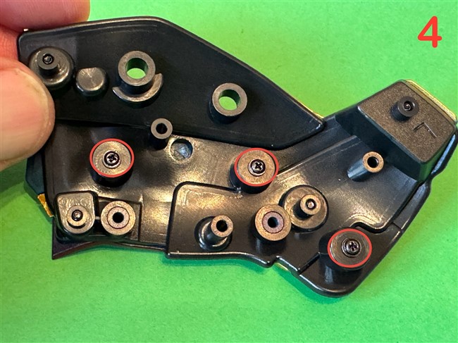

Take the blue centre plate, which has three pins and push it into position, picture 3. Turn the assembly over and secure the pins using 3 x “E” screws, picture 4.
To complete the beast plate push fit the red trim into position as shown in pictures 5 and 6.

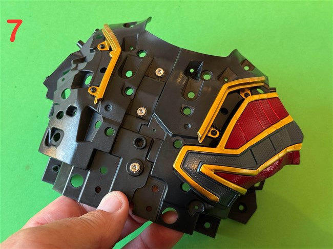

Retrieve the chest frame and attach the breast plate as illustrated in picture 7. Turn the assembly over and secure the breast plate by using 3 x “E” screws as circled in picture 8.

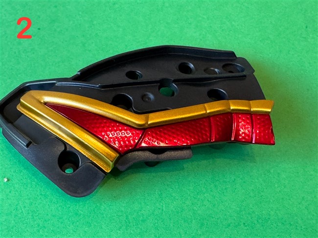

#5 Posted : 11 September 2025 10:22:58
Posts: 7,312
Points: 22,243
Issue 25

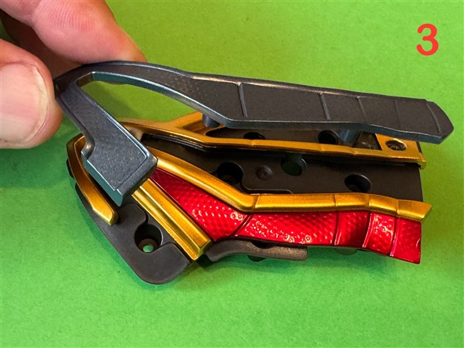

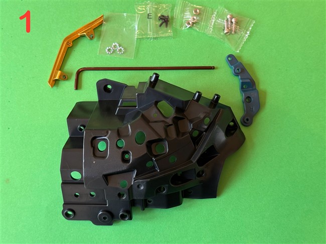

The Chest
Fit the left breast plate gold trim and push it into position on the right breast plate, securing it using 2 x “E” screws, picture 2.
Push fit the breast plate lower red trim in place as shown in picture 3.

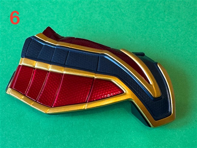

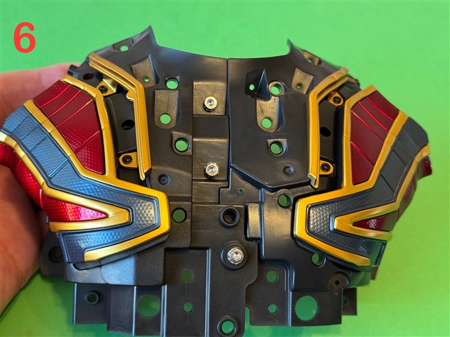

#6 Posted : 11 September 2025 10:24:19
Posts: 7,312
Points: 22,243
Issue 26
The Chest
Retrieve the right breast plate from the previous issue and push the gold trim in place securing it using 2 x “E” screws, picture 2.
Take the blue centre plate, which has three pins and push it into position. Turn the assembly over and secure the pins using 3 x “E” screws, picture 3.
To complete the beast plate push fit the red trim into position as shown in picture 4.

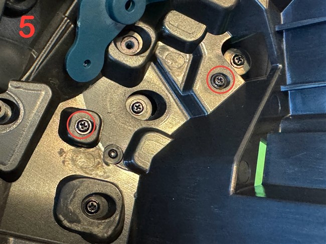

Retrieve the chest frame and attach the breast plate as you did with the previous left breast plate. Turn the assembly over and secure the breast plate by using 2 x “E” screws as circled in picture 5.

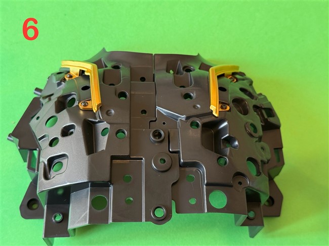

Picture 6 shows the completed assembly for this issue.
