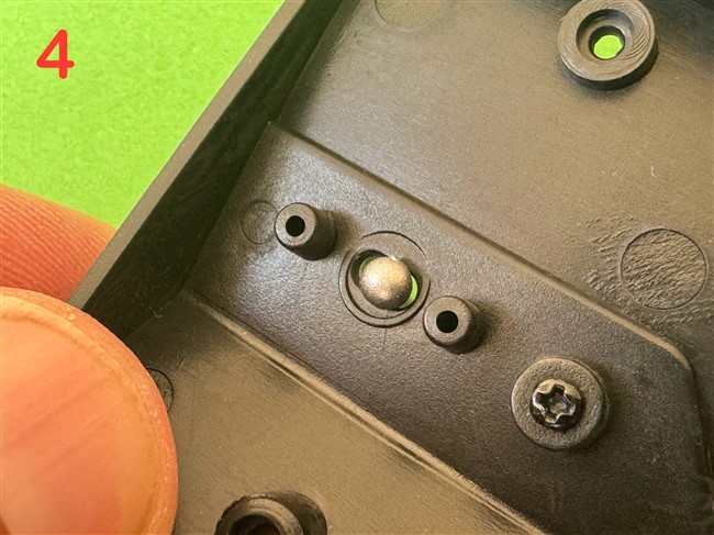

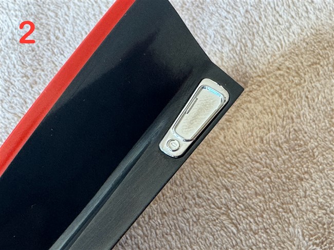

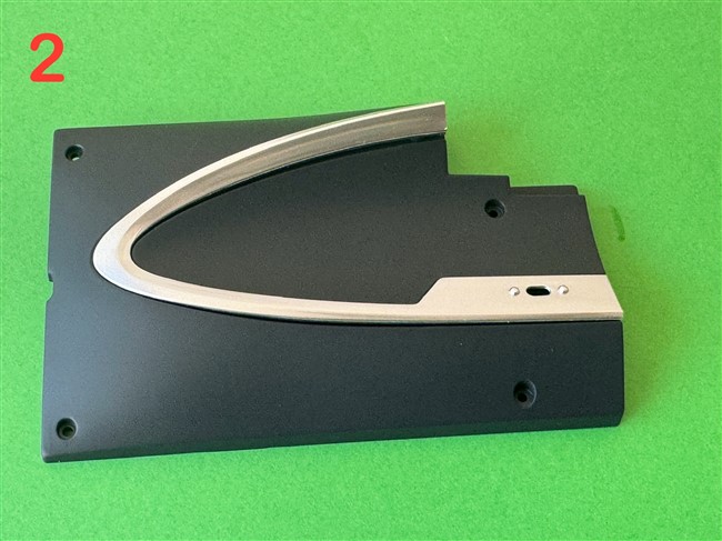

Fitting the Trim and Attaching the Door

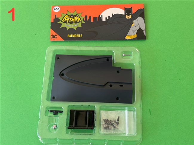

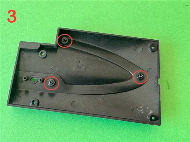

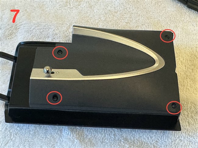

Retrieve the door trim from issue 99 and insert it in the left door inside panel (100A), picture 2. Turn the assembly over and secure it in place using 3 x AP screws, picture 3.

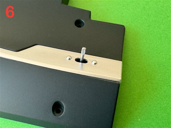

Push the door handle (100B) through the oval shape hole, picture 4. Cover the round part of the door handle with the door handle bracket (100D) securing it in place using 2 x AP screws, picture 5.

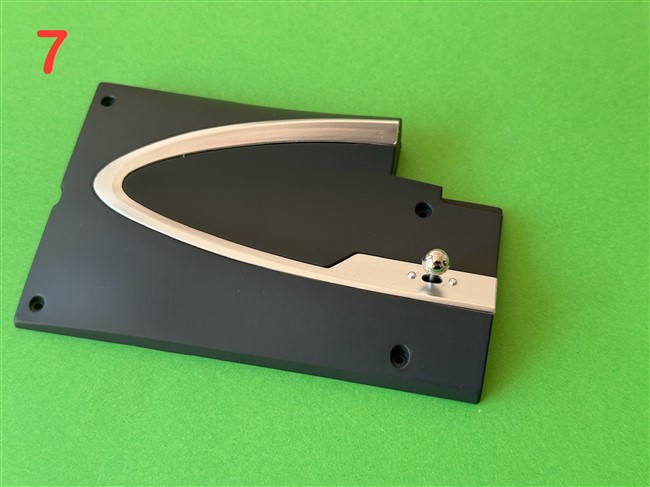

Turn the assembly back over and attach the door handle head (100C), picture 6 and 7.

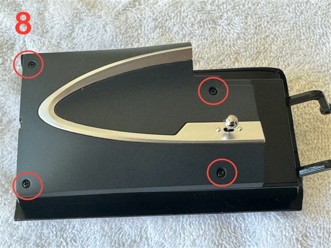

Take the door panel assembly and attach it to the left door using 4 x AP screws, picture 8.

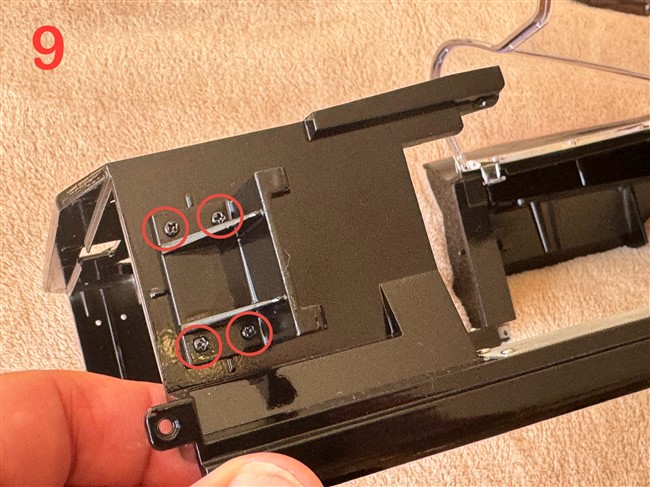

Use 4 x EN screws to attach the door hinge (100E) to the body frame, picture 9.
Finally, attach the door to the hinge using 2 x EM screws.

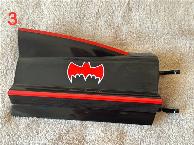

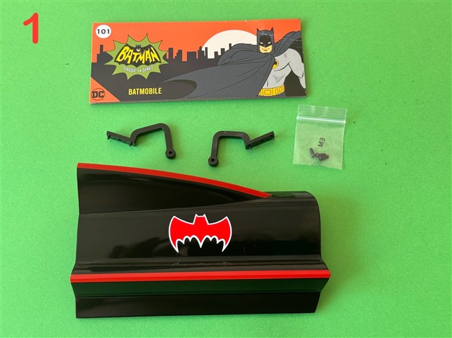

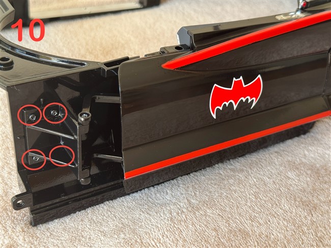

Issue 101
Fitting the Hinges
Fix the two door hinges (101B & 101C) to the door as you did previously, picture 2.
Picture 3 shows the assembly complete for this issue.

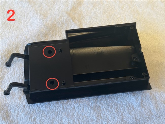

Issue 104
Retrieve the door trim from issue 103 and insert it in the left door inside panel (104A), picture 2. Turn the assembly over and secure it in place using 3 x AP screws, picture 3.
Push the door handle (104B) through the oval shape hole and cover the round part of the door handle with the door handle bracket (104D) securing it in place using 2 x AP screws, picture 4.
Turn the assembly back over and attach the door handle head (104C), picture 5 and 6.
Take the door panel assembly and attach it to the left door using 4 x AP screws, picture 7.

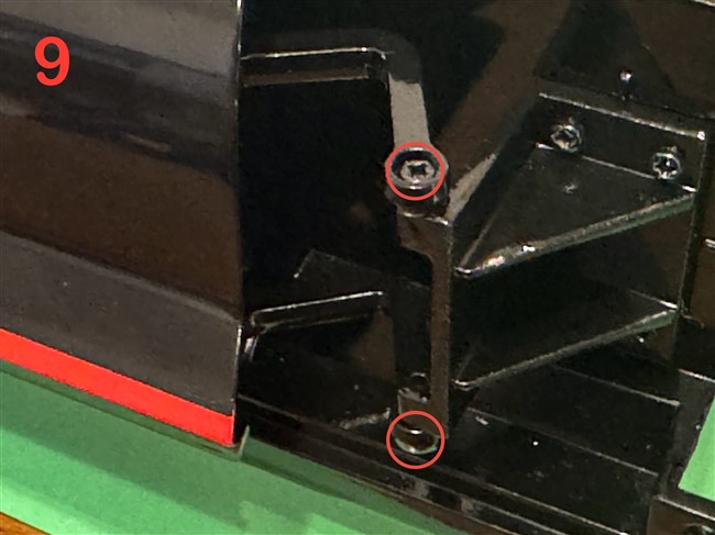

Use 4 x EN screws to attach the door hinge (104E) to the body frame, picture 8.
Finally, attach the door to the hinge using 2 x EM screws, picture 9.

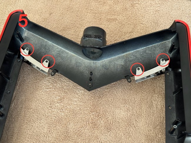

Place the left (105B) and right (105D) lenses onto the rear of the body frame securing them in place using 2 x BM screws for each lens, pictures 4 and 5.
Unplug the two rear turn signals marked “E” and “F” and the rear lights marked “I”, picture 6.

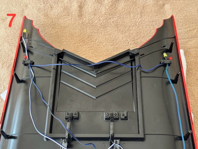

Fix both the cable clips (105E) and feed the cables as shown in picture 7.
Assemble the two body panels together again using the new CM screws provided.
Push the four LED bulbs into the back of the two light housings. Use the black tape provided to stick down the cables as shown in picture 8.
Note: I found that the rear red light LED cables was quite taught when it was in the cable clip, so I re-threaded it, bypassing the clip also shown in picture 8 by the red two arrows.

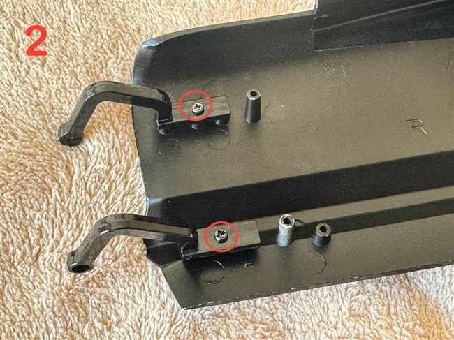

Issue 106

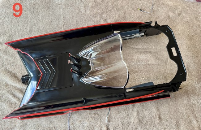

Fitting the Windshield
Retrieve the windshield from issue 4 and secure it to the front body panel (106A) using 4 x AM screws, picture 2.
Picture 3 shows it in place.
The last two pictures, I placed the body panels, bonnet and roll bar onto the chassis to see what it looks like.
