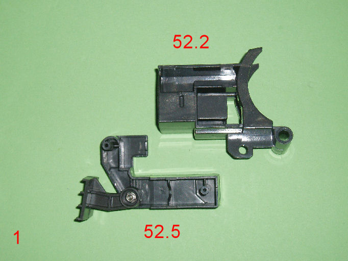

STAGE 53:

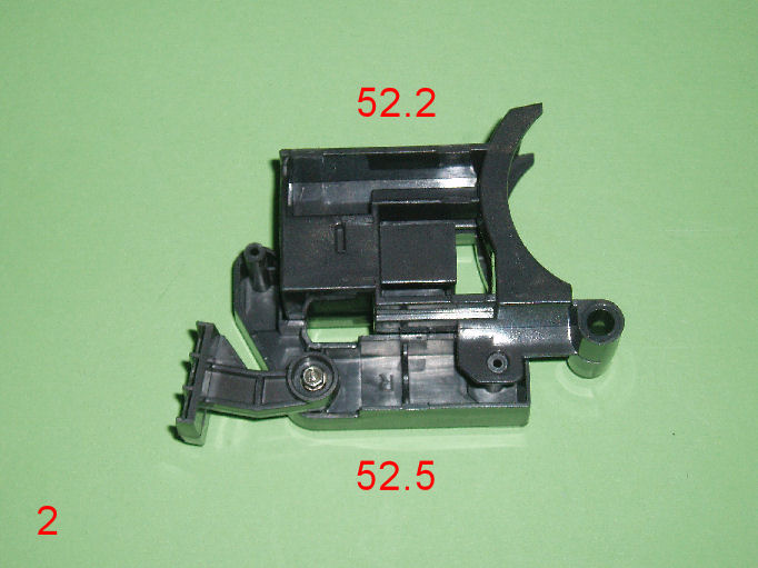

Neck and tail Triceratops Dinozord.
Pic 1: Retrieve the unused parts 52.2 and 52.5 from the previous stage.
Pic 2: Fit the parts together as shown.

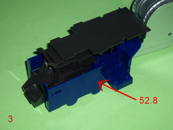

Pic 3: Retrieve the lower body 52.8 and fit it in place as shown.

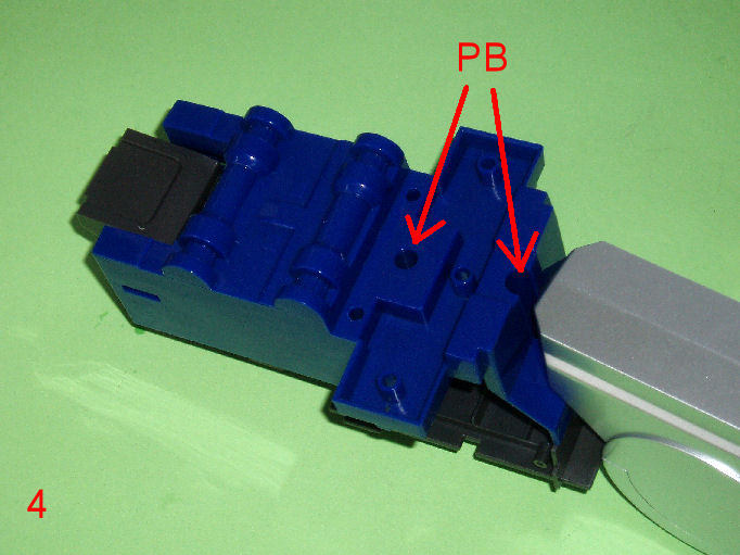

Pic 4: From underneath, fix the parts using 2 x PB screws.

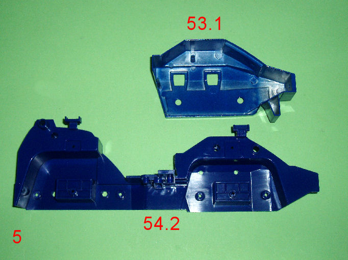

Pic 5: Retrieve the cover 53.1 and locate the undercarriage part 54.2.

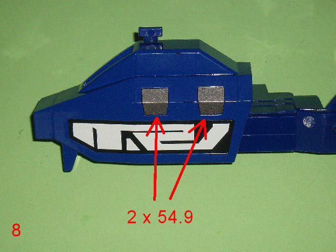

Pic 6: Fit the parts together and fix with 1 x PWM screw.
Pic 7: On the outside, fit the panel 54.8 in place and fix from behind with 2 x PWB screws.

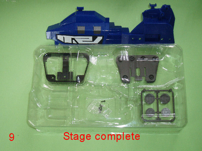

Pic 8: Press-fit the two panels 54.9 in place as shown.
Pic 9: Store the unused parts and spare PB screws for now.

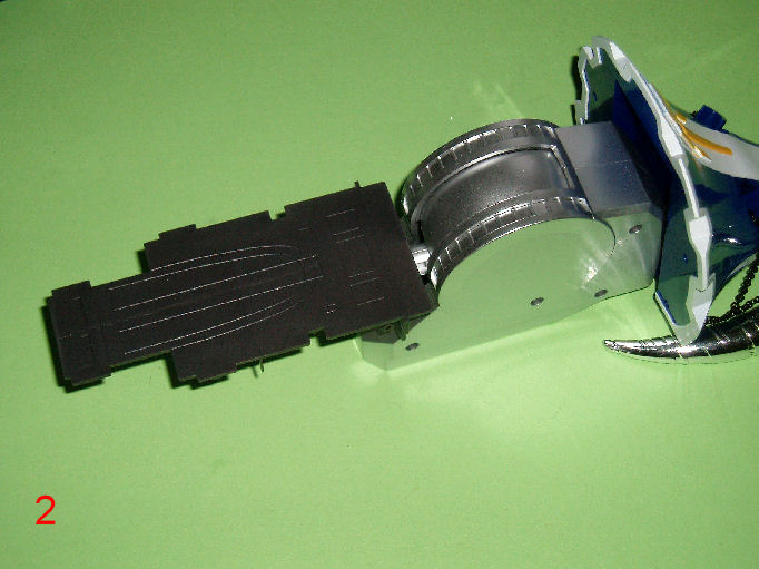

Left front undercarriage 2 Triceratops Dinozord.

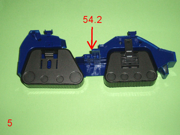

Pic 1: Retrieve the wheel carriage parts 54.3, 54.4 and 54.5 from the previous stage.
Pic 2: Fit part 54.4 into 54.3 as shown.
Pic 3: Fit part 54.5 in place and fix from the other side with 2 x PB screws.

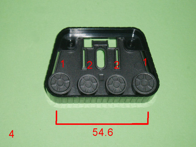

Pic 4: Press-fit the wheels 54.6 into the assembly in the sizes as shown.
The part sizes are marked on the sprue.
Pic 5: Retrieve the main part 54.2 and fit the wheel assembly in place.

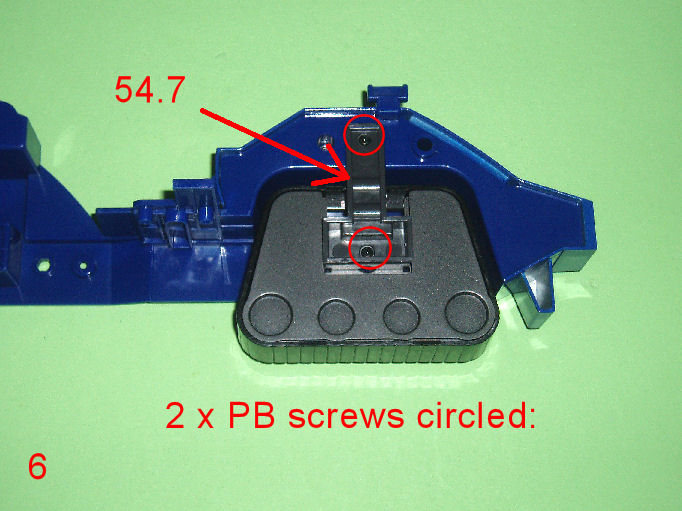

Pic 6: Fix the retaining bracket 54.7 in place using 2 x PB screws.

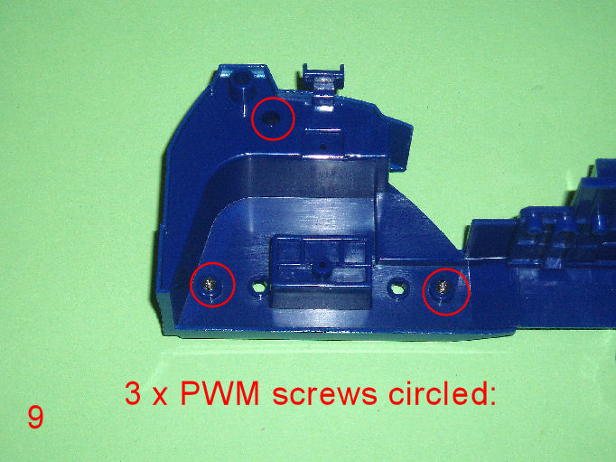

Pic 9: Fix the parts together using 3 x PWM screws on the inside.

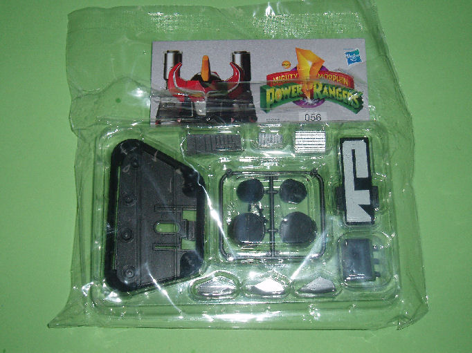

STAGE 56A:
Left front undercarriage 3 Triceratops Dinozord.
Pic 1: Fit the wheel frame parts 56.1 and 56.3 together as shown.
Pic 2: Fit part 56.2 as shown.
Pic 3: Fix the parts together with 2 x PB screws from the other side.
Pic 4: Press-fit the 4 x wheels 56.7 in the order as shown.
The wheel sizes are indicated on the sprue.
Pic 5: Retrieve the assembly 54.2 and fit the wheel frame in place as shown.
Pic 6: Fit the bracket 56.8 and secure with 2 x PB screws.

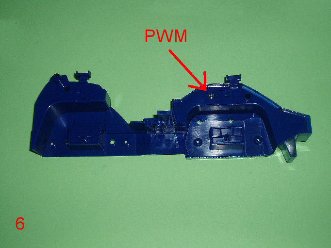

STAGE 57:
Torso 4 Tyrannosaurus Dinozord.

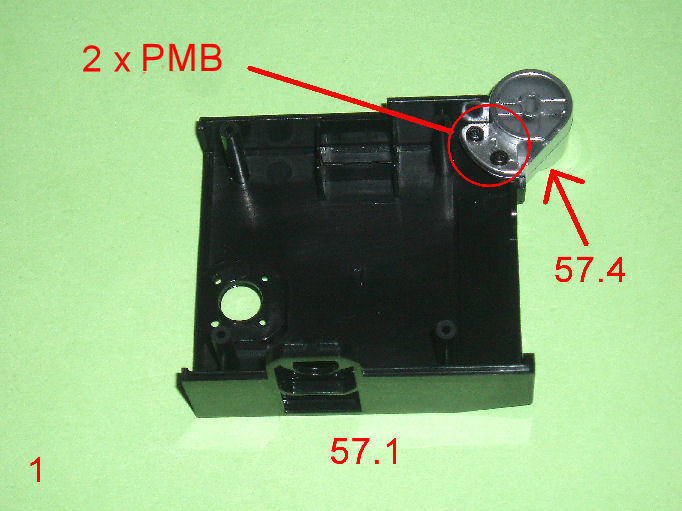

Pic 1: Fit the tail joint 57.4 to the body half 57.1 and fix with 2 x PMB screws.
Pic 2: Fit the metal spindle 57.6 through the hole in 57.1 as shown from underneath and fix using 4 x PMW screws inside.
Pic 3: Shows the spindle fitted from the other side.

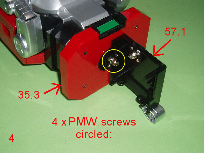

Pic 4: Retrieve the tyrannosaurus assembly and fit the body part 57.1 to the base 35.3.
Fix using 4 x PMW screws.

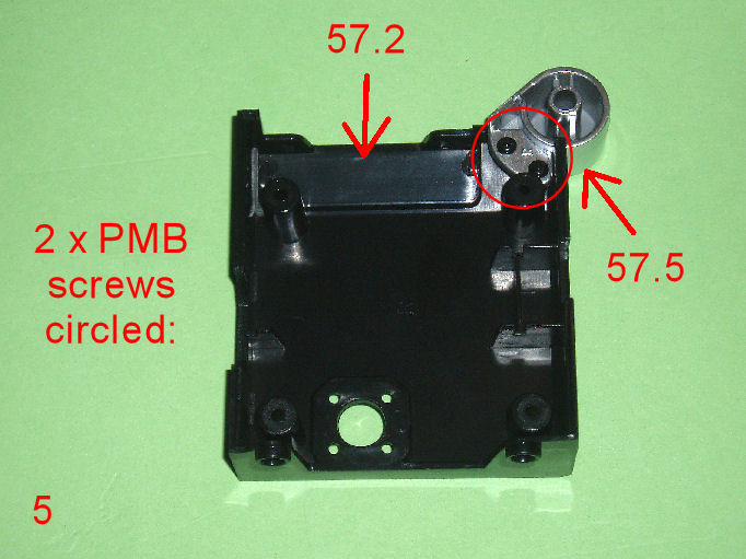

Pic 5: Fit the other tail joint 57.5 to the other half of the body 57.2 and fix with 2 x PMB screws.
Pic 6: Fit the front body panel 57.3 to the side half 57.2 as shown and fix using 2 x PMB screws.

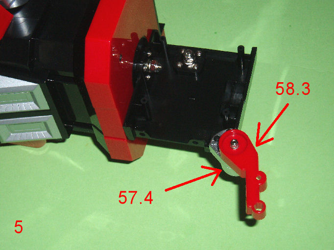

Pic 5: Retrieve the main assembly and fit the tail spindle 58.5 into the hole in part 57.4.

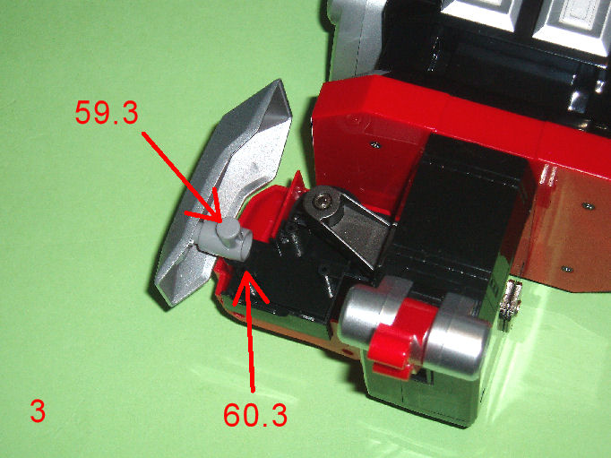

Pic 3: Fit the pin on the joint 59.3 into the hole in the end of 60.3.

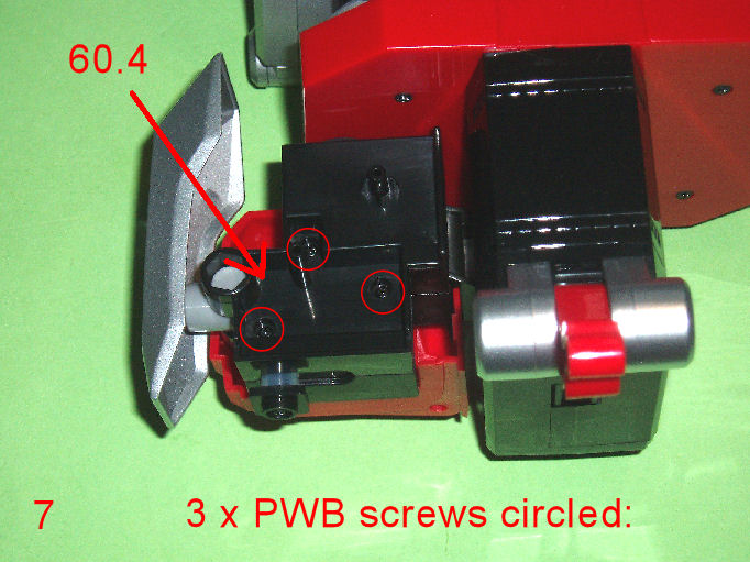

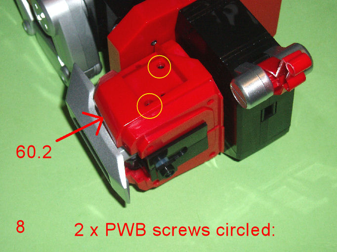

Pic 7: Fit the other hip part 60.4 in place and fix with 3 x PWB screws.
Pic 8: Fit the outer cover and fix with 2 x PWB screws.

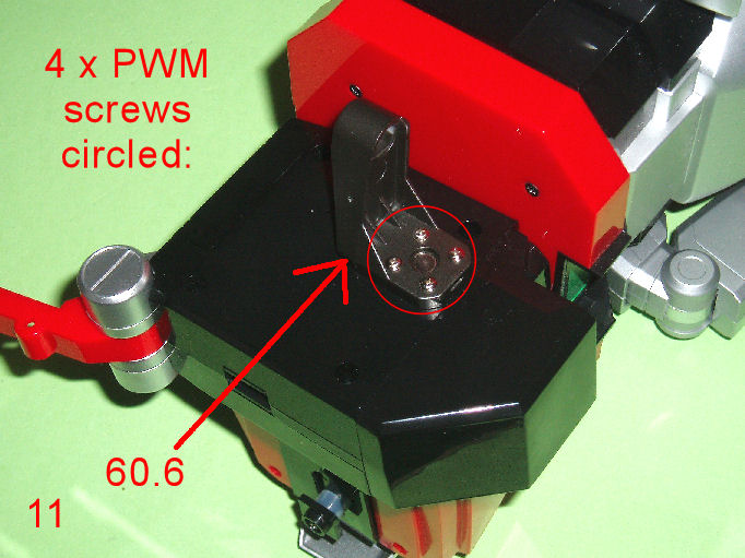

Pic 11: Fit the right hip joint connector 60.6 over the metal plate 58.4 as shown and fix it with 4 x PWM screws.

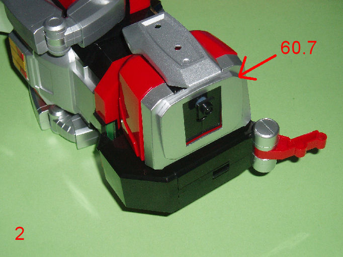

Pic 2: Press the bottom plate 60.7 into place.
It will only fit one way.

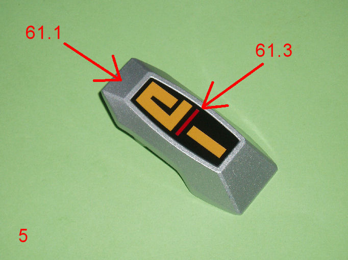

Pic 5: Fit the badge trim 61.3 into the hip joint 61.1.
Make sure it is the right way up.

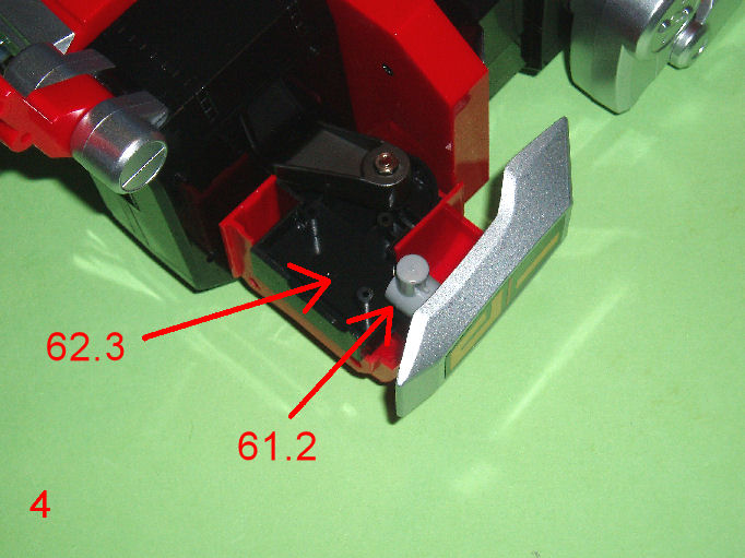

STAGE 62A:

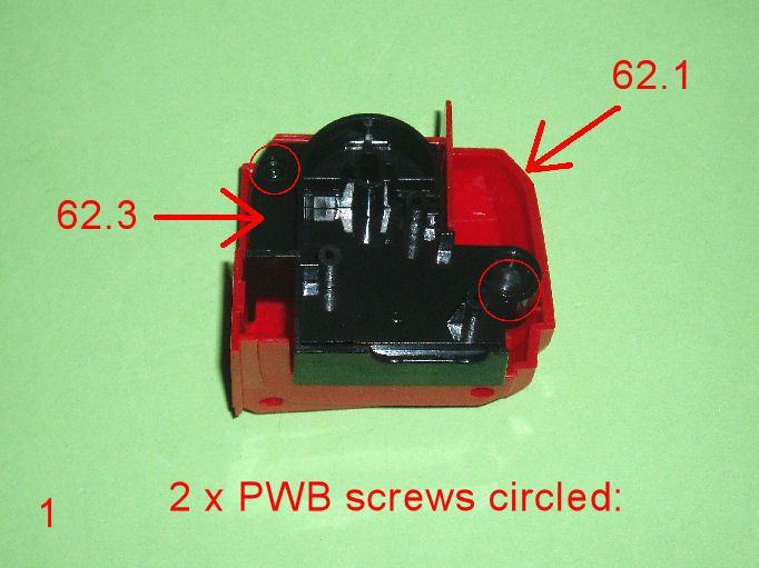

Right hip Tyrannosaurus Dinozord.
Pic 1: Fit the hip parts 62.1 and 62.3 together as shown and fix with 2 x PWB screws.
Pic 2: Retrieve the main assembly.
The spindle on the hip part will locate in the hole on the end of the bracket shown.
Pic 3: Shows the parts fitted together.
Pic 4: Turn the assembly over and fit the hip joint plate as shown with 61.2 fitting in the hole in 62.3.

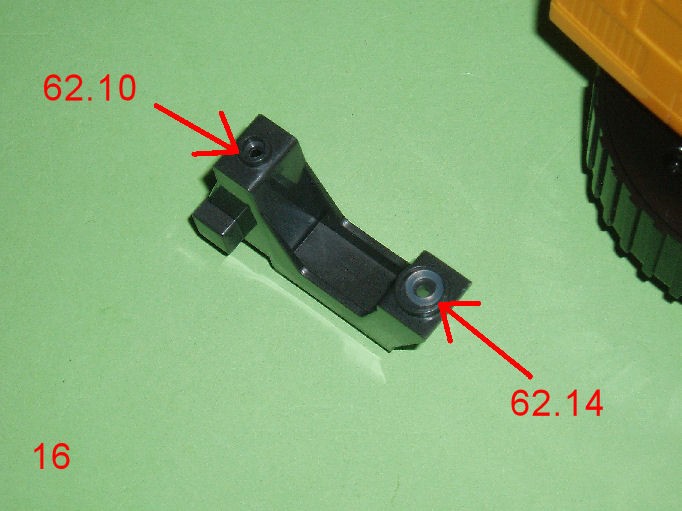

Pic 16: Fit the rubber washer into the lower body 62.10 as shown.
Pic 17: Slide the long post on the upper body through the hole in the neck joint, then fit the lower body in place.
Fix the parts together with 2 x PWB screws.

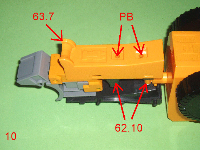

Pic 10: Retrieve the main assembly and fit the body parts in place as shown.
Fix the parts with 2 x PB screws through the holes in 63.7, into the locations in the support 62.10.
