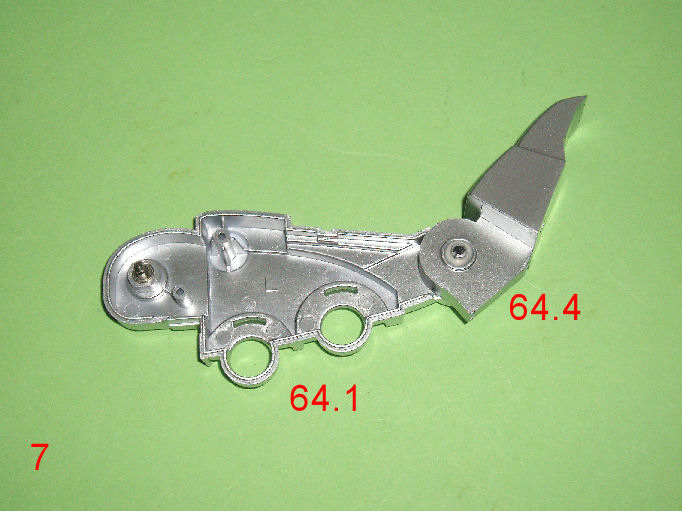

STAGE 64:
Legs 1 Sabretooth Tiger.

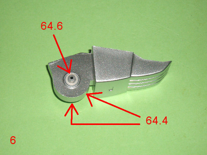

Pic 1: Locate the foot parts 64.3, 64.4 and 64.5.
Pic 2: Fit 64.4 inside 64.3 as shown.
Pic 3: Fit the top part 64.5 in place and fix with 1 x PWB screw.
Pic 4: Locate the leg part 64.1 and the spindle 64.7.
The thicker end of the spindle will fit in the hole indicated.
Pic 5: Shows the parts assembled.
Pic 6: Retrieve the foot assembly and fit 1 x rubber washer 64.7 on each side of the location indicated.
Pic 7: Fit the foot assembly into the leg 64.1 in the direction shown.
Pic 8: From the other side, fix the parts with 1 x PWB screw.
Pic 9: Turn the assembly over and fit the other leg part 64.2 and fix with 1 x PB screw and 1 x PWB screw as shown.
Store safely for now.

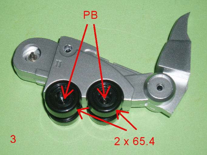

Pic 3: Turn the assembly over and fit the other two wheel parts 65.4 and fix through the middle of each with 1 x PB screw.
Pic 4: Press-fit the two thinner hubs 65.5 in place.

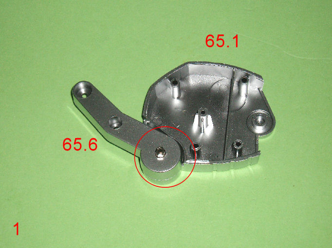

Pic 1: Retrieve the parts 65.1 and 65.6 from stage 65 and fit them together as shown.
The metal spindle 65.6 will fit in the slot in 65.1.

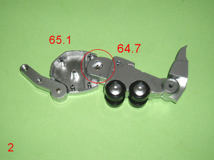

Pic 2: Fit the hind leg assembly to 65.1 as shown.
The metal spindle 64.7will fit in the hole in 65.1.

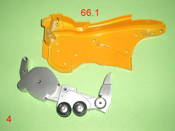

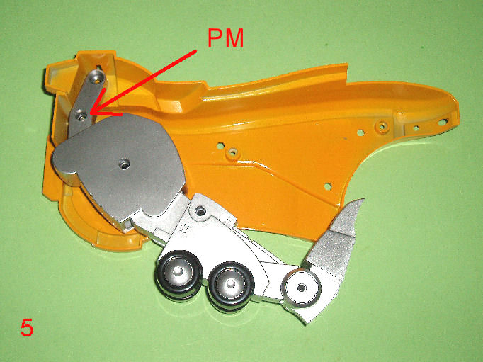

Pic 4: Locate the yellow body panel 66.1 to fit the leg assembly.
Pic 5: Fit the parts together as shown and fix with 1 x PM screw in the top left of the assembly.

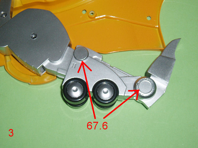

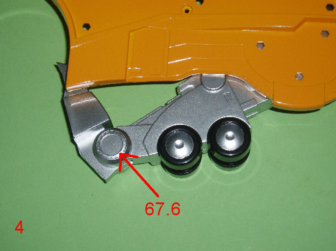

Pic 4: On the other side press-fit the cover plate 67.6 in place as shown.
Pic 5: Retrieve the assembly from the previous stage and fit it to the Dinozord as shown.

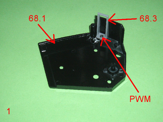

Front right leg Mastodon 2.
Pic 1: Fit the connecting bracket 68.3 to the front leg plate 68.1 and fix with 1 x PWM screw.

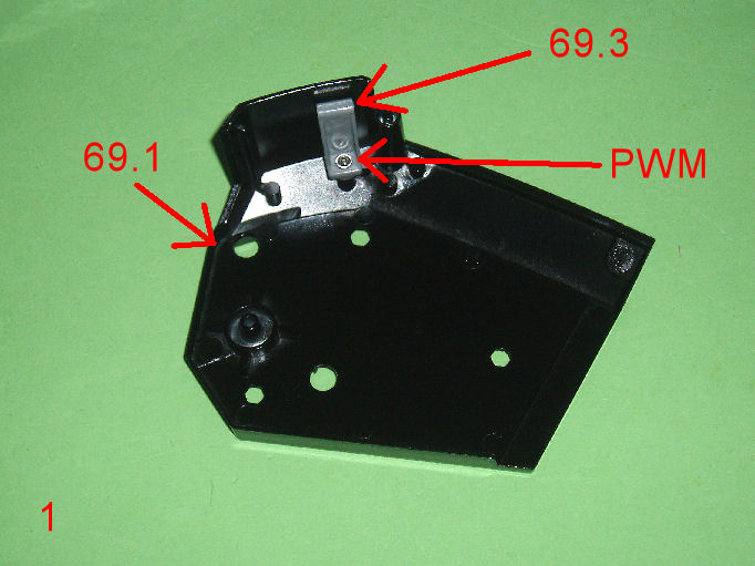

Front right leg Mastodon 3.

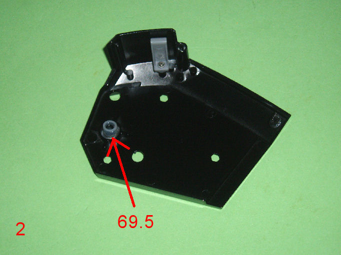

Pic 1: Fit the connecting bracket 69.3 to the front leg plate 69.1 and fix with 1 x PWM screw.
Pic 2: Fit the rubber sleeve 69.5 to the plate as shown.
Pic 3: Fit the inner cover 69.2 to the plate and fix with 1 x PM screw.
Pic 4: Fit the joint housing 69.4 as shown and fix with 3 x PWB screws.
Pic 5: Store the parts safely.

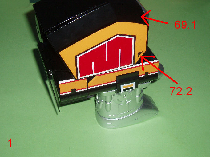

STAGE 72A:
Body 1 Mastodon.
Pic 1: Retrieve the assembly from stage 71 and fit the cover panel 72.2 to the side of 69.1.
Pic 2: Fit the cover panel 72.1 to the side of 68.1.

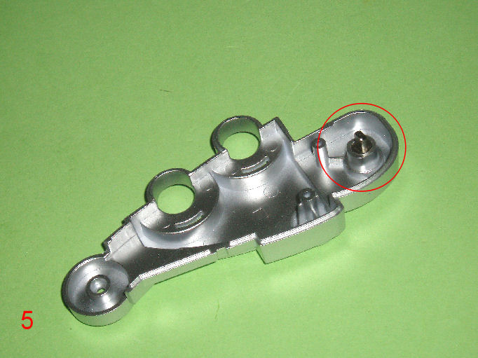

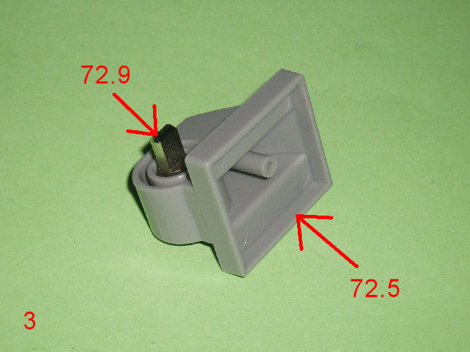

Pic 3: Fit the thicker end of the spindle 72.9 into the side of the hinge 72.5 as shown.
Pic 4: Locate the cover panel 72.3.
The previous assembly will fit into this part.
Pic 5: Shows the parts fitted together.

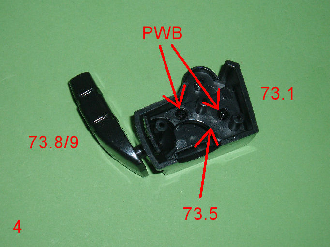

Pic 1: Locate the thumb parts 73.8 and 73.9.
Pic 2: Fit them together as shown.
Pic 3: Locate the other hand parts 73.1 and 73.5.
Pic 4: Fit the thumb assembly 73.8/9 into the hand part 73.1 and fix it in place with part 73.5.
Secure with 2 x PWB screws.

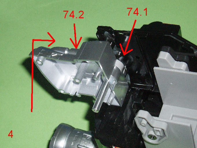

STAGE 74A:
Mastodon rear right leg 1.
Pic 1: Retrieve the Mastodon leg assembly and tilt the main body upwards to give access to the inner rear.
Fit the outer cover 74.1 over the inner bracket 72.7 and fix using 1 x KB screw.
Pic 2: Locate the hind leg parts 74.2, 74.6, 74.9 and 74.10.
Fit the rubber sleeve 74.9 over the shaft 74.10.
Pic 3: Pass the shaft 74.18 through the panel 74.2 from the inside so the rubber sleeve 74.9 locates in the recess.
Fit part 74.6 to the other side of the shaft and panel.
Pic 4: tilt the assembly up and fit to the rear panel so that the shaft 74.10 locates in the hole in 74.1.
Pic 5: Shows a different view of the assembly.

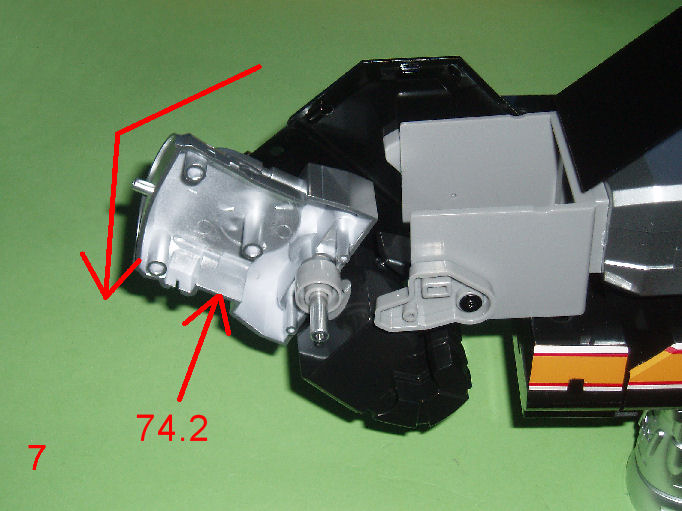

Pic 6: Fit the hand assembly over the shaft as shown.
Pic 7: Rotate part 72.2 downwards as shown.
#14 Posted : 27 September 2025 11:46:56
Posts: 5,829
Points: 17,639
STAGE 74B:
Pic 8: Keep rotating 72.2 as far as possible and then rotate the hand upwards.

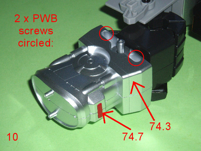

Pic 10: Fit the small red trim 74.7 in place on the leg and fit the other leg panel 74.3 in place.
Fix using 2 x PWB screws.
