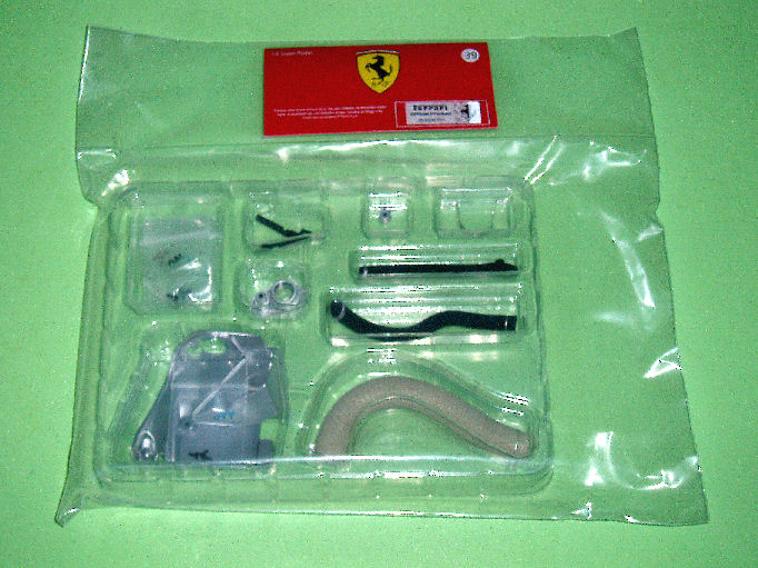

STAGE 39A:

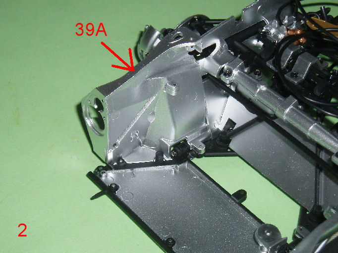

Radiator right wall.

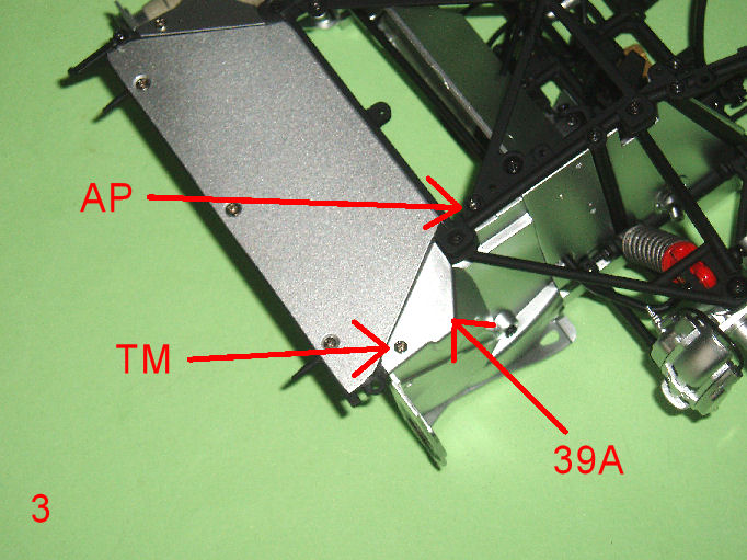

Pic 1: Fit the connector 39B to the panel 39A as shown and fix from behind with 1 x AP screw.
Pic 2: Fit the panel in place on the front frame as shown.
Pic 3: From underneath, fix the panel using 1 x TM screw and 1 x AP screw.
Pic 4: Fit the air duct 39D in place as shown.
Pic 5: Press the front clip 39C in place to hold the air duct.
Pic 6: Fit the bracket 39E over the air duct and fix it using 2 x AAP screws.

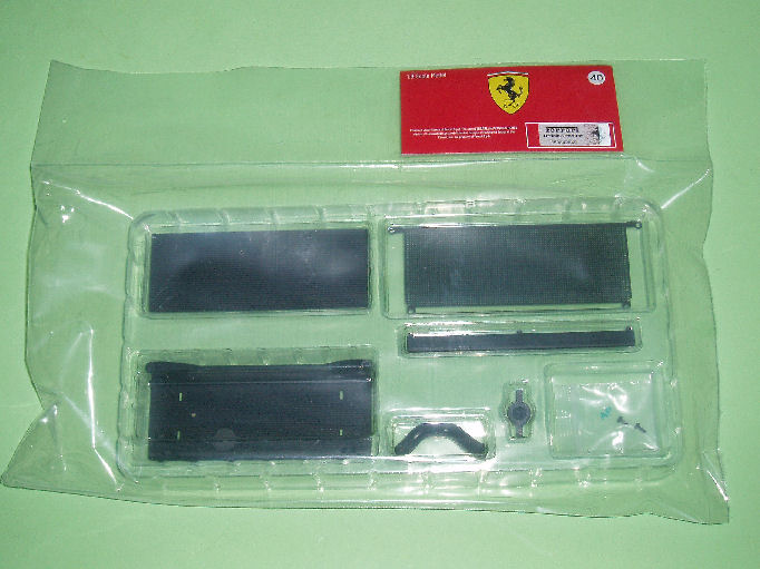

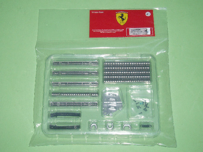

STAGE 40:
Radiator.
Pic 1: Attach the fitting 40F to the radiator 40A as shown and fix from behind with 1 x AP screw.

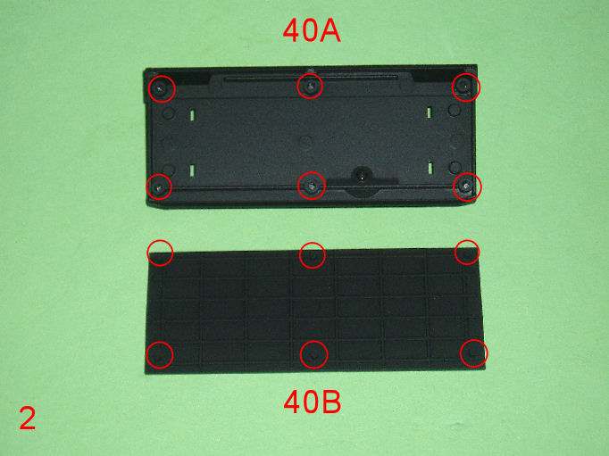

Make sure the flat part of the pin on the front is upwards.

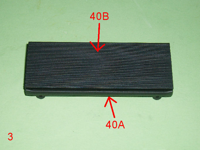

Pic 2: Locate the other part of the radiator 40B.
The holes and pins shown on the parts will press-fit together.
Pic 3: Shows the parts assembled.
Pic 4: Press-fit the top rail 40D in place on the radiator upper edge on 40A.
There are slots and tabs where indicated that will fit together.
Make sure the front curved edge of 40D is facing the radiator body.

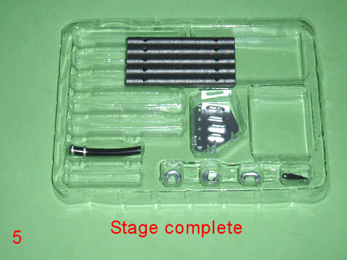

Pic 5: Store all parts safely for now.

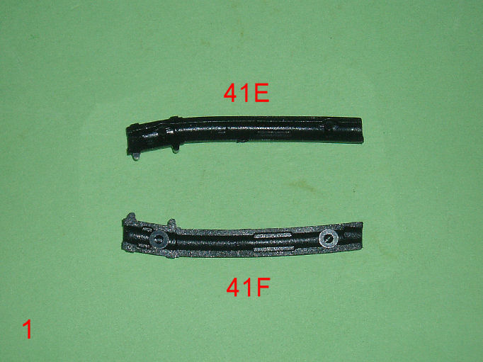

Pic 1: Locate the pipe parts 41E and 41F.

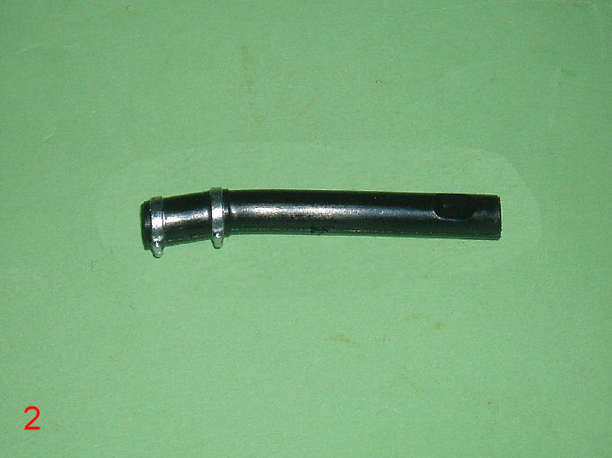

The parts will press-fit together.
Pic 2: Shows the pipe assembled.

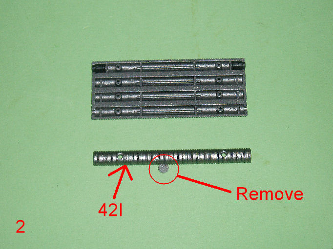

STAGE 42A:
Radiator body 2.

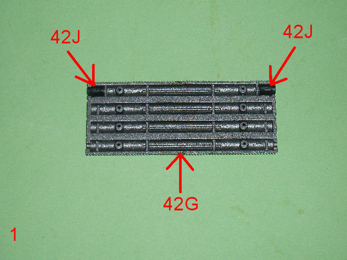

Pic 1: Fit the 2 x screw mounts 42J into the top of the radiator body 42G.
They will only fit one way.
Pic 2: Locate the pipe-half 42I and remove the identification tab indicated.
Pic 3: Fit 42I in place as shown over the 2 x 42J and fix with 2 x KP screws.
Pic 4: Fit the other 3 x pipe halves and fix with 2 x KP screws in each.
Pic 5: Press-fit the end plate 42A in place as shown.

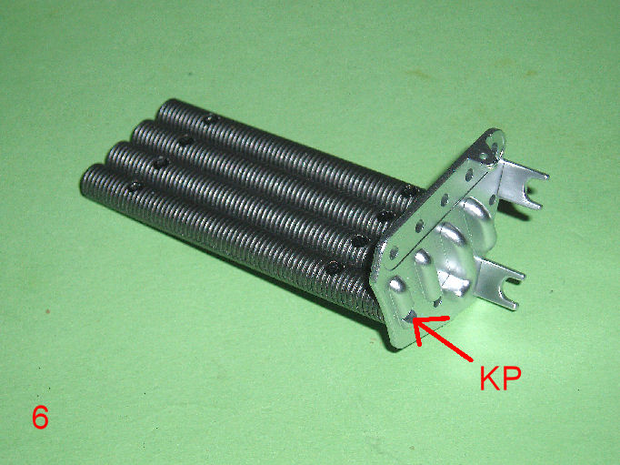

Pic 6: Fix from the outside left end with 1 x KP screw.

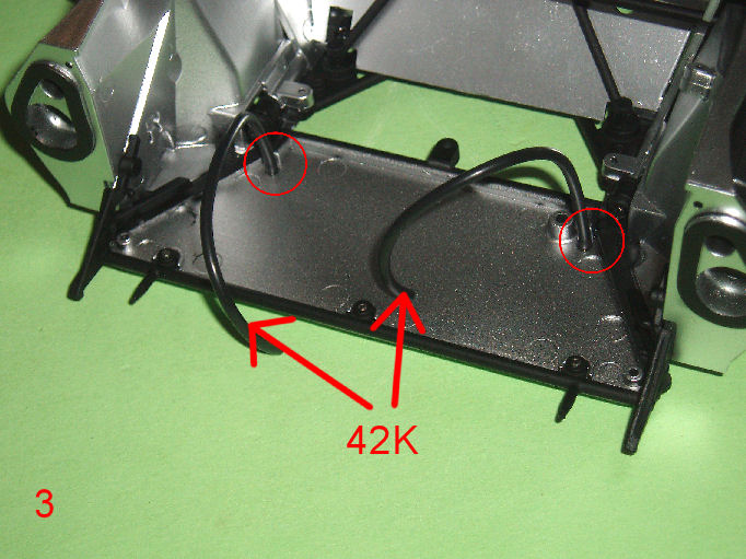

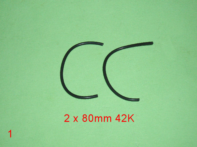

Pic 1: Cut 2 x 80mm pieces of tube from 42K.
Pic 2: Retrieve the front assembly and remove the horn 30B.
Pic 3: Fit the two hoses 42K as shown.

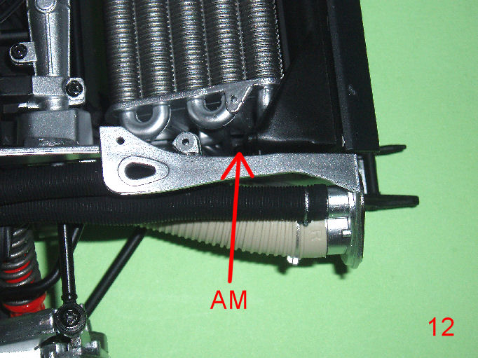

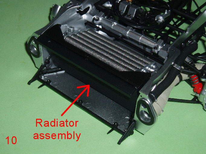

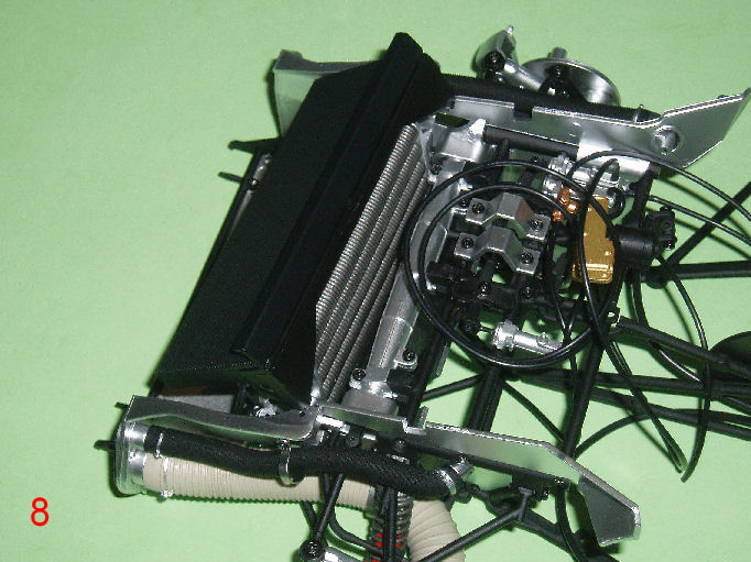

#8 Posted : 03 October 2025 10:08:49
Posts: 5,829
Points: 17,639
STAGE 43B:

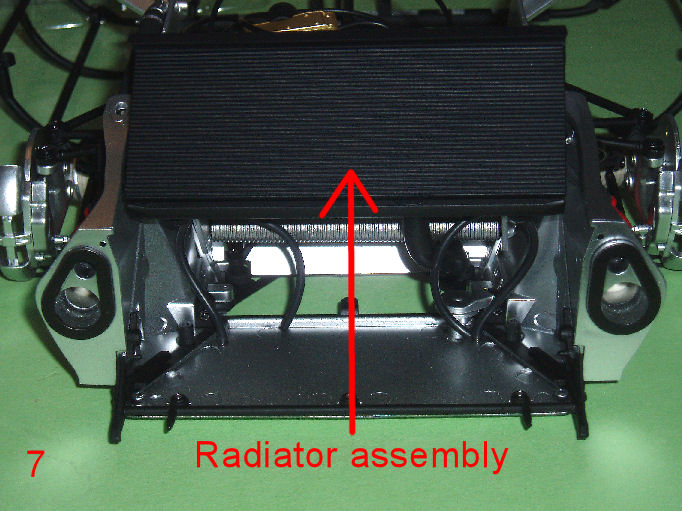

Pic 7: Tilt the radiator assembly up and over the front frame.
Pic 8: Shows the position of the radiator assembly for now.
Pic 9: Turn the chassis over and pass the two hoses 42K out and under as shown. Leave them loose for now.
Pic 10: With the chassis the right way up, rotate the radiator assembly down again, into position between the chassis side plates.
Pic 11: Fix the radiator assembly to the chassis frame using 1 x AM screw as shown.
Take your time here as it is quite fiddly.
Pic 12: Repeat on the other side.

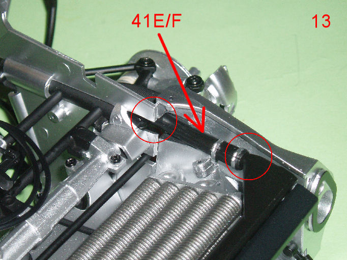

Pic 13: Retrieve the hose assembly 41E/F from stage 41 and pass the narrow end through the opening in the side panel.
Fit the front end to the radiator.

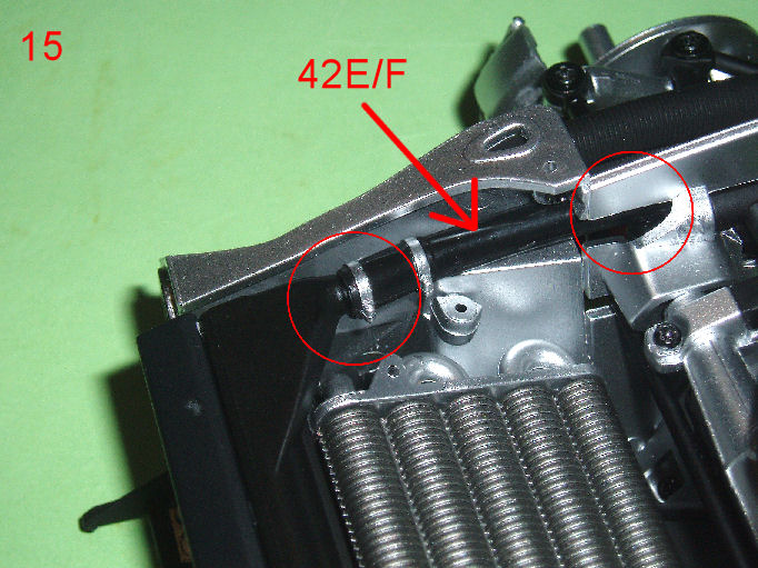

#9 Posted : 03 October 2025 10:12:01
Posts: 5,829
Points: 17,639
STAGE 43C:
Pic 14: Assemble the hose parts 42E and 42F.
Pic 15: Fit the hose in place on the other side in the same way as step 13.

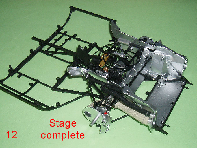

Pic 16: Fit the fixing plate 41D between the radiator side and the chassis side plate and fix with 2 x SP screws.

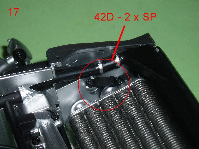

Pic 17: Repeat on the other side with fixing plate 42D.

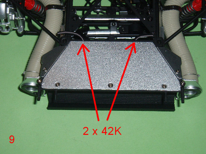

Pic 18: Turn the assembly over and trim the two hoses 42K a bit shorter, and then tuck them in under the front panel as shown.

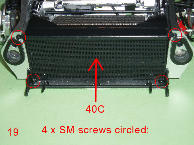

Pic 19: Bend the two lower tabs on the metal radiator panel 40C at 90 degrees forwards and fit the panel in place as shown.
Fix using 4 x SM screws.
Store the assembly and the unused frame safely for now.

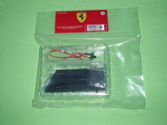

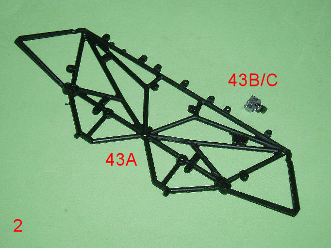

STAGE 44:
Battery box and frame.

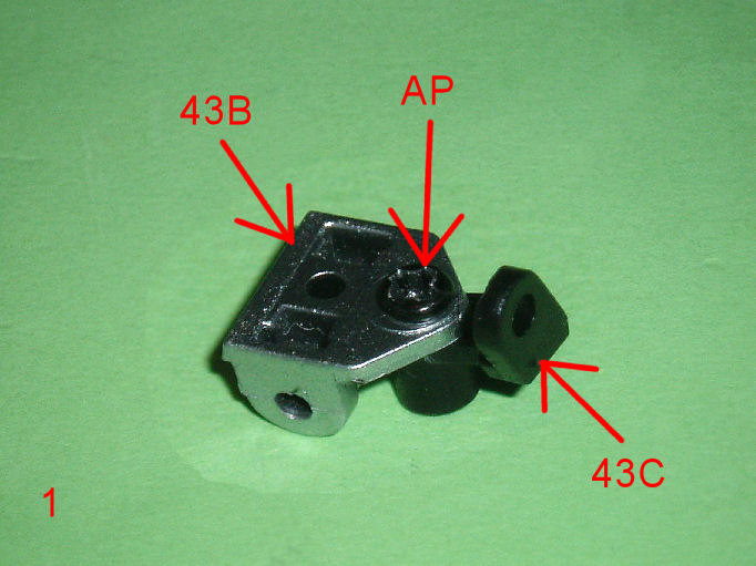

Pic 1: Retrieve the unused parts from stage 43.
Fit the junction box 43B and support 44C together and fix with 1 x AP screw.
Pic 2: Retrieve the frame 43A.
Pic 3: Fit the junction box 34B/C to the frame as shown and fix from underneath with 1 x SM screw.
Pic 4: Fit the three hoses 43D, 43E and 43F to the junction box 43B in the positions as shown.
Pic 5: Retrieve the main front assembly frame 30A and fit the battery box 44A in place.
It will only fit one way.
Fix from underneath with 3 x AP screws.
Pic 6: Store everything safely for now.
