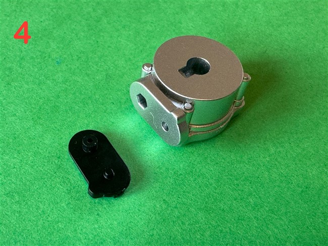

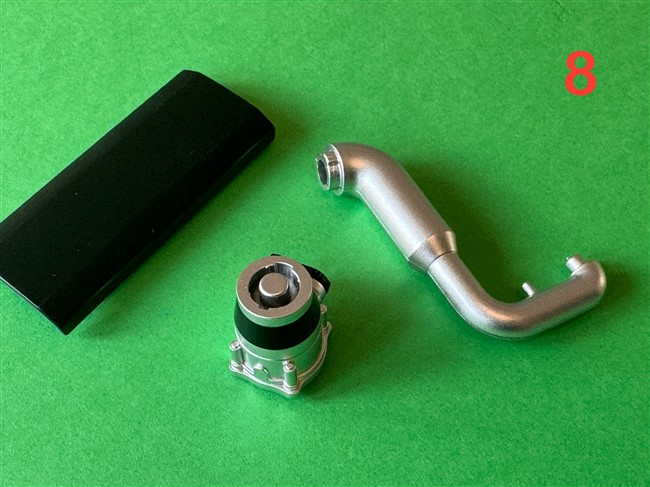

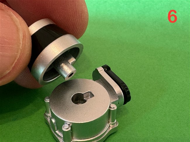

Start by assembling the right and left air intake ducts, (15C & 15B), pictures 2 and 3. Fit the air intake butterfly valve mount (15D) into the air intake throttle (15F), pictures 4 and 5.
Join the assembly to the air intake throttle body (15E) and secure it using a “C” screw, pictures 6 and 7.

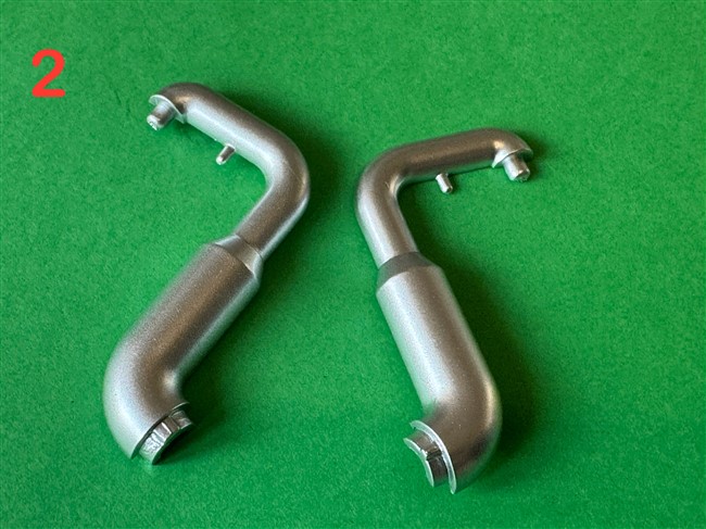

Join the two halves of the left-hand PCV tubes (17A & 17B), by pressing the two ends together, picture 2.
Next, fit the end of the left exhaust manifold elbow (17D) onto the left exhaust manifold (17C), picture 3.
Press the end of the left-hand engine PCV tube into the rear hole in the rear end of the left cylinder head, picture 4.
Finally, push fit the pins on the left exhaust manifold into the holes in the left cylinder head, picture 5.

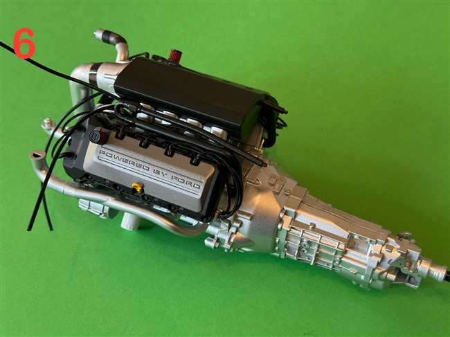

Join the two halves of the right-hand PCV tubes (18A & 18B), by pressing the two ends together, picture 2.
Next, fit the end of the right exhaust manifold elbow (18D) onto the left exhaust manifold (18C), picture 3.
Press the end of the left-hand engine PCV tube into the rear hole in the rear end of the right cylinder head, picture 4.
Finally, push fit the pins on the right exhaust manifold into the holes in the left cylinder head, picture 5.
Pictures 6 and 7 shows the complete assembly for this issue.

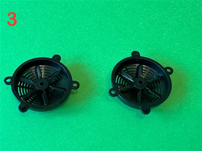

Start by fitting the pins of the fan blades (19B) into the centre of the fan grilles (19C), pictures 2 and 3.
Place the radiator fan shroud (19A) over the fan grills as illustrated in pictures 4, 5, 6 and 7.

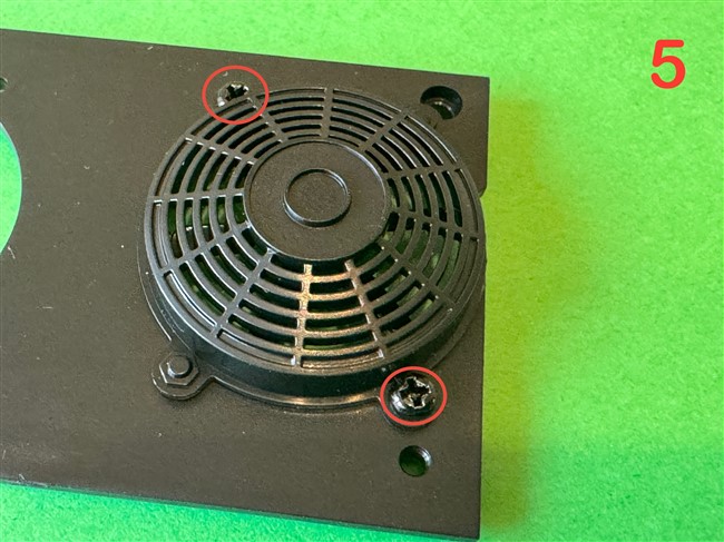

Take the fan assembly from the previous issue and attach it to the back of the radiator as shown in picture 5 using 4 x type “G” screws. Push fit the radiator header (20C) onto the top of the radiator, pictures 6 and 7.

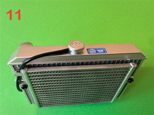

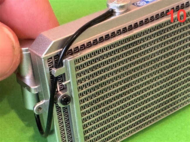

Retrieve the expansion tank from the previous issue and attach it to the side of the radiator as shown in picture 8. Place the radiator cap on the top of the radiator, picture 9, then place the hose between the radiator cap and the expansion tank, picture 10.
Pictures 11 and 12 show the complete assembly for this issue.
