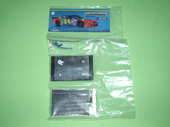

Radiator.
Pic 1: Fit the bracket 33B to the side of the radiator frame 33A and fix using 1 x EP screw.

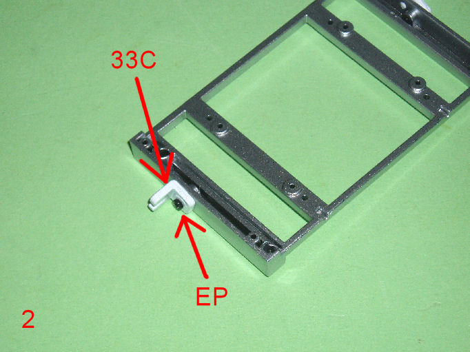

Pic 2: Fit the bracket 33C to the other side in the same way.

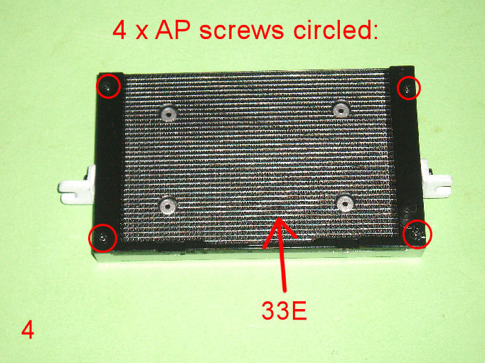

Pic 4: Turn the assembly over and fit the panel 33E.
It will only fit one way.
Fix with 4 x AP screws.

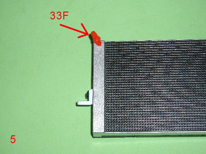

Pic 5: Fit the filler 33F to the hole in the top left corner of the radiator front.

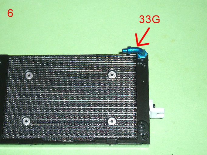

Pic 6: Fit the hose connector 33G to the other side of the radiator.

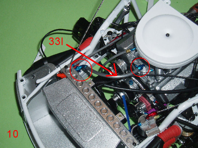

Pic 7: Fit the hose 33I to the connector 33G.

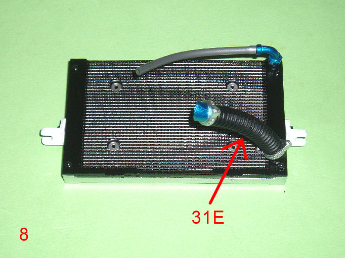

Pic 8: Retrieve the bottom hose 31E from stage 31 and fit it to the lower right corner of the radiator as shown.

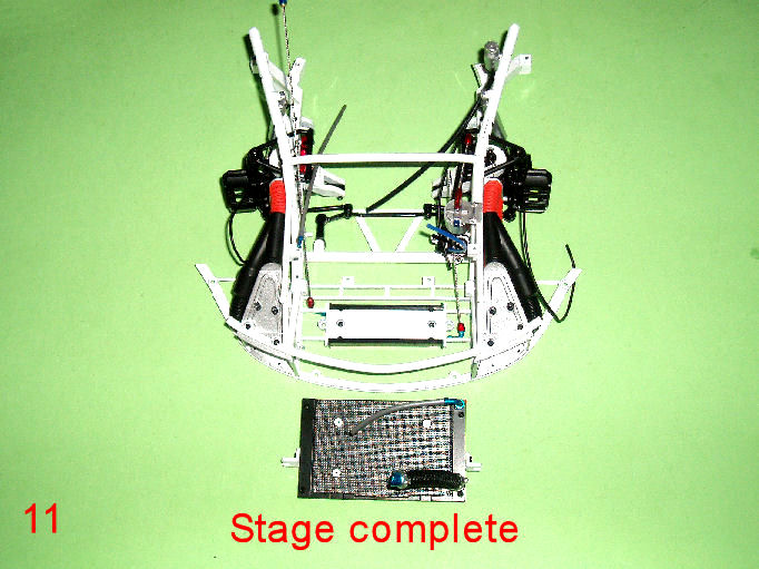

Pic 11: Store the parts safely.

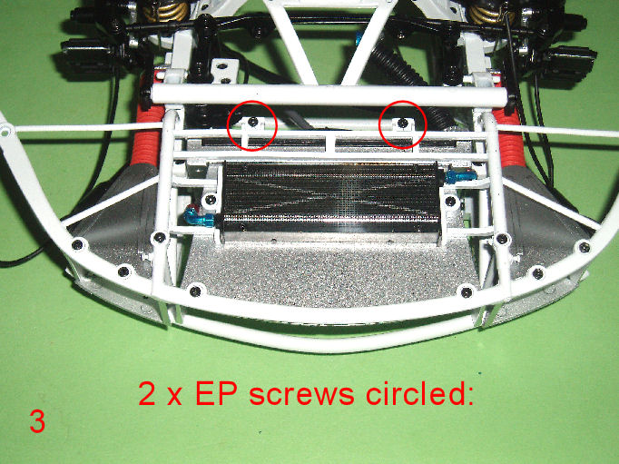

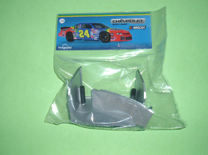

STAGE 34:
Radiator air scoop.

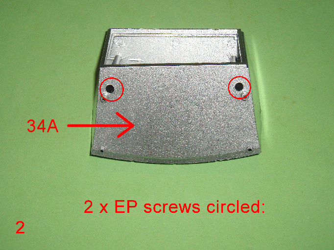

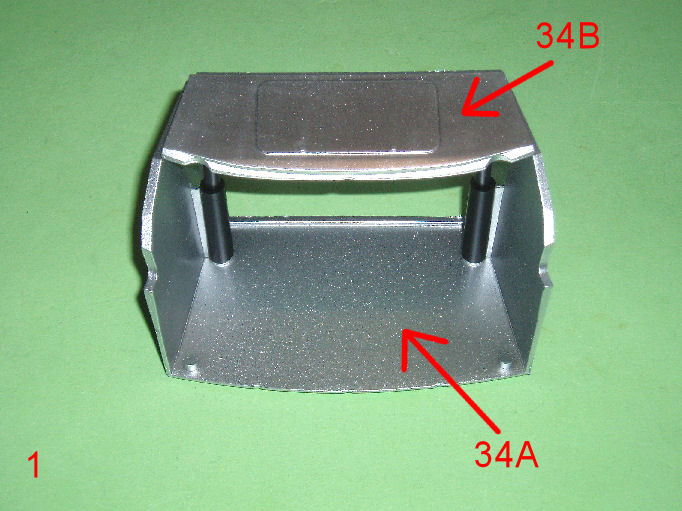

Pic 1: Fit the two air scoop parts 34A and 34B together as shown.
Pic 2: Fix the parts together from underneath with 2 x EP screws.
Pic 3: Fit the assembly inside the front frame of the car as shown.
This takes some ‘jiggling’ to achieve.
Make sure the upper front of the assembly locates under the front bar where indicated.
Pic 4: Turn the model over and fix the parts with 4 x EP screws.
Pic 5: Store the assembly safely for now.

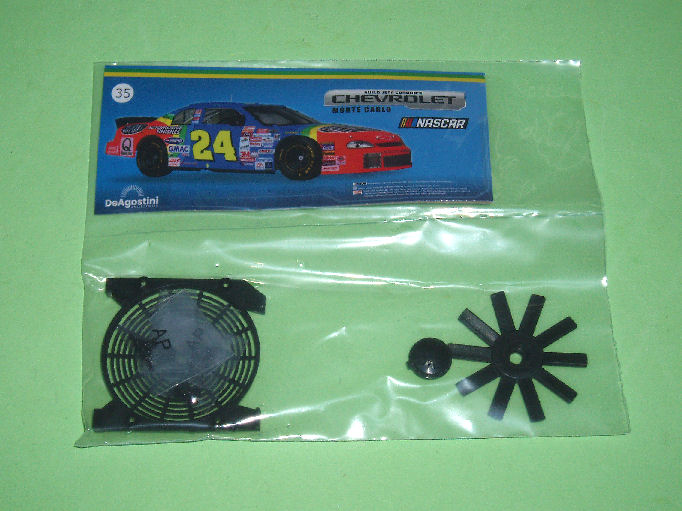

Radiator fan.
Pic 1: Fit the fan 35B inside the fan shroud 34A as shown.
Pic 2: From the other side, fit the fan cap 35C.
It has a key/slot location so it will only fit one way.
Fix from the other side with 1 x PP screw.
Pic 3: Retrieve the radiator assembly and lay it with the fan fixing holes face up.
Fit the fan assembly in place and fix using 4 x AP screws.
Store the assembly safely.

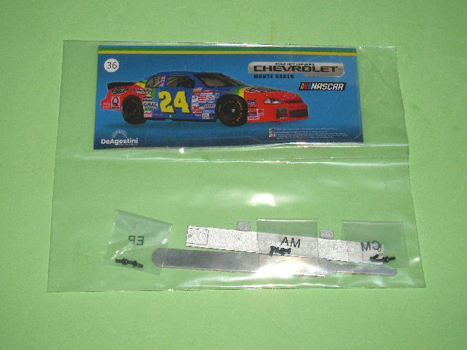

STAGE 36:
Radiator.
Pic 1: Carefully wiggle the radiator 33A in place behind the radiator shroud 34A.
Pic 2: Fix the radiator using 2 x AM screws as shown.
Pic 3: Turn the assembly over and fix the radiator from below using 2 x EP screws.

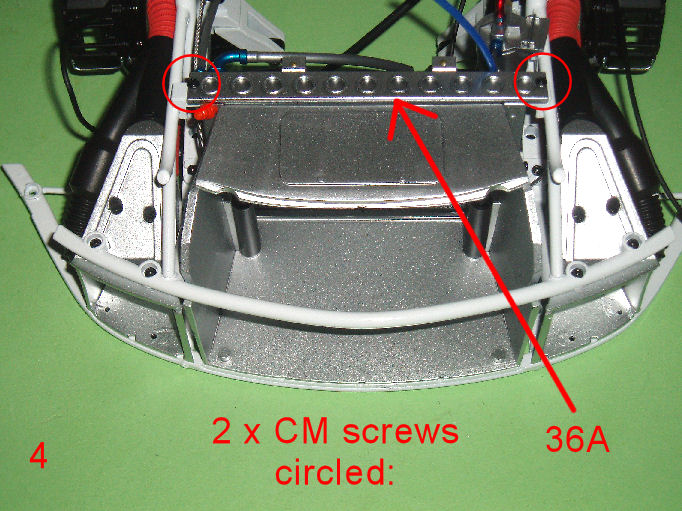

Pic 4: Fit the top cross member 36A to the top of the radiator and fix at each end with 1 x CM screw.
#5 Posted : 06 October 2025 13:59:53

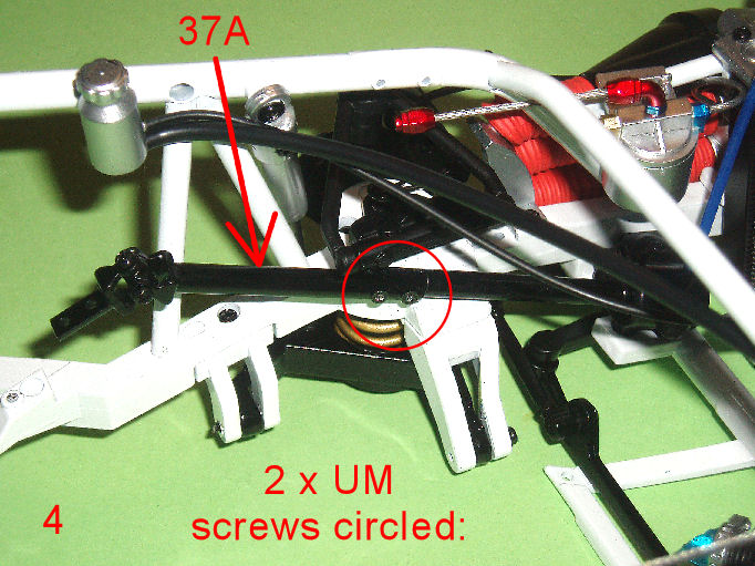

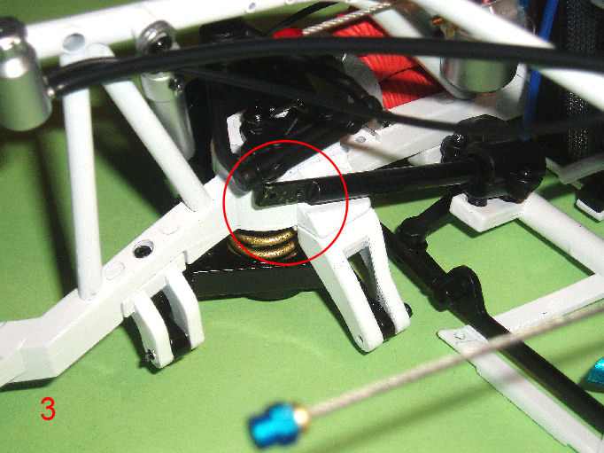

Pic 3: Retrieve the car frame assembly and twist the column so that the flat face is toward you as shown.
Pic 4: Fit the column 37A in place and fix using 2 x UM screws.
The off-centre tab on the other end of the column should be toward the bottom.

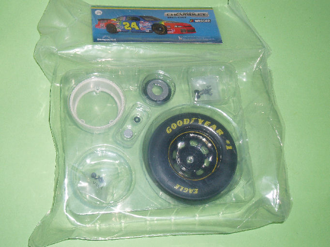

STAGE 38A:
Right front wheel and engine mounting.

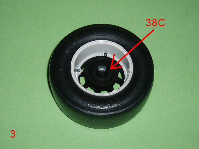

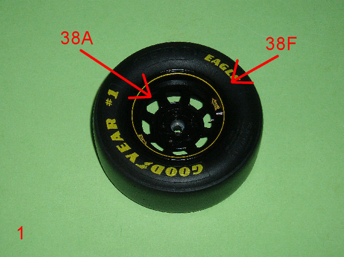

Pic 1: Fit the outer rim 38A and tyre 38F together as shown.
Pic 2: Fit the rear rim in place lining up the screw fixing points.
Fix the parts with 3 x IM screws.
Pic 3: Fit the inner wheel cap 38C in place.
Store the wheel and screw/washer safely for now if you choose not to fit it yet.

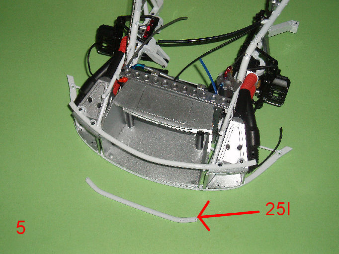

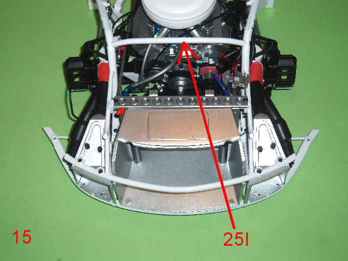

Pic 4: Retrieve the main frame and remove the cross-bar 25I.
Pic 5: Cross-bar removed.
Do not lose the screws.

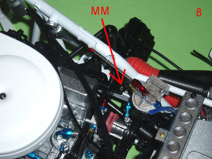

Pic 6: Fit the engine into the frame.
It is a tight fit so take care. The fixing tabs on each side must sit down on the frame.

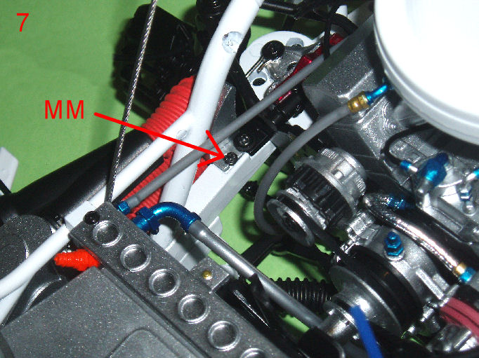

Pic 7: Fix on each side with 1 x MM screw.
#7 Posted : 08 October 2025 10:28:23
Posts: 5,868

Pic 10: With the model the right way up, connect the radiator top hose as shown.

Pic 15: Fit the top cross-bar back in place.
