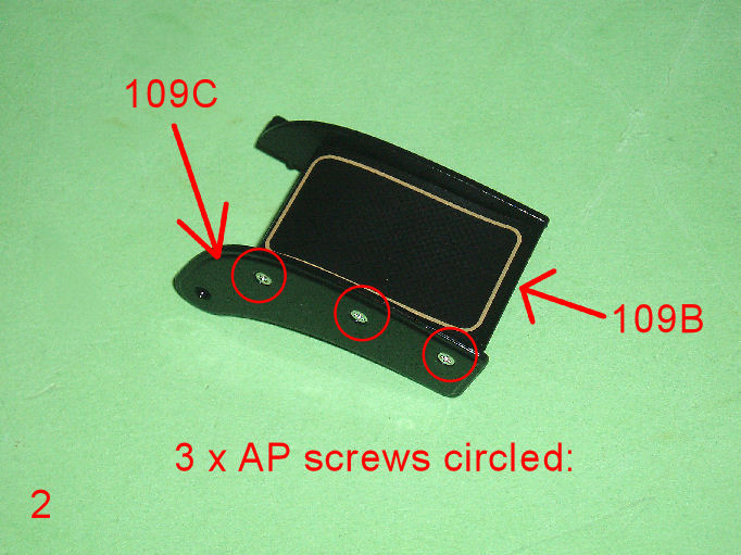

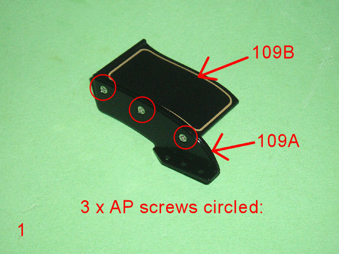

Pic 1: Fit the rear winglet parts 109A and 109B together and fix with 3 x AP screws.
Pic 2: Fit the other winglet part 109C in place on the other side and fix with 3 x AP screws.

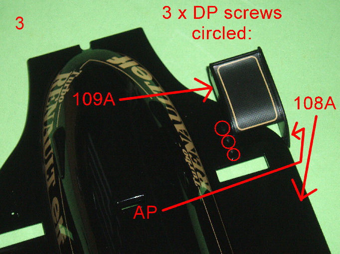

Pic 3: Fit the assembly to the right side of the main body 108A and fix with 3 x DP screws on the inside edge and 1 x AP screw on the outside.

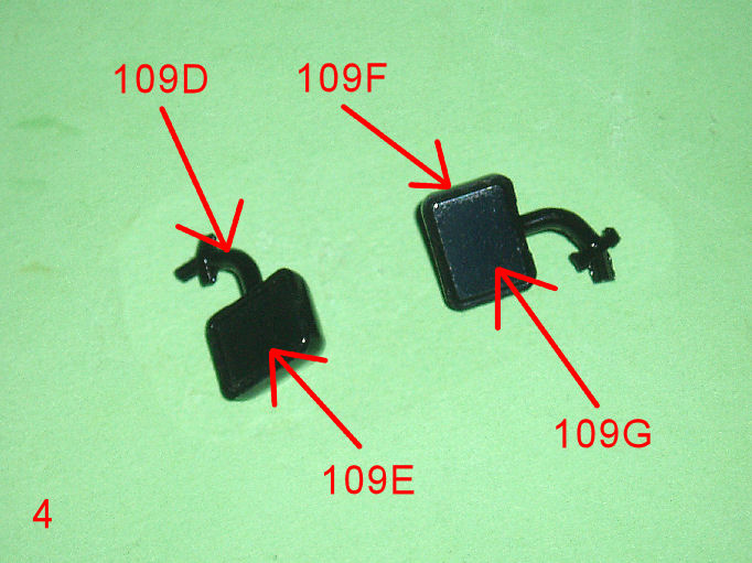

Pic 4: Press-fit the mirrors 109E and 109G into the holders 109D and 109F.

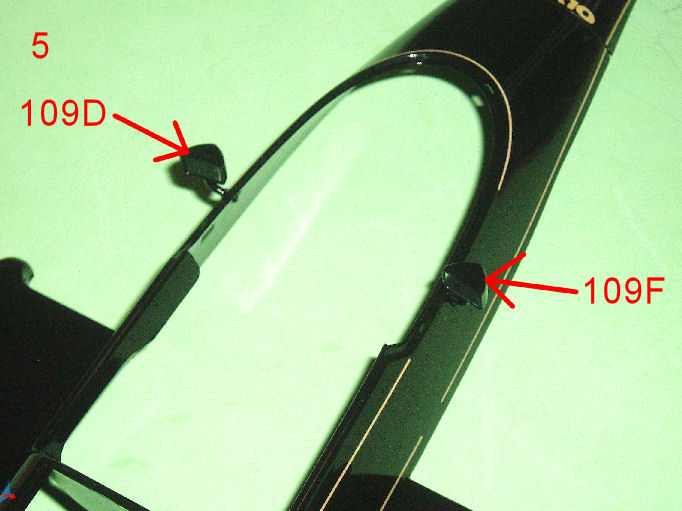

Pic 5: Fit the mirrors into the sides of the main body as shown.
Take care not to bend and break the mirror stalks.

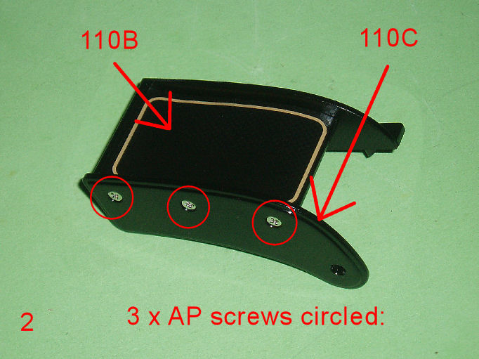

Pic 1: Fit the rear winglet parts 110A and 110B together and fix with 3 x AP screws.
Pic 2: Fit the other winglet part 110C in place on the other side and fix with 3 x AP screws.
