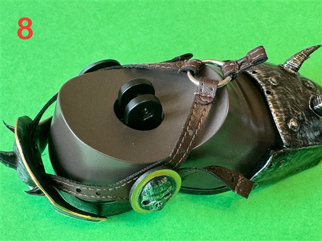

Retrieve the shoe assembly from issue 8 and place the strap assembly over the shoe as shown in picture 8. To secure the strap in place over the shoe, take the central attachment loop (9G) inside the central tab of the strap, picture 9. Press the loop firmly into the two holes on the top centre of the show, picture 10.

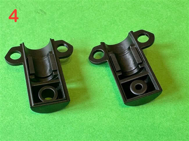

Place one of the spacers (10D) into both halves of the left ankle (10A & B), pictures 2 and 3. Picture 4 shows them in place.

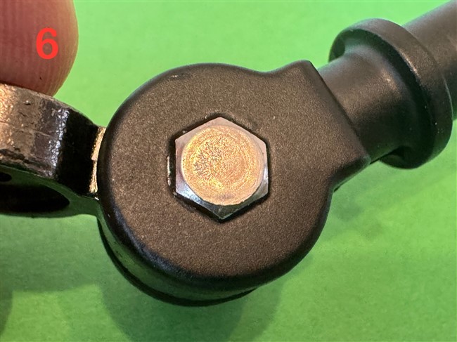

Retrieve the completed ankle joint from issue 8 and place its smooth circular end between the two discs of the left ankle (10C), picture 5. Secure the two parts using the hexagonal screw, two washers and the nut as shown in pictures 6 and 7.

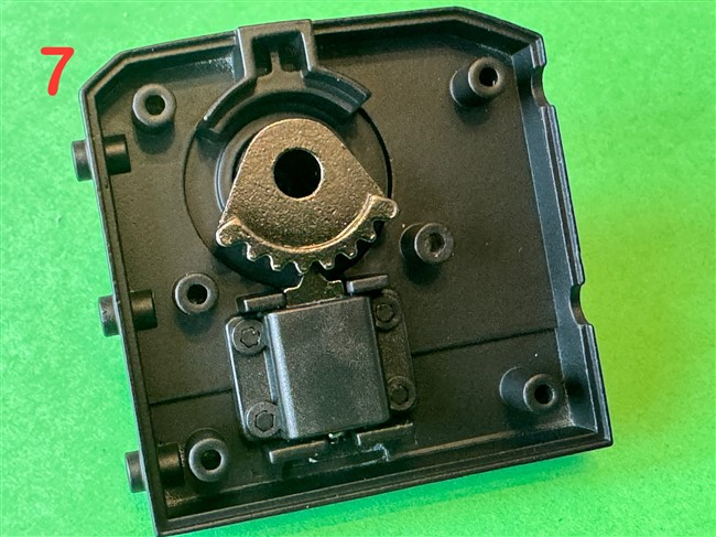

Position the gear (12B) on the joint, picture 7 and align the hole and insert the pin in the two parts, picture 8.

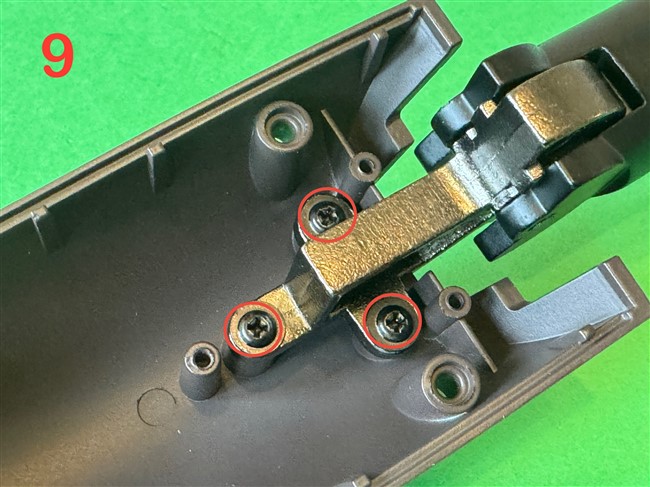

Place the joint assembly into the assembly from the previous issue, securing it in place using 3 x EM screws, picture 9.
