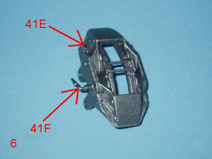

STAGE 41B:
Pic 6: Press-fit the brake pipe connector 41F into the caliper 41E.
Make sure it is angled as shown.
Pic 7: Fix the caliper to the main assembly with 2 x AM screws.
Pic 8: Fit the narrow end of the upper arm 41H to the main assembly in the position shown and fix it with 1 x BM screw.
Pic 9: Fit the brake pipe 41J to the connector 41F.
Pic 10: Fit the support 41I to the assembly in the position shown and fix with 1 x ANM screw from the outside at each end.

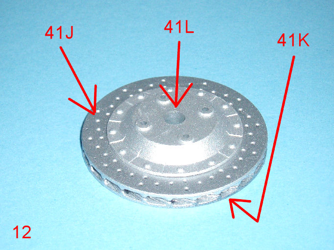

Pic 11: Locate the three disc parts 41J, 41K and 41L.
Pic 12: Press-fit the parts together in the order shown.
Store the assembly and disc safely for now.

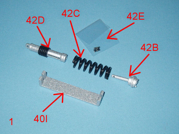

STAGE 42A:
Right front suspension.

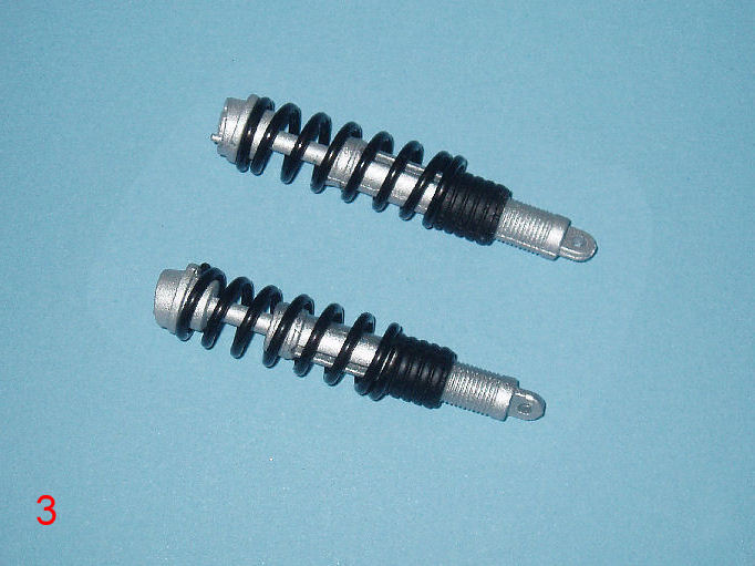

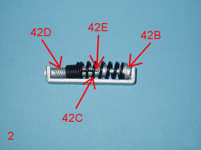

Pic 1: Locate the spring and damper parts 42B, 42C, 42F and 42E.
Retrieve the build cradle 40I saved from stage 40.
Pic 2: Using the cradle 40I, assemble the parts as shown, pressing one of the 42E pins into the hole in the end of 42B to lock the parts together.
Pic 3: Make two assemblies.

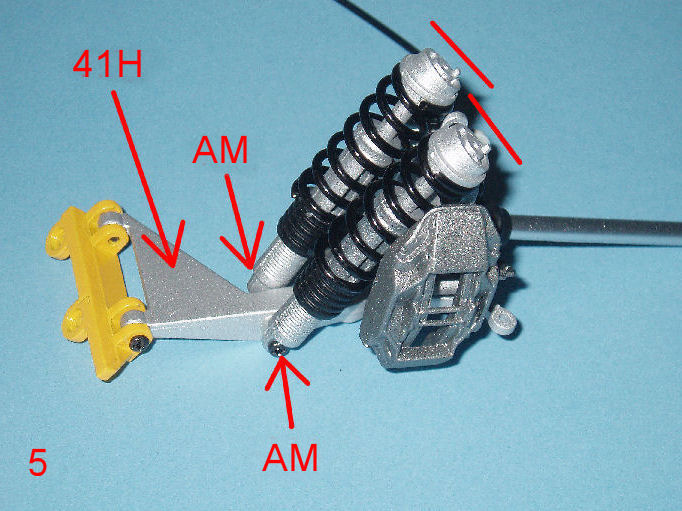

Pic 4: Retrieve the assembly from the previous stage and fit the shock absorbers/springs in place on the arm 41H as shown, fixing them using 1 x AM screw in each.
NOTE – the angled upper end of the shock absorber shown in red must be facing the way indicated.

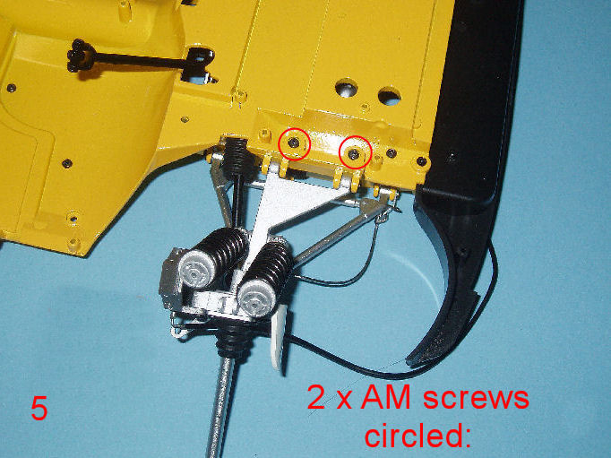

Pic 5: Retrieve the main car assembly and fit the suspension in place on the front left side, fixing it with 2 x AM screws.

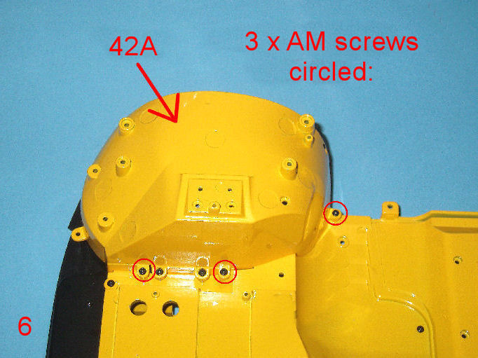

Pic 6: Fit the wheel arch 42A to the floor as shown, fixing it with 3 x AM screws.

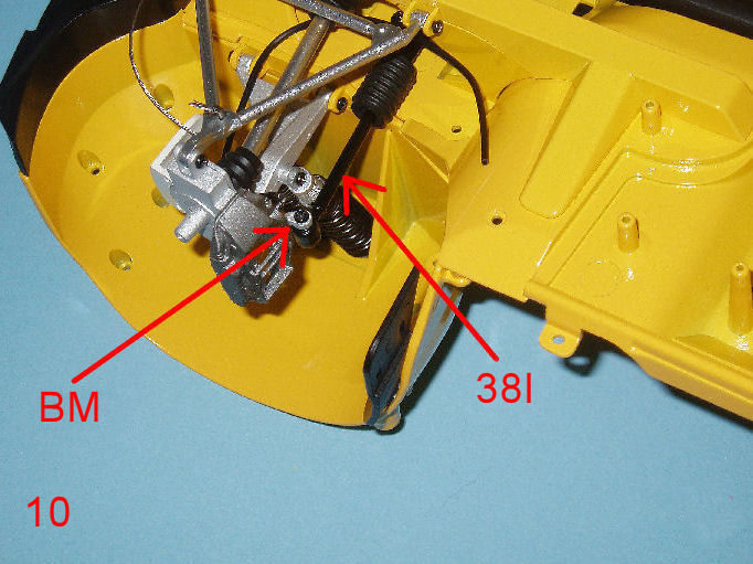

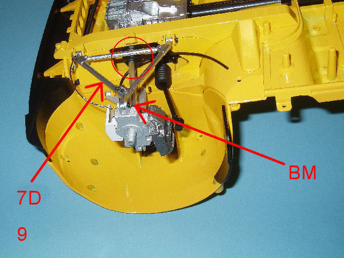

STAGE 42B:
Pic 7: From underneath, lift the suspension so that the two shock absorbers locate in the holes in the inside of the wheel arch 42A.
Pic 8: Fix the parts in place from above using 2 x AM screws.
Pic 9: With the model upside down, fit the lower suspension arm 7D into the hub upright as shown and fix with 1 x BM screw.
Make sure the drive shaft locates in the rubber gaiter circled.
Pic 10: Lift the steering arm 38I into position and fix it to the hub upright with 1 x BM screw.

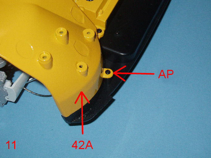

Pic 11: From above, fix the front of the wheel arch 42A with 1 x AP screw.
