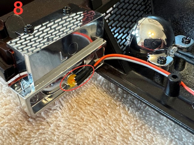

#4 Posted : 17 October 2025 14:41:04
Posts: 7,387
Points: 22,468
Issue 110
Fitting the Turn Signals
Using the “L” and” R” markings as guides, push the two sets of housings (110A &110C) and lenses (110B & 110D) together, pictures 2 and 3.
Attach each turn signal to the front of the body panel using 2 x AM screws, pictures 4 and 5.
Unplug the front left and front right turn signals marked “G” and “H”, picture 6.
Push the right signal LED (H) into the hole in the right turn signal. Bend the bulb casing in a 90-degree angle as shown in picture 7. This is also the shorter of the two cables.
Do the same with the left-hand LED, pushing it into the left turn signal, picture 8.
Finally, use the four cable clips to run the four cables in the assembly, each clip uses 2 x AM screws, pictures 9 and 10.
Picture 11 shows all four clips in place. Note, I also used some of the black tape to secure the cables.

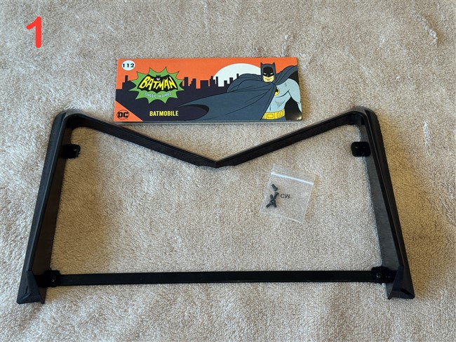

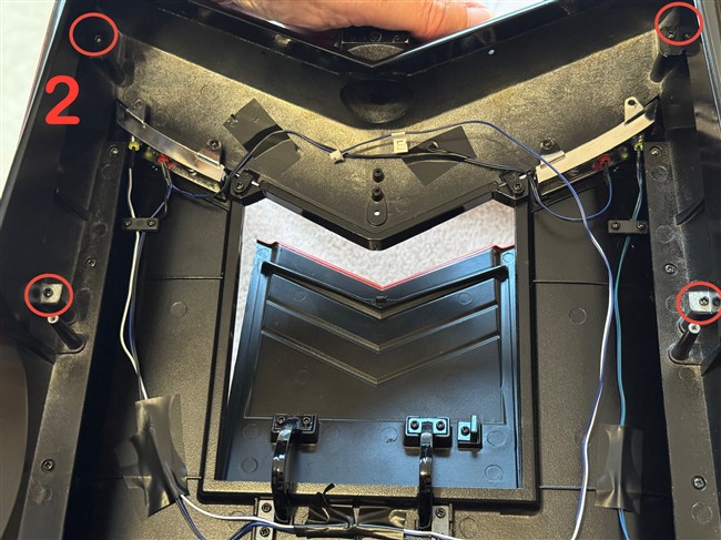

#7 Posted : 21 October 2025 10:23:47
Posts: 7,387
Points: 22,468

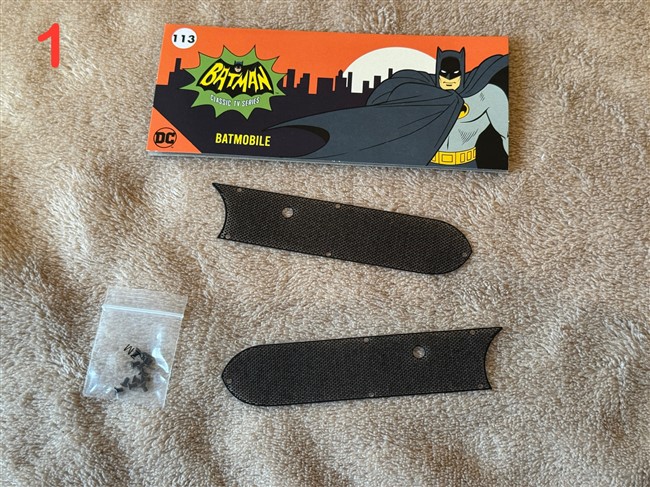

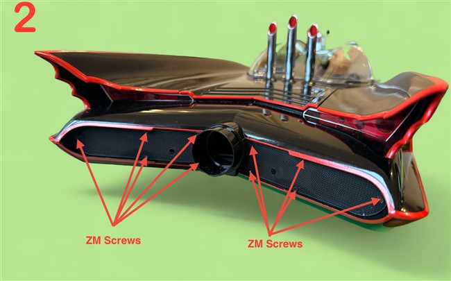

Issue 113
Fitting the Left and Right Back Grilles.
Place the grilles to the rear of the body frame and secure each one in place by using 5 x ZM screws as shown in picture 2.
Pictures 3 and 4 show the assembly complete for this issue.
