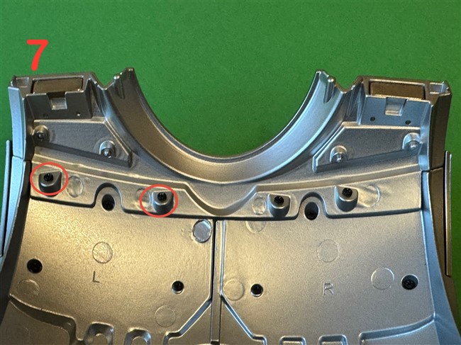

Place the right clavicle triangle (95B) marked with an “R””, picture 2, in the hole onto the right side of the upper armour (95A), picture 3. Do the same with the left clavicle triangle (95C), picture 4.
Retrieve the right chest armour from issue 3 and connect it to the upper armour on its right side, picture 5. Turn both assemblies over and attach the two parts together using 2 x AM screws, picture 6. Retrieve the left chest armour from issue 3 and do the same with the left side, picture 7. Picture 8 shows the parts in place.
Retrieve the pins from issue 94 and insert the left pin, marked with an “L” into the hole under the arm, part 91A to reinforce the joint between it and the front armour, picture 9. Do the same with the right pin, picture 10.
