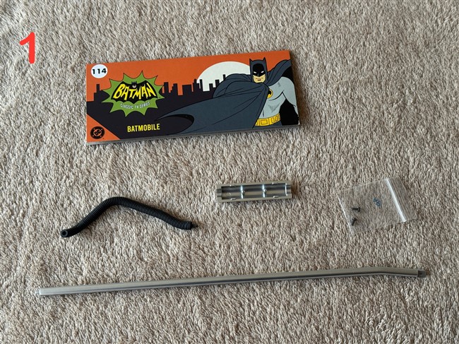

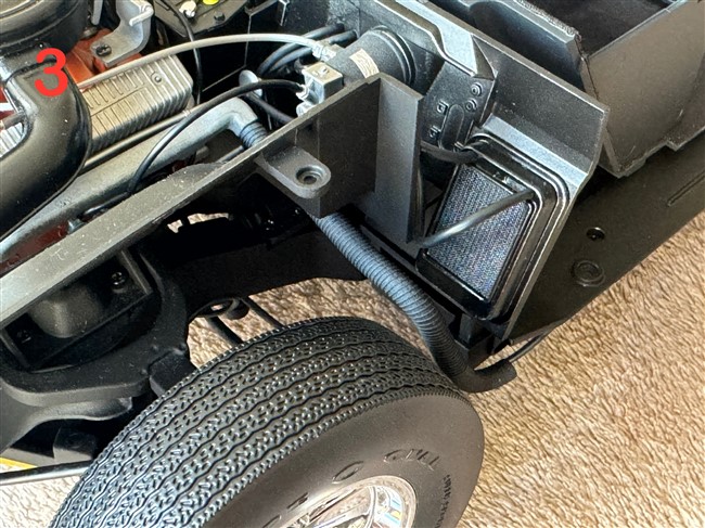

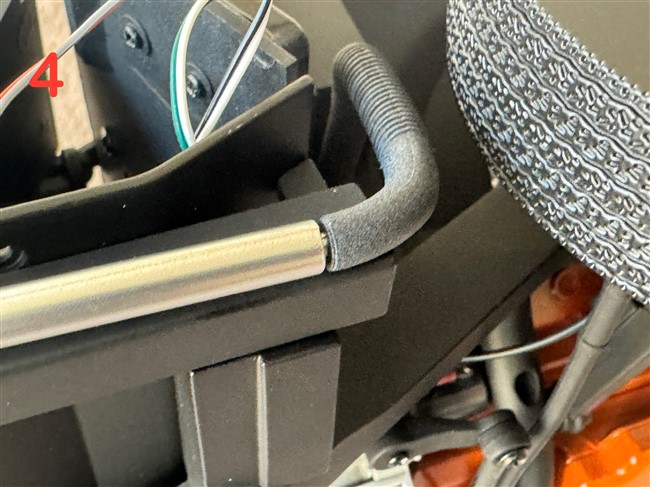

Fitting the Front and Bottom Left Pipes

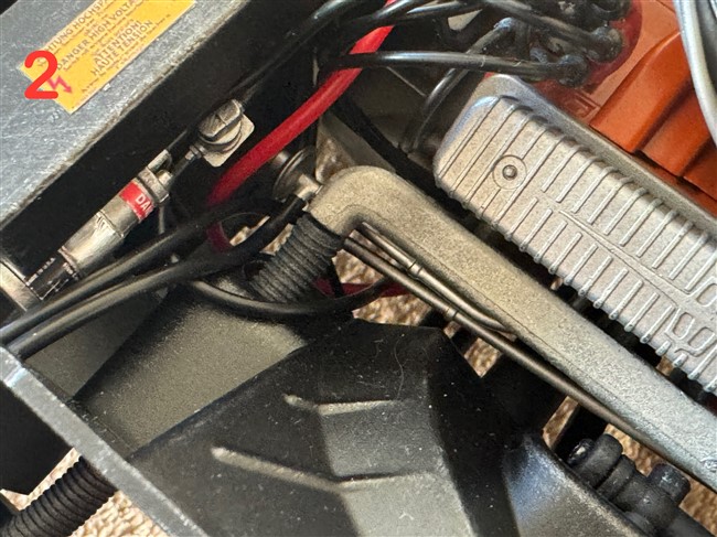

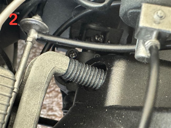

Begin by push fitting on the left exhaust pipe (114B) through the hole in the wheel arch and onto the end of the left exhaust manifold as shown in picture 2 and 3.
In this next part, we assemble the bottom pipe that runs along the underside of the car and attached to the rear exhaust. As you will see, I have assembled this part, but this will need to be removed again when attaching the upper body to the main car assembly, so you may want to leave this off until then.

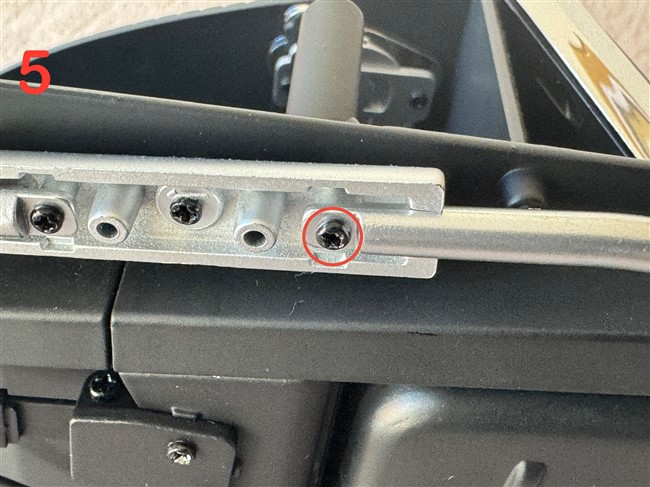

Attach the left exhaust pipe (114A) by pushing the pin into the front exhaust pipe and securing the rear end to the muffler using an AP screw. The exhaust pipe also has two pins that push fit into the holes in the underside of the body, pictures 4 and 5.

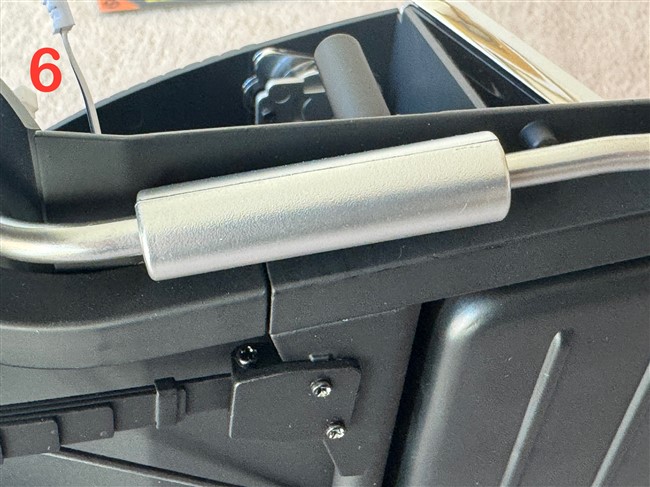

Finally, attach the muffler bottom (114C) but push fitting it onto the top muffler, picture 6.

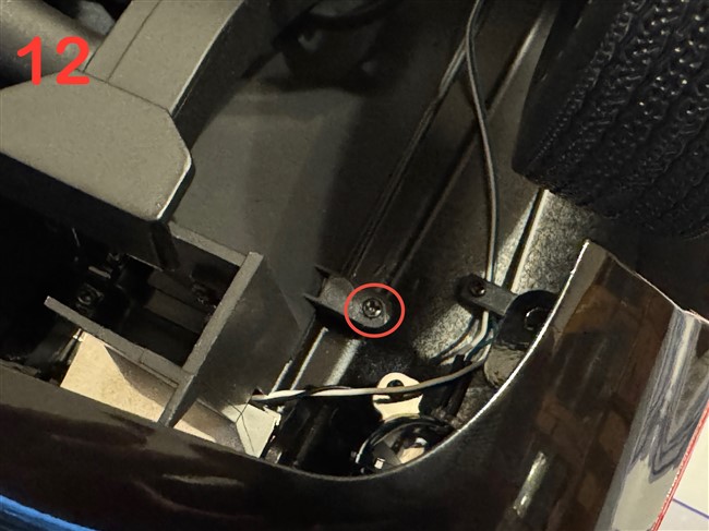

Using CM screws, place two at the front of the body as shown in pictures 12 and 13. Then place two more on either side of the chassis where the exhaust pipe lies, picture 14. Finally attach the last two CM screws at the rear of the chassis, pictures 15 and 16.
