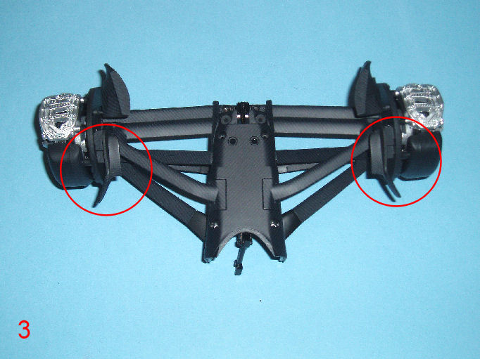

Brake disc deflectors.
Pic 1: Retrieve the front assembly and press-fit the right deflector 30A into the two slots in the brake back plate 22D as shown.
Pic 2: Shows the parts from the other side.
Pic 3: Fit the left deflector 30B in the same way.
Pic 4: Shows the parts from the other side.

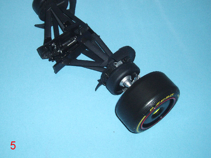

Pic 5: The printed instructions now suggest fitting the front wheels.
This is shown in the following steps but I am not actually fitting the wheels here as they are heavy and there is a risk of future damage to the assembly.
The wheels will be fitted at the end of the build.
Pic 6: Fit the right front wheel in place and locate the nut 29B from the previous stage, and the axle 30D.
Fit them together as shown.
Pic 7: Fit the parts into the wheel centre and tighten the axle 30D.
Pic 8: Repeat on the other side with the wheel assembled much earlier in the build, fixing it with the axle and nut 30C and 30D.
Pic 9: As mentioned, you can fit the wheels now, or save the axles and nuts safely, to fit the wheels later.

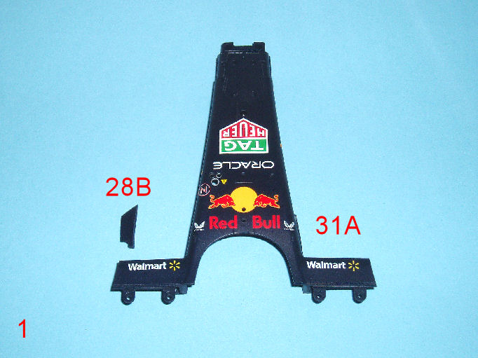

STAGE 31:
Front bodywork 1.
Pic 1: Retrieve the halo support 28B, and the front body 31A.
Pic 2: Fit the support 28B to the top of the body as shown.
Pic 3: Fix from underneath with 1 x ‘A’ screw.
