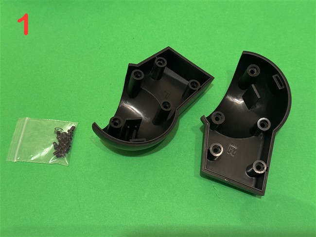

Before we start this issue, the parts differ slightly from the magazine. As I stated in issue 14, where they also differed, it seems that issue 14, has the parts for 15 and issue 15 has the parts for 14. In this issue you also have the part 15G which fits into the issue 14 assembly. All will be explained below.

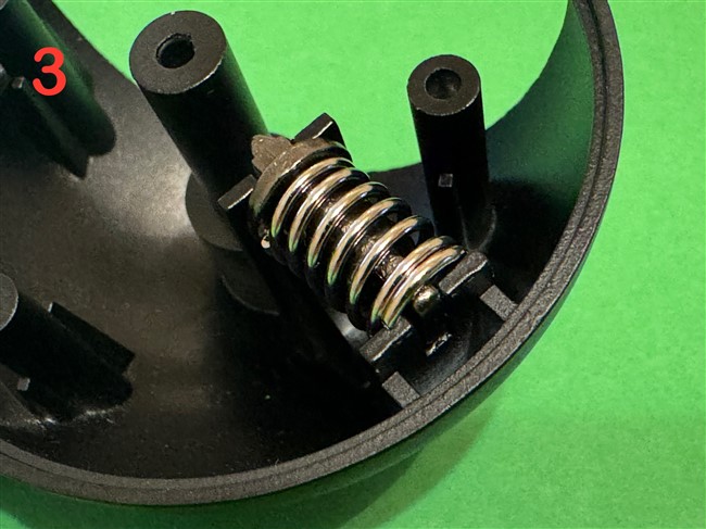

Slide the joint spring (15B) onto the rod (15C), picture 2. Place the assembly inside the gearbox (15A) with the rod engaged in the notches as shown in picture 3. Place the cover plate (15D) into place as illustrated in picture 4.
Insert the outer thigh joint (15E) into the box on the opposite side of the previous assembly. Place the inner thigh joint (15F) by inserting it inside 15E, picture 5, then secure it in place using a GM screw, picture 6, making sure it is central to the locking rod.
Take the assembly from issue 14, picture 7, and fit the connecting rod (15G) as shown in picture 8. Connect the two assemblies, issue 14 and 15, together using 6 x LM screws, picture 9.
Picture 10 shows the complete assembly for this issue.

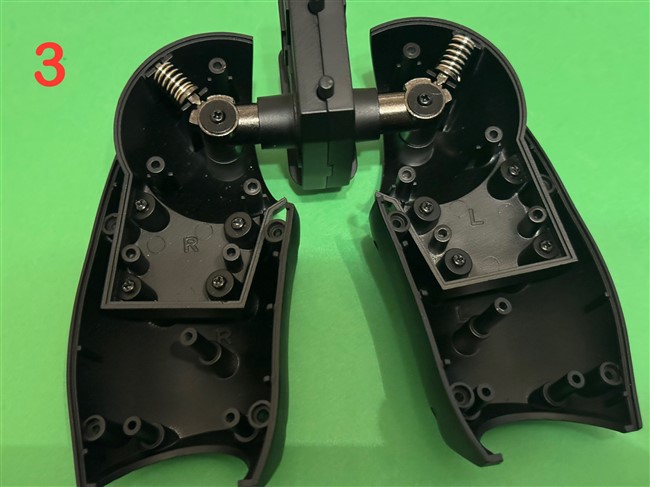

#3 Posted : 14 November 2025 10:22:41
Posts: 7,381
Points: 22,450
Issue 17
The Right Thigh
Insert the thigh locking rod (17B) into the locking spring (17C), picture 2. Place the assembly into the thigh structure (17A), picture 3.
Take the hip joint and thigh assembly from the previous issue and place it into the axis of the thigh structure as shown in picture 4 and secure it in place using an MM screw.

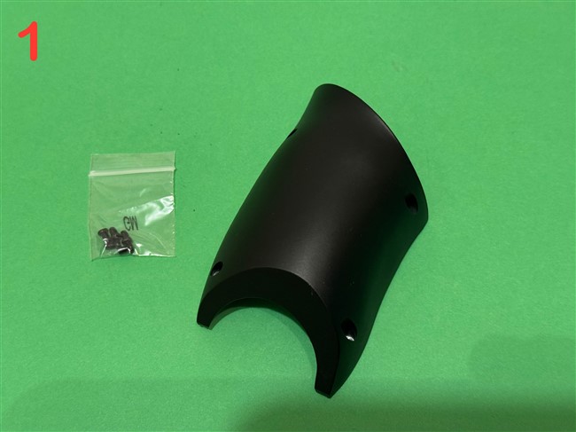

#5 Posted : 16 November 2025 17:06:11
Posts: 7,381
Points: 22,450
Issue 19
The Right Thigh
Place the back of the thigh (19A)under the hip joint assembly and secure it using 4 x GM screws, picture 2.
Picture 3 shows the complete assembly for this issue.

#6 Posted : 17 November 2025 20:04:56
Posts: 7,381
Points: 22,450
Issue 20
The Hip Joints
Place the front cover of the right hip (20B) onto the assembly, covering the right joint. Secure it using 5 x GM screws, picture 2.
Do the same with the left hip (20A), picture 3.
Picture 4 shows the complete assembly for this issue.
