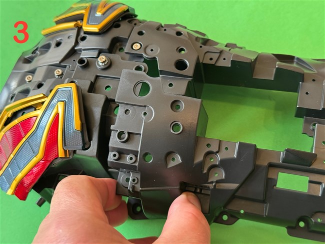

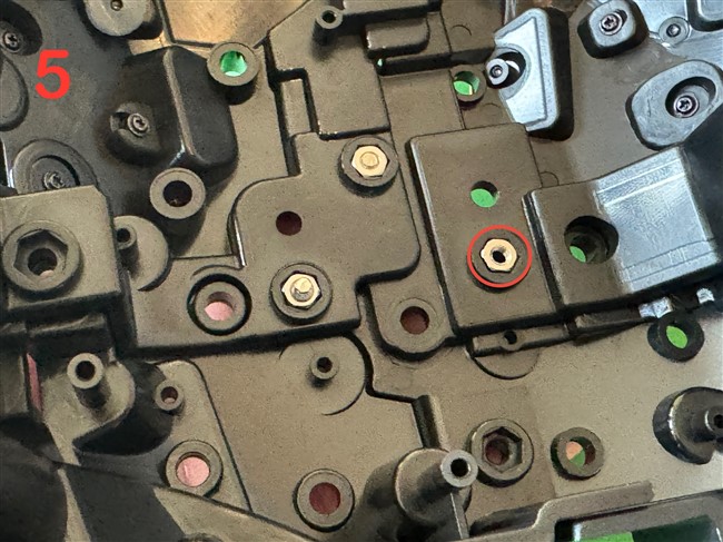

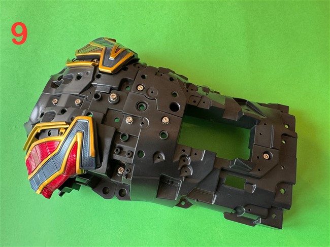

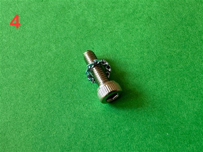

#3 Posted : 19 November 2025 18:58:59
Posts: 7,312
Points: 22,243
Issue 29
The Abdominal Details
Position the left abdominal detail and secure in place using 2 x Type E screws, picture 2.
Do the same on the right-hand side using the right abdominal detail, picture 3.
