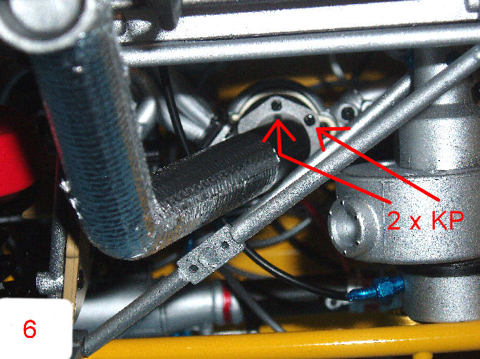

Pic 6: Turn the model upside down and fit 2 x KP screws in the other two holes.

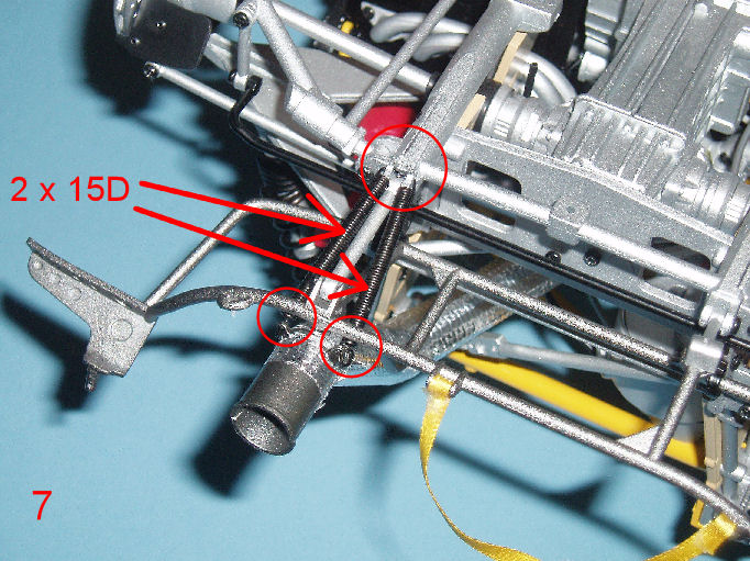

Pic 7: With the model still upside down, retrieve the two springs 15D from stage 15 and fit them to the frame and exhaust as shown.

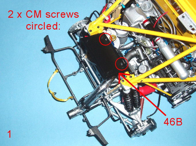

Oil radiator.
Pic 1: Fit the lower half of the radiator 46B to the upper rear engine frame as shown and fix with 2 x CM screws
Pic 2: Press-fit the upper half of the radiator 46A in place with the oil line fittings to the right when viewed from behind.

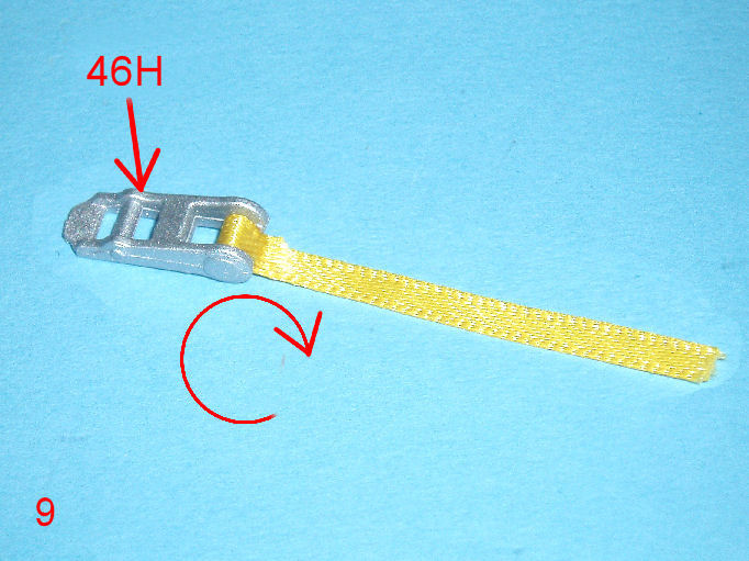

Pic 9: Feed the fabric through the end of the buckle 46H as shown, peel off the backing paper from the tape and fold it over, sticking it down firmly.

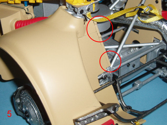

Fit the arch assembly in place making sure the suspension rod locates in the groove in the arch as indicated.
Pic 4: A different view of the arch in place.
Pic 5: From the outside, make sure the parts fit neatly where indicated.

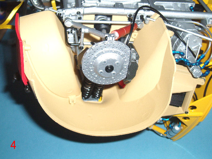

Pic 6: From the inside, fix the arch in place using 3 x AP screws.
Pic 7: Fix the arch parts in place using 2 x AP screws.

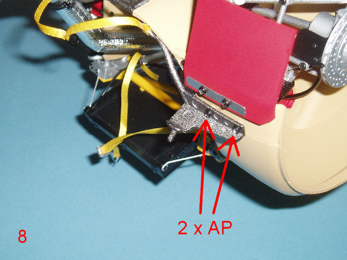

Pic 8: Fix the spare tyre support to the rear of the wheel arch using 2 x AP screws as shown.

Pic 3: From the outside, make sure the parts fit neatly where indicated.

Pic 6: Fix the spare tyre support to the rear of the wheel arch using 2 x AP screws as shown.
