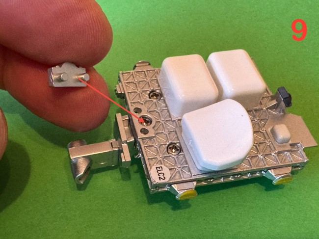

Issue 97
Take the parts 31W, 31T and the assembly from the last issue, picture 2 and attach them as shown in pictures 3 and 4 using an AS5 screw.
Next, attach part 31V using an AS5 screw, pictures 5 and 6. Place piece 31U securing it with an AS5 screw, pictures 7 and 8.
Attach the screw cover 31Z, pictures 9 and 10.
Attach both the parts 31X and 31Y by push fitting them in place, picture 11.
Attach the assembly to the main frame assembly by using an MS4 screw, picture 12.
