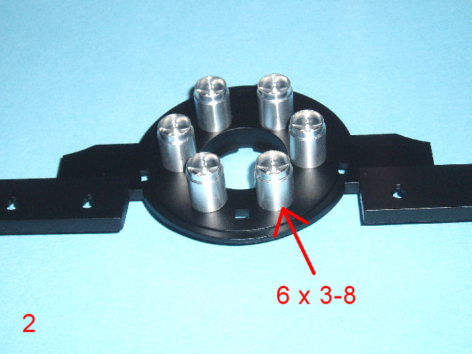

Pic 2: Press-fit the 6 x reactor tubes 3-8 in place over the shafts.

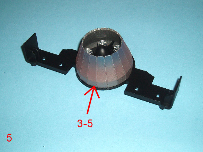

Pic 5: Press-fit the reactor vent 3-5 onto the base plate.
It will only fit one way.

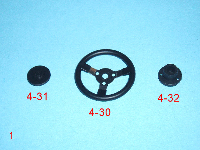

Pic 1: Locate the steering wheel parts 4-30, 4-31 and 4-32.
4-31 will fit on the front of 4-30 and 4-32 goes on the rear.
Pic 2: Parts assembled.

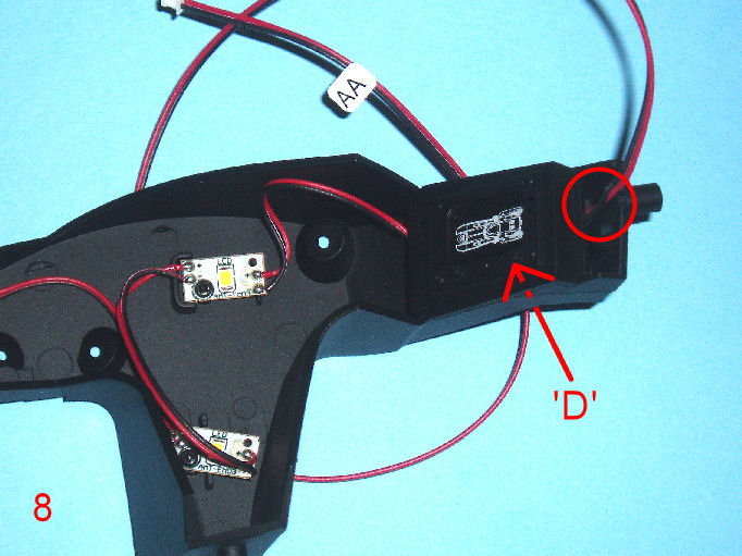

Pic 8: Fit the assembly on the right of the dashboard and fix from behind with 1 x ‘D’ screw.
Note that the LED wire locates in the small groove on the end of the dashboard.

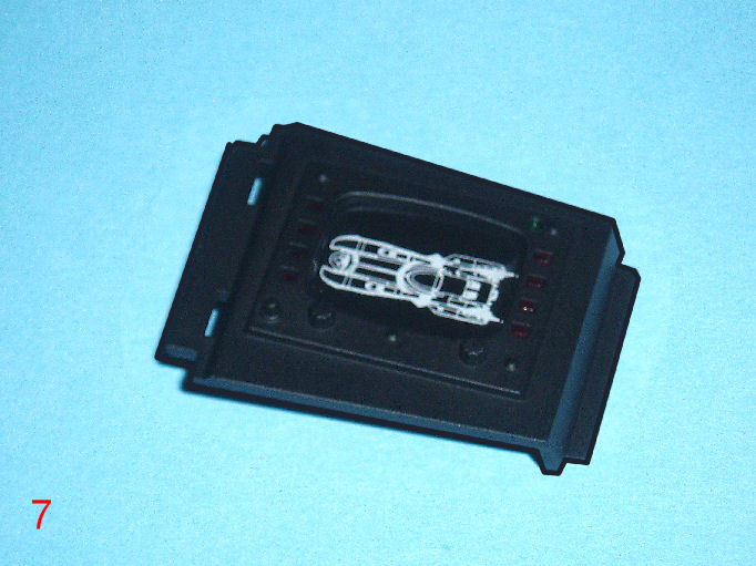

Pic 10: Fit the switches 4-20 inside the panel 4-19 as shown.

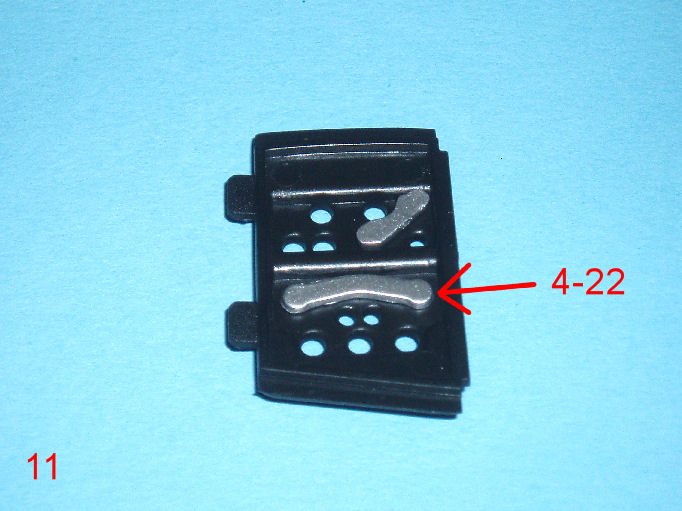

Pic 11: Fit the switches 4-22 in place.

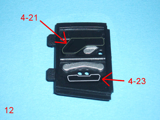

Pic 12: Fit the switches 4-21 and 4-23 in place. They have been outlined for clarity.
Pic 13: Fit the red light strip 4-24 in place as shown

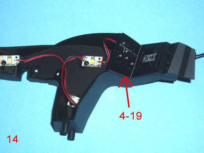

Pic 14: Push-fit the assembly onto the dashboard as shown.

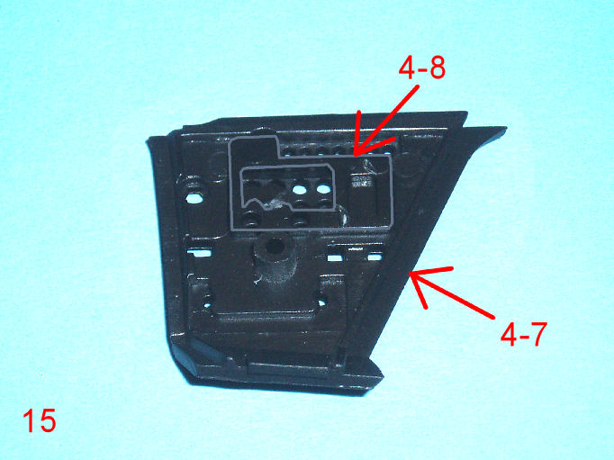

Pic 15: Fit the switches 4-8 in place on panel 4-7. They have been outlined for clarity.

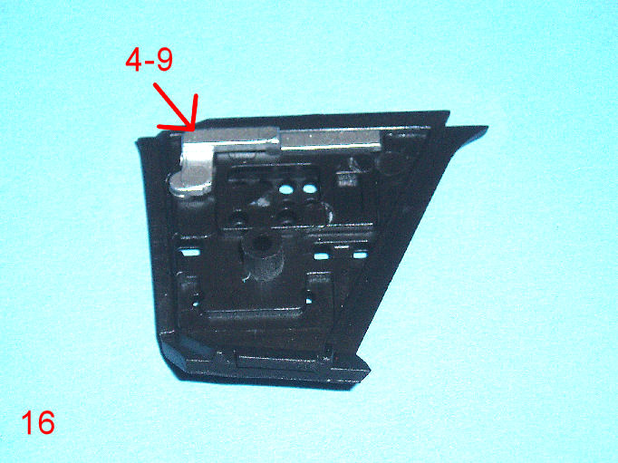

Pic 16: Fit the switch strip 4-9 in place.

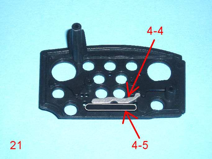

Pic 21: Fit the switches 4-4 and 4-5 in place. They have been outlined for clarity.

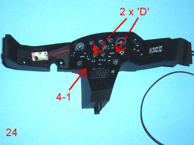

Pic 24: Fix the panel to the dashboard with 2 x ‘D’ screws from behind.

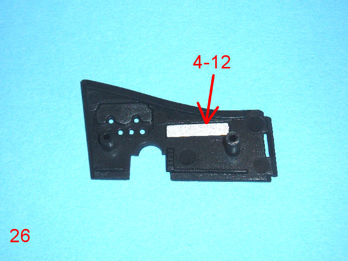

Pic 26: Fit the switch strip 4-12 in place.

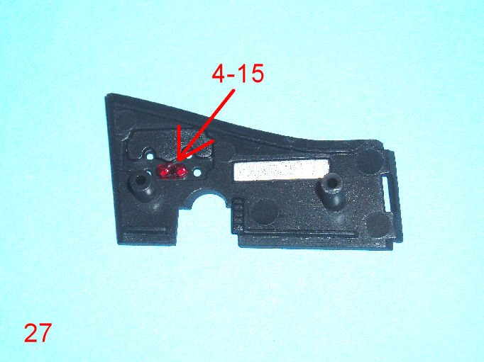

Pic 27: Fit the red lights 4-15 in place.

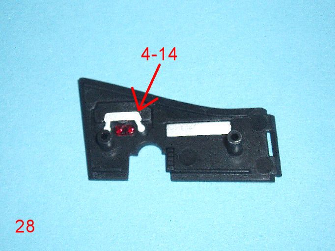

Pic 28: Fit the switch strip 4-14 in place.

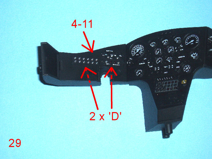

Pic 29: Fix the panel to the dashboard with 2 x ‘D’ screws from behind.

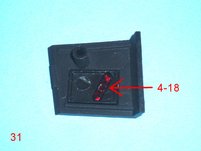

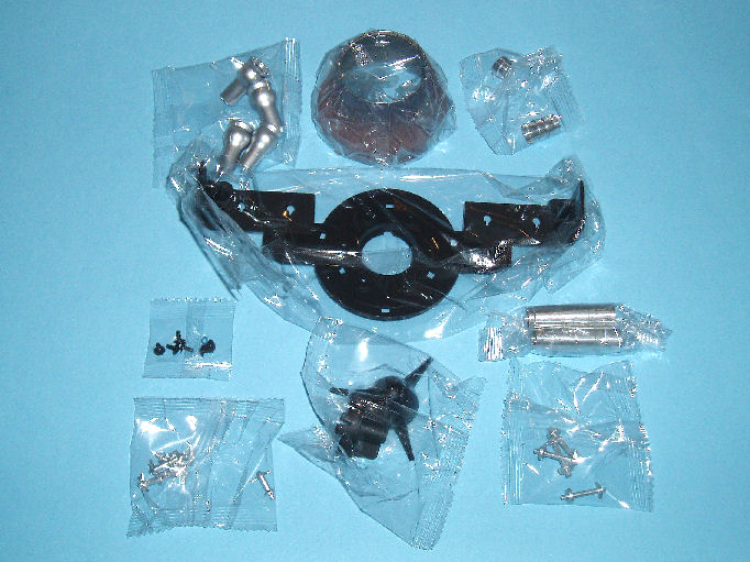

Pic 31: Fit the red lights 4-18 in place.
