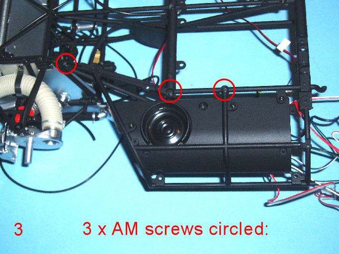

Pic 2: Fit the reinforcing bar 51A to the main frame as shown.
Pic 3: Holding the part in place, turn the model over and fix the parts using 3 x AM screws where indicated.

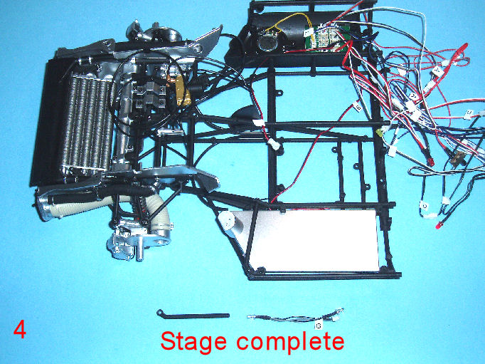

Pic 4: Gather together the wires ‘A’, ‘B’ and ‘G’.
Tape them together with masking tape as shown for now.
Pic 5: Gather together the wires ‘C’, ‘D’, ‘J’ and ‘K’.
Pic 6: Gather together the wires ‘E’, ‘F’, ‘H’ and ‘I’.

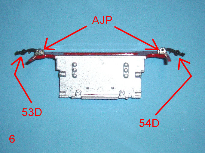

Pic 6: Fit 1 x retaining strap 43D into each of the lower brackets as shown. Fix from below with 1 x AJP screw in each.

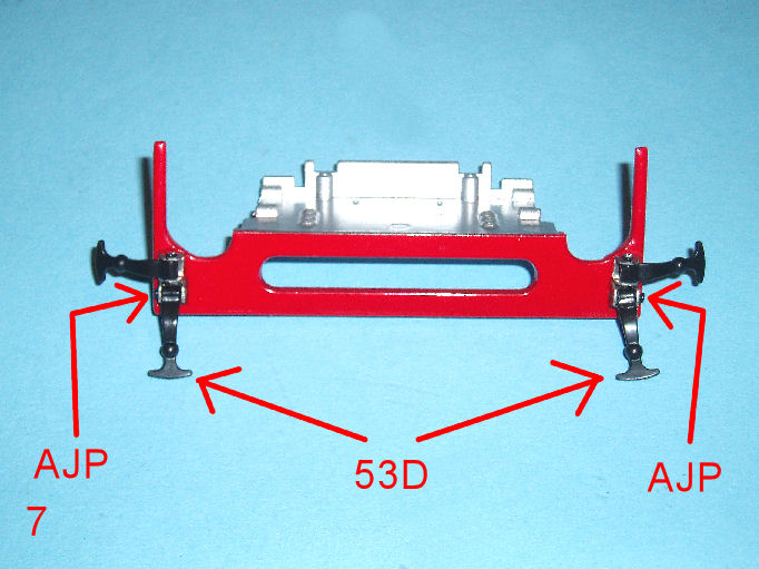

Pic 7: Fit 1 x retaining strap 43D into each of the other brackets as shown. Fix from the outside with 1 x AJP screw in each.

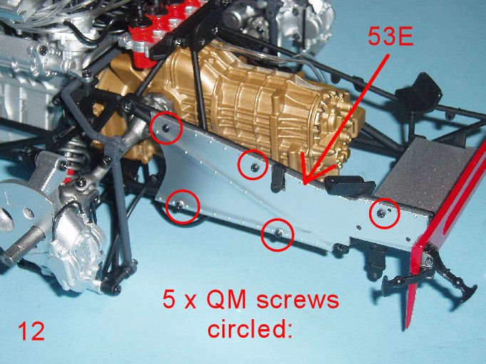

Pic 13: Store the model and unused panel safely for now.

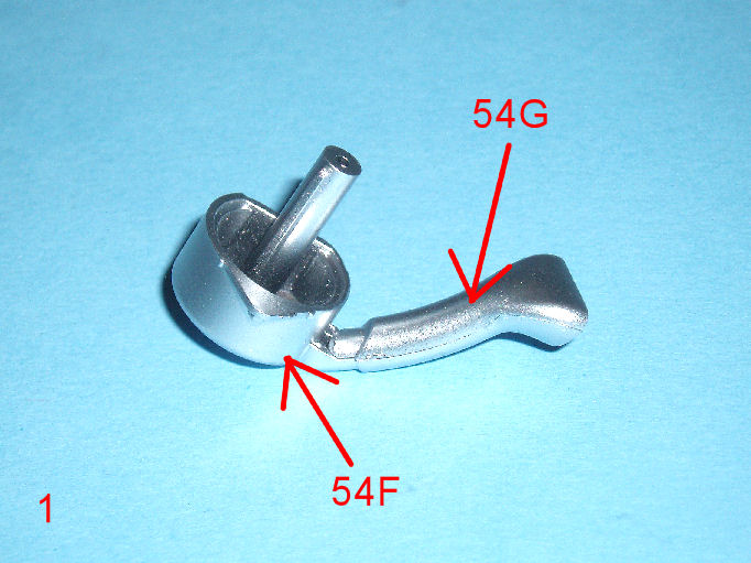

Pic 1: Fit the two alternator air intake parts 54F and 54G together.

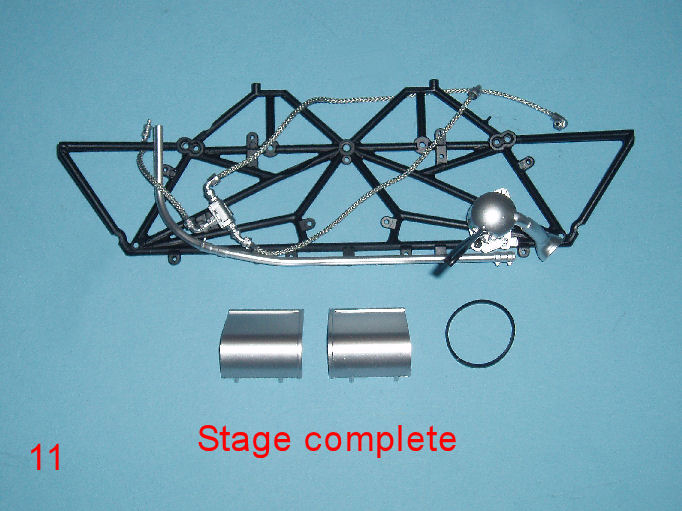

Pic 11: Store the parts safely.

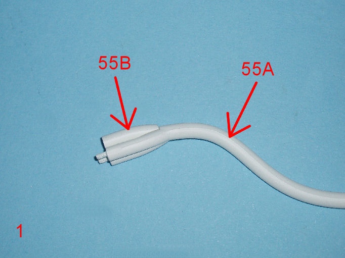

Pic 1: Press-fit the exhaust parts 55A and 55B together.

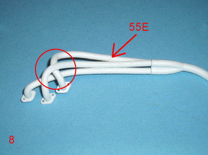

Pic 8: Press-fit pipe 55E into the hole in the end of 55A.
NOTE: The printed instructions incorrectly show 55E to go behind the other two pipes.
It must go between them as indicated otherwise the exhaust will not fit onto the engine later on.

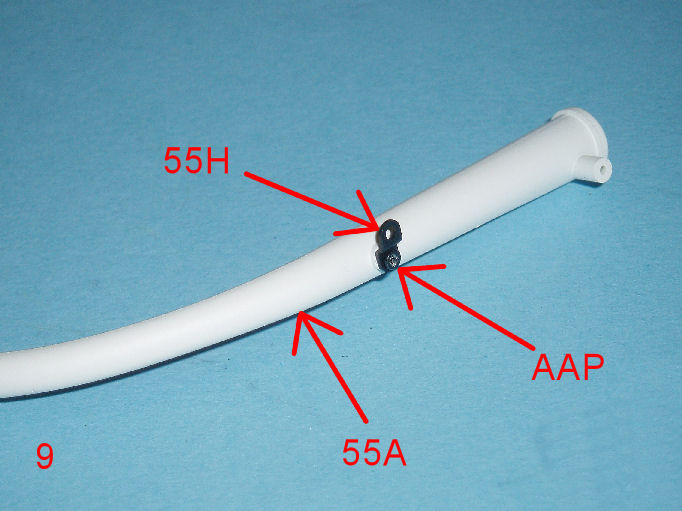

Pic 9: Fit the small bracket 55H to pipe 55A as shown and fix with 1 x AAP screw.
