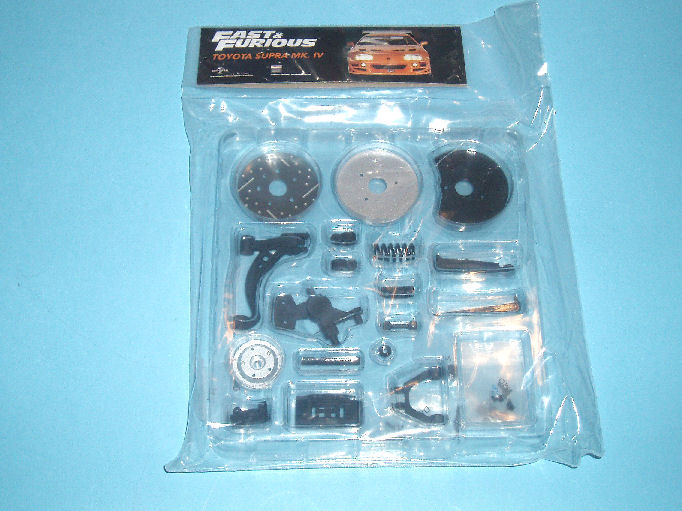

STAGE 15A:
Left front suspension.
Pic 1: Locate the shock absorber parts 15G, 15H, 15I and 15J.
They will fit together in the order shown.
Pic 2: Assemble the parts and fix with 1 x QM screw.
Pic 3: Fit the shock absorber to the lower arm 15 and fix with 1 x DM screw.
Pic 4: Fit the outer link 15Q as shown and fix with 1 x JM screw.
Pic 5: Fit the upper link 15F and fix with 1 x AM screw.
Pic 6: Locate the hub upright 15A and the brake back plate 15O.
Pic 7: Fit the parts together as shown and fix with 2 x QM screws.
Pic 8: Locate the disc parts 15K and 15L.

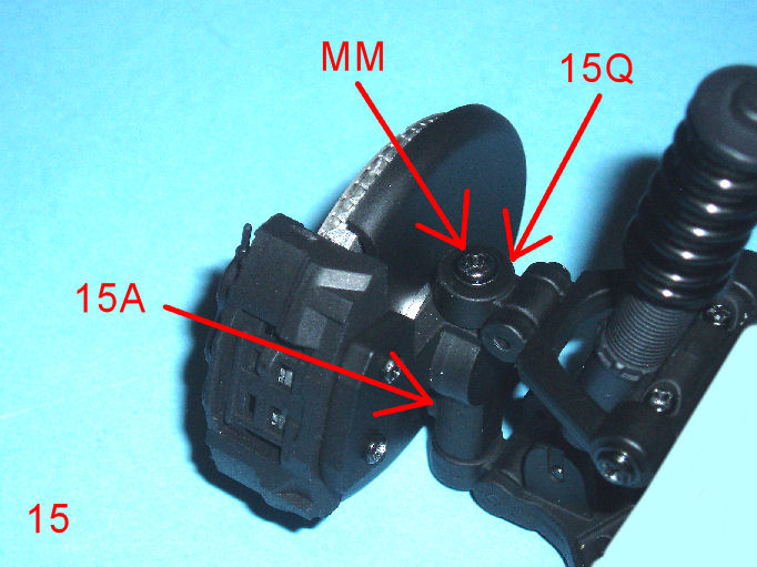

STAGE 15B:
Pic 9: Peel the backing paper from 15L and stick it to the front of 15K, aligning the holes and pins on the parts.
They will only fit one way.
Pic 10: Locate the hub parts 15N and 15P, and 1 x NM screw.
Pic 11: Assemble the disc and hub upright as shown, fixing the parts with the NM screw.

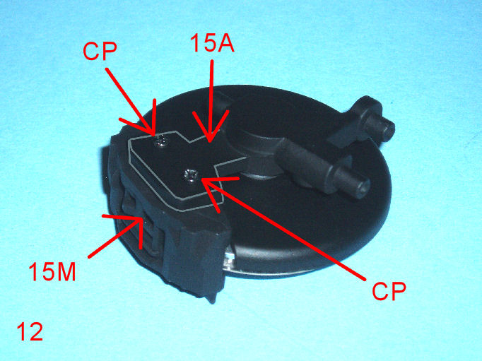

Pic 12: Turn the assembly over and fit the caliper 15M to the upright as shown, fixing it with 2 x CP screws.
Pic 13: Fit the tube 15E into the top link 15C and secure at each end with 1 x MM screw.
Pic 14: Fit the outer link 15Q and fix with 1 x JM screw.
Pic 15: Fit the assembly over the shock absorber and onto the upright as shown. Make sure the top link 15C has the word ‘TOP’ uppermost.
Secure with 1 x MM screw.

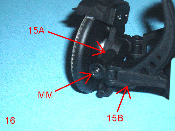

Pic 16: Fit the lower arm 15B to the bottom of the upright 15A and fix with 1 x MM screw.
Pic 17: Store all parts safely for now.

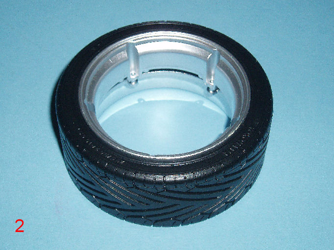

Pic 1: NOTE: The printed instructions suggest soaking the tyre 16A in hot water to soften it.
This is not necessary as the wheel parts fit easily enough with the tyre ‘cold’.
Press the wheel rim parts 16B and 16D into the tyre 16A.
Note the direction of the tread pattern in relation to the wheel parts.
Make sure the screw tabs inside are in line.
Pic 2: View from the other side.

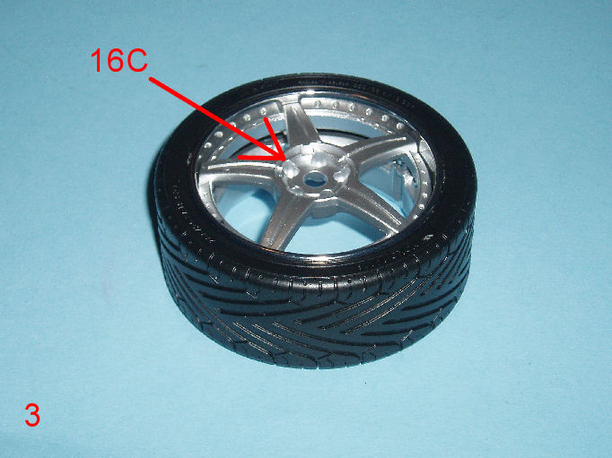

Pic 3: Fit the outer rim 16C in place, again making sure the screw fixing tabs and holes are all in line.
Pic 4: From the other side, fix all the parts together with 5 x ABM screws.
Pic 5: Store all parts safely for now.

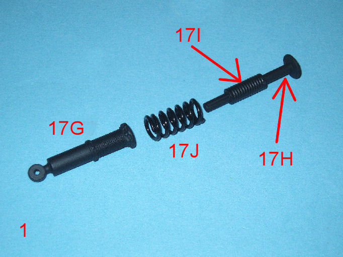

Pic 1: Locate the shock absorber parts 17G, 17H, 17I and 17J.

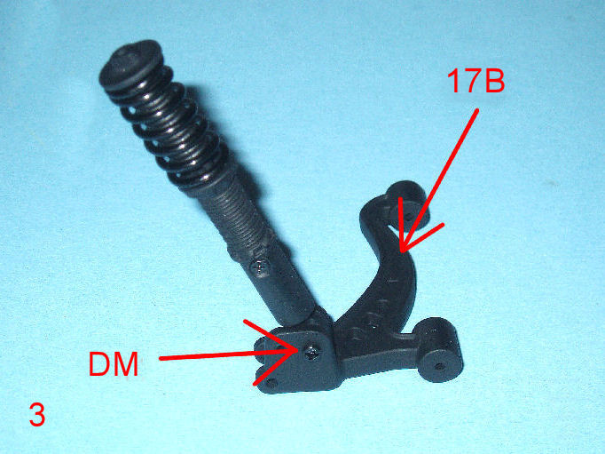

Pic 3: Fit the shock absorber to the lower arm 17 and fix with 1 x DM screw.

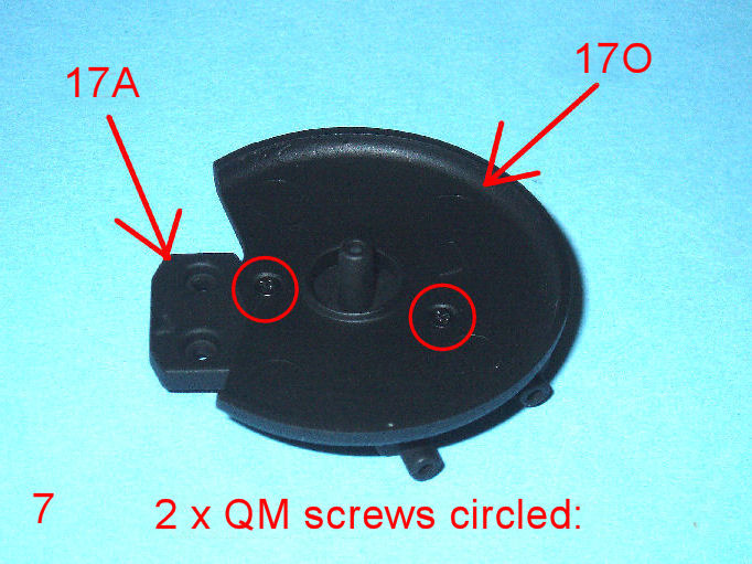

Pic 6: Locate the hub upright 17A and the brake back plate 17O.

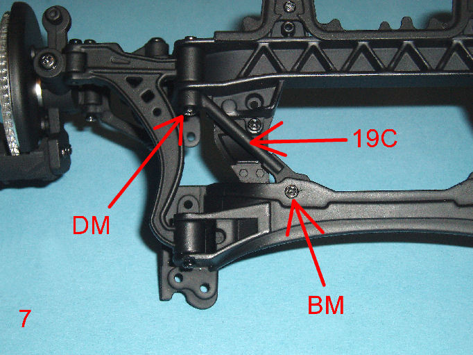

Pic 6: Fit the angled bracket 19B in place as shown and fix with 1 x DM screw at the front and 1 x BM screw on the cross member.
Pic 7: Fit the angled bracket 19C in place as shown and fix with 1 x DM screw at the front and 1 x BM screw on the cross member.
Store the assembly safely.
