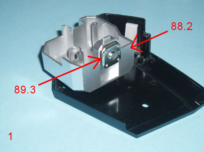

Pic 1: Fit the rotation joint 89.3 into the front leg assembly from the previous stage.
Pic 2: Fix from the other side with 4 x PWM screws.

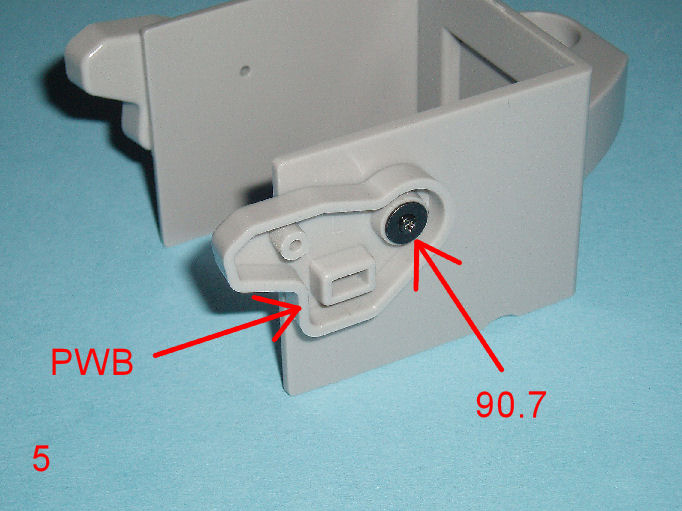

Pic 5: Fit the side connecting piece 90.7 in place as shown and fix with 1 x PWB screw.

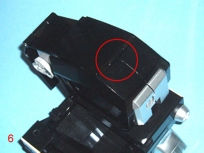

STAGE 91:
Mastodon back 3.
Pic 1: Retrieve the main assembly and twist the base through 90 degrees for better access to the grey joint post.
Pic 2: Once in this position, tilt the body section up and away from the base.
Pic 3: With the upper body out of the way, fit the spindle on assembly 87 into the joint post as shown.
Pic 4: Retrieve assembly 88 and locate the upper body 91.1.
The spindle indicated will fit in the hole on the body side panel.
Pic 5: Shows the parts fitted together.
Pic 6: Fit this assembly to 87 as shown, locating the opposite spindle on the upper body in the locating hole in the side panel.
Press the parts firmly together.
Pic 7: From the outside, fix the parts using 2 x PB screws.
Store safely for now.

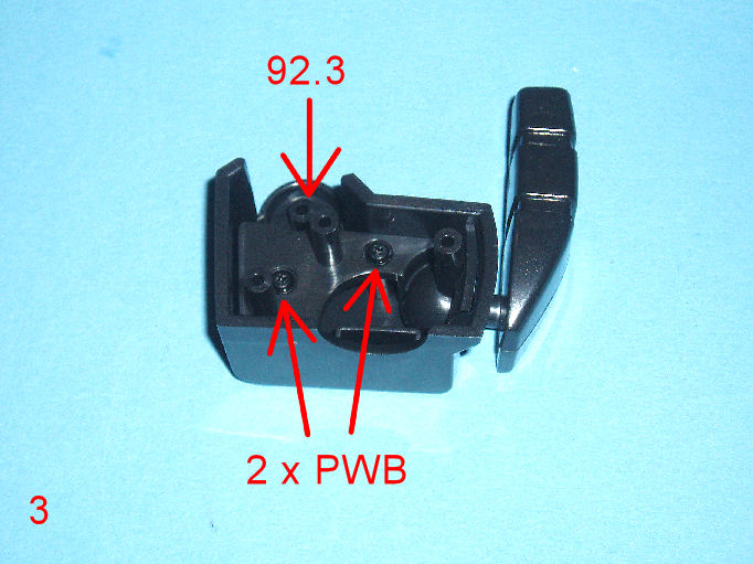

Pic 2: Fit the thumb into the hand housing 92.1 as shown and locate the cover 92.3 which will fit inside.
Pic 3: Fit 92.3 in place and fix with 2 x PWB screws.

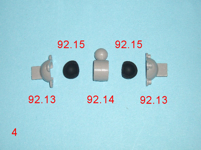

Pic 4: Locate all the joint parts 2 x 92.13, 92.14 and 2 x 92.15 and lay them in the order of assembly as shown.
Pic 5: Assemble the parts and fix together with 3 x PWB screws.

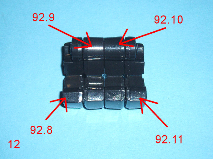

Pic 8: Press-fit the finger 92.11 and 92.12 (marked with a ‘2’) together as shown.

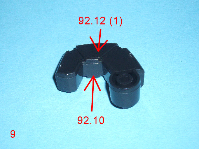

Pic 9: Press-fit the finger 92.10 and 92.12 (marked with a ‘1’) together as shown.
Pic 10: Press-fit the finger 92.9 and 92.12 (marked with a ‘2’) together as shown.

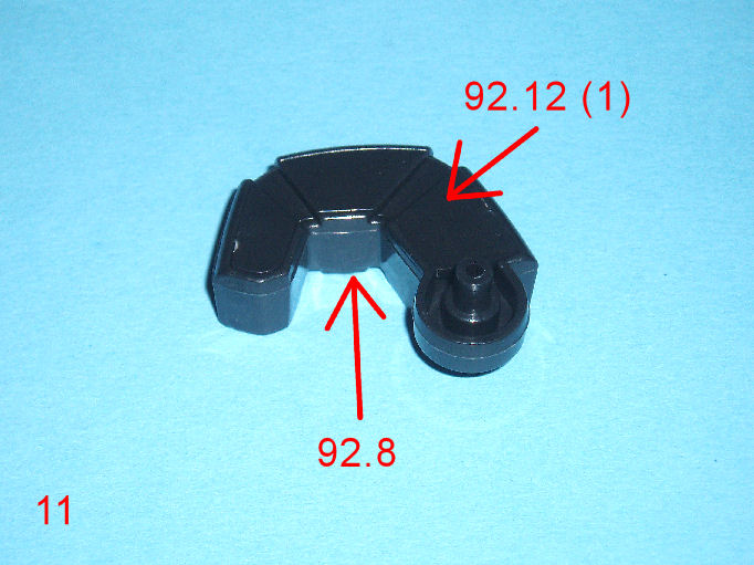

Pic 11: Press-fit the finger 92.8 and 92.12 (marked with a ‘1’) together as shown.
Pic 12: Press-fit the fingers together in the order shown.
Pic 13: Fit the fingers to the hand assembly as shown.

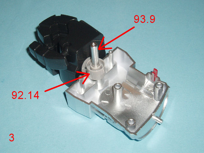

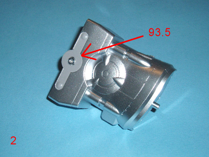

Pic 1: Fit the spindle 93.9 into the leg part 93.1 with the squared end going in first. Then slide the rubber sleeve 93.8 over the spindle.
93.1 is easily identified as it does NOT have two screw holes in the upper recessed area.
Pic 2: Fit the bracket 93.5 from the other side.
Pic 3: Retrieve the hand assembly from the previous stage and fit the joint 92.12 over the spindle 93.9.

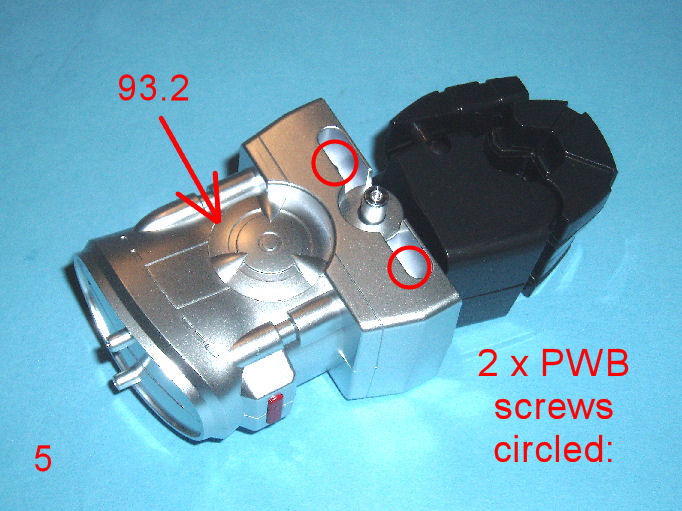

Pic 5: Fit the other leg part 93.2 in place and press the parts firmly together.
Fix using 2 x PWB screws.
Pic 6: Fit the outer bracket 93.5 as shown.

Pic 1: Retrieve the main assembly and lift the upper body panels to give access the inner body.
Swing the body sideways as shown.
Pic 2: Fit the outer cover 94.1 in place on the grey inner body bracket 90.7 and fix with 1 x KB screw.
Pic 3: Fit the leg assembly from stage 92 in place and fix with 1 x PM screw through the side panel.

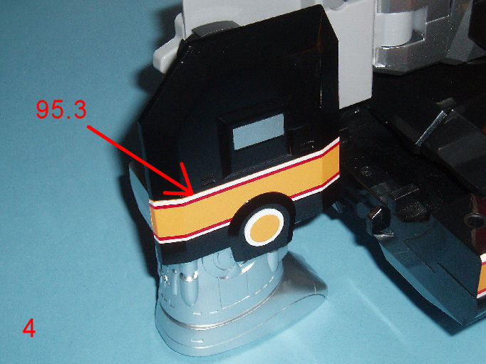

Pic 1: Press-fit the side trim 95.1 onto the body panel 87.1.
Pic 2: Press-fit the side trim 95.2 onto the body panel 88.1.
Pic 3: Press-fit the trim parts 95.3 and 95.4 in place on the side panel 94.1.
Pic 4: Press-fit the trim strip 95.3 onto the body panel 94.1.

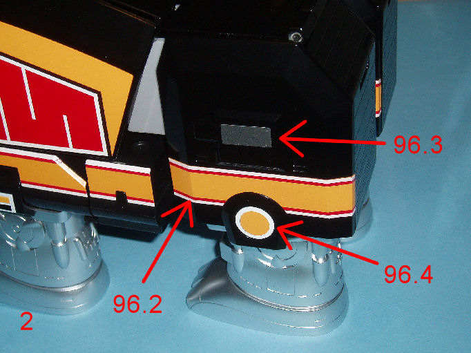

Pic 1: Fit the side panel 96.1 to the rear leg assembly from stage 93 and fix with 1 x KB screw and 1 x PM screw.
Pic 2: Press-fit the trim pieces 96.2, 96.3 and 96.4 in place as shown.
