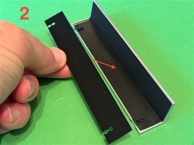

Place the two short rear floor mats (28D) behind the front seats, picture 2.

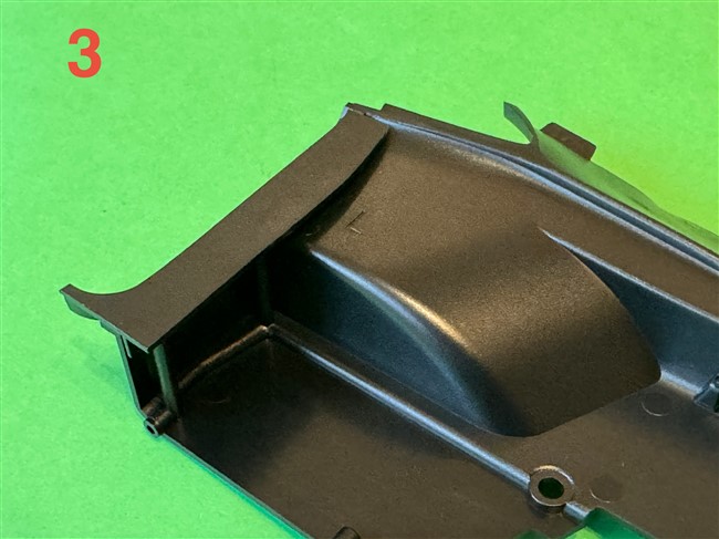

Fit the right-side rear mounting trim (29B) into the holes on the right rear panel, pictures 2 and 3.

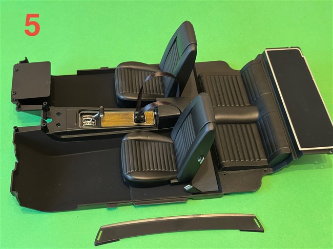

Retrieve the rear tray from issue 28 and fit it into the slots near its end onto the tabs on the right and left of the trim panel as shown in pictures 10 and 11.
Picture 12 shows the complete assembly for this issue.

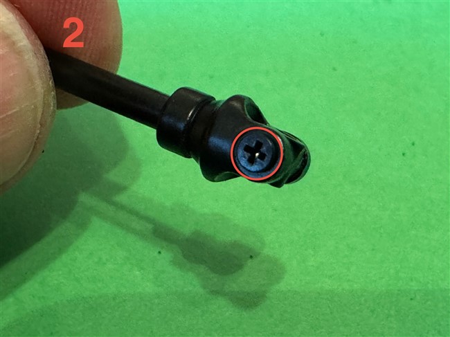

Begin by assembling one of the universal joint pivots (32D) into the end of the steering column shaft (32C) using 2 x H screws, pictures 2 and 3.

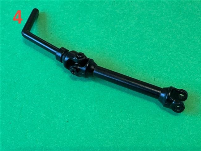

Fit the universal joint pivot you have just attached to the column shaft and attach to the steering column shaft 2 (32A) in the same way using 2 x H screws, picture 4.
