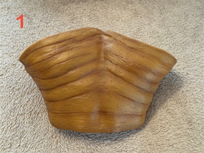

Picture 1 shows the contents of this issue and the previous part from the last issue.
As before when we glued the bottom body part to both the feet, I used some super glue with a brush adapter. This is easier to apply the glue along the seams for this process.

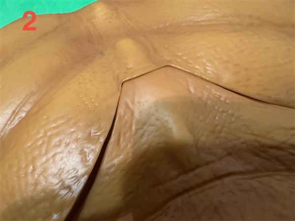

Patience is the key to piecing the parts together, bonding just a small section at a time, making sure that the area is dry before moving onto another small section. I started with the centre back area as this seemed the logical place to start, picture 2.

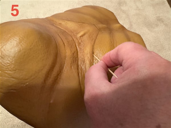

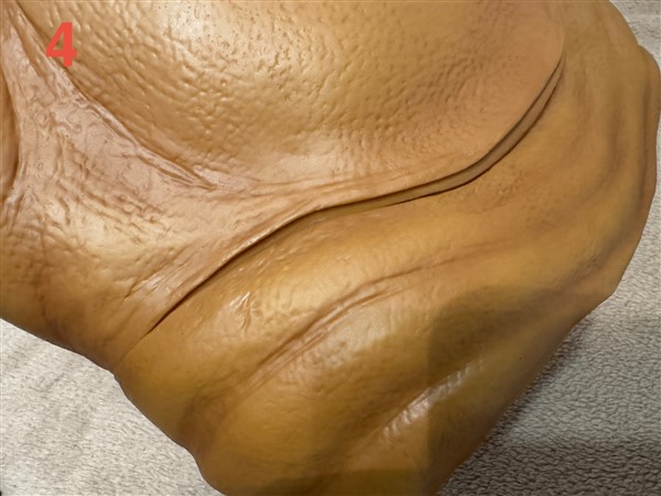

Gluing the whole two pieces took me around 40 minutes. When the body parts have been glued together, take the time to go around the bonding seam lines looking for any small gaps. I used a small toothpick to apply glue to these areas, pictures 3, 4 and 5.

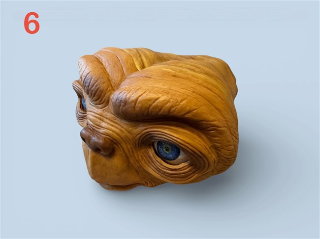

Picture 6 and 7 shows the complete assembly for this issue.

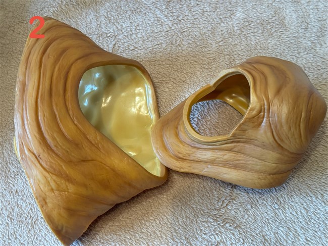

Picture 2 shows the complete assembly for this issue.

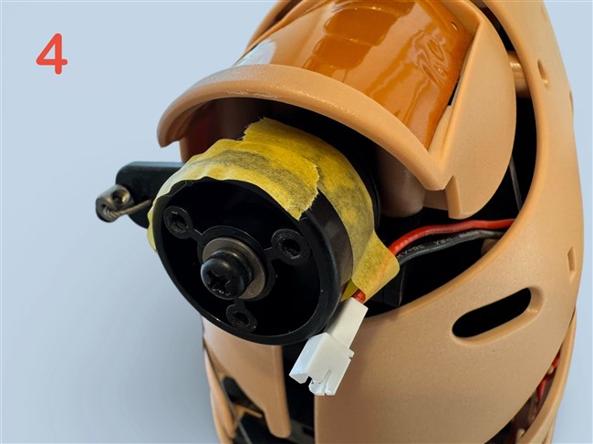

Take the head and using a screwdriver make half a turn on the motor screw only if it is too tight. The screw needs to be tight but not over tight, picture 4.

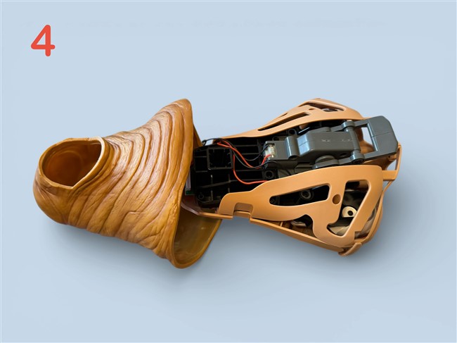

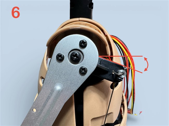

On the left arm, unscrew the adjustor, picture 5, so the arm pivot is at an angle as shown in picture 6 rather than 90 degrees.

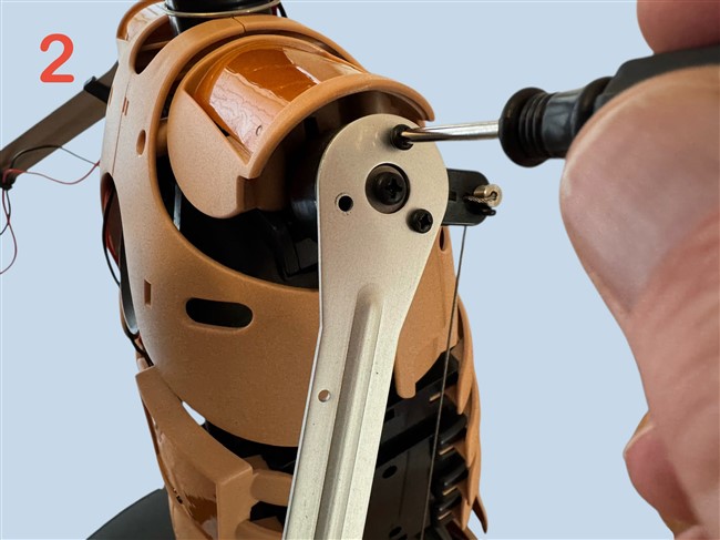

Start by unscrewing the left arm, picture 2. Do the same with the right arm, disconnecting the power cable as shown in picture 3.

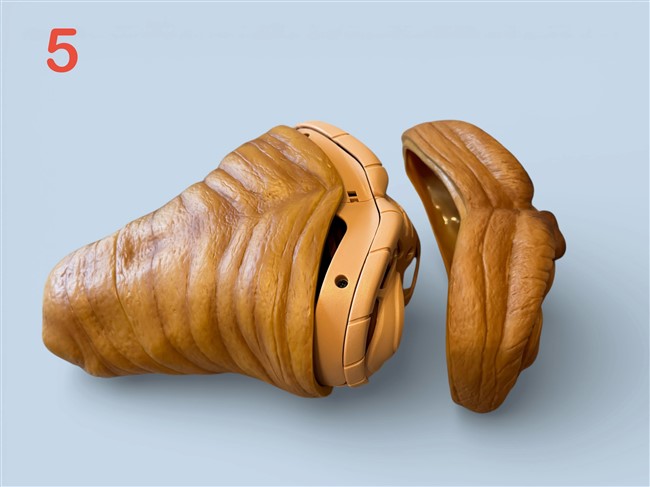

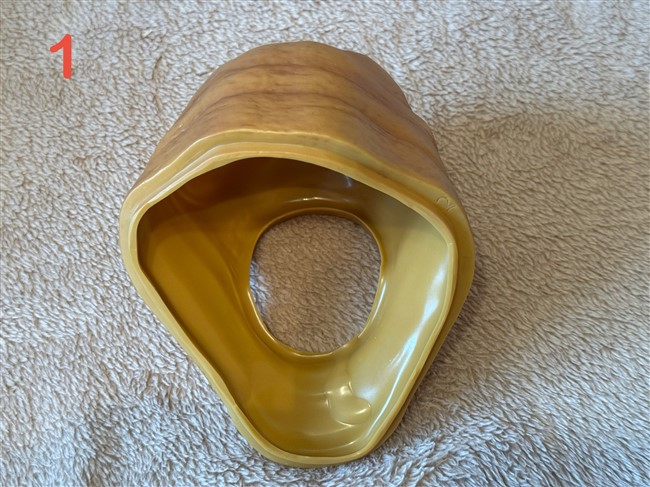

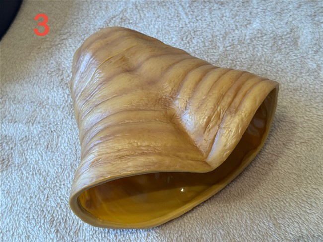

As before, glue the two back head skin sections together, pictures 2 and 3. Take the time to go around the bonding seam lines looking for any small gaps. I used a small toothpick to apply glue to these areas.
Insert the finished head from issue 20 into the skin as shown in picture 4. Now place the face skin over the front and glue it to the rear head skin in the same way as you have done with all the other body parts, pictures 5 and 6.

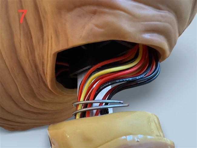

Once the glue is dry, place the head onto the neck frame. Connect the cable from the neck to the connector inside the head, taking off the tape that held it in place. You will need to pull the skin back to access the connector for this operation, picture 7.
