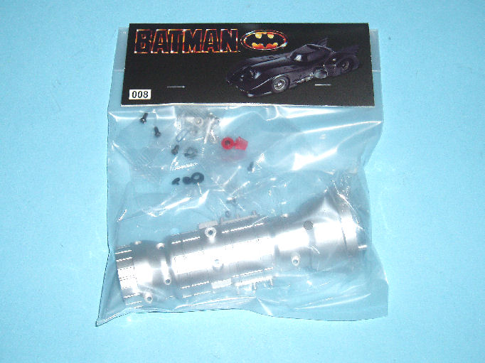

STAGE 8:
Turbine engine 4.
Pic 1: Retrieve the turbine assembly and fit the 2 x oil filter tubes 8-2 as shown and fix from the other side with 2 x ‘E’ screws.
Pic 2: Fit 2 x filter base 8-5 as shown.
'E' screws fitted in step 1.
Pic 3: Fit 2 x filters 8-3 as shown.
Pic 4: Fit 2 x filter covers 8-6 as shown.
Pic 5: Fit 2 x filter caps 8-4 as shown.
Pic 6: Fit the assembly to the lower housing 8-1 as shown.
Pic 7: Fix from the other side with 2 x ‘D’ screws.
