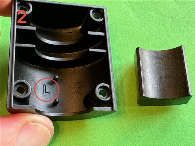

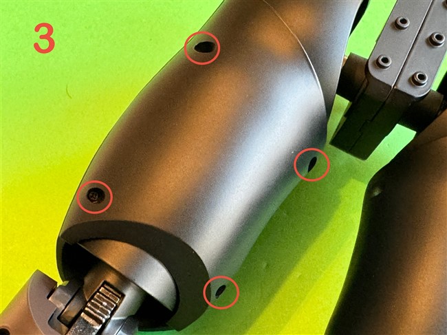

Issue 31
The Leg Assembly
Take the left mounting cover (31A), the one with an ā€œLā€ printed inside and place the left support block (31C) inside, picture 2.
Retrieve the leg assembly you built in issue 13 and the hip assembly from issue 21. Place the leg assembly into the hip assembly at the knee joint and place the cover assembly over the joint securing it place using 4 x GM screws, pictures 3 and 4.
Place the right block support into the front cover, picture 5, and repeat the process again as you did with the left side, picture 6.
