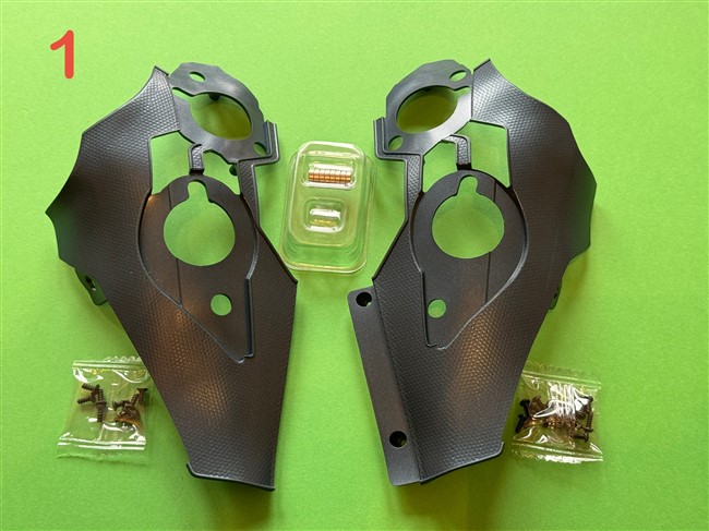

Start by putting together the two blue back plates using 2 x E screws to secure them in place, picture 2.
Carefully separate the magnets and insert an ā€œIā€ type screw as shown in picture 3. Place all eight magnets by screwing them into position as illustrated in picture 4. Note: Do not over tighten the screws as the magnets are quite brittle and may break.
Next, fit the blue plate in place on the back, picture 5. Turn the assembly over and secure it in place using 14 x E type screws as shown in picture 6.

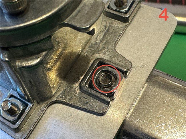

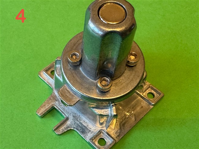

Insert one of the shock absorbers (they are both the same) into the number two leg support, picture 2. Prepare four J bolts and place a washer on each one, picture 3.
Using an allen key, screw the four bolts so the shock absorber is secured to the support, picture 4.
Insert one of the magnets inside the shock absorber, noting which way around it sits, picture 5, then one of the rubber dampers over the magnet inside the shock absorber. Fix the assembly to the support by using 4 x J bolts and washers as before, picture 6.

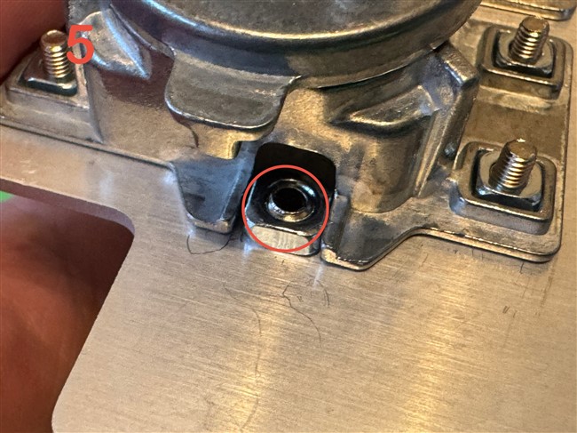

Prepare four H bolts with a washer, picture 8.
Now place the supports onto the support plate, picture 9. Each support will have a number on it to show which support is which. Insert an M4 nut into the top corner of the support as illustrated in picture 10, turning the assembly over and fixing the bolts to the nuts, picture 11.
Picture 12 shows the completed assembly for this issue.

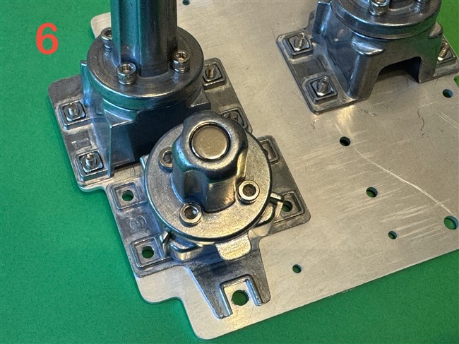

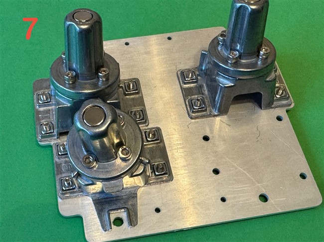

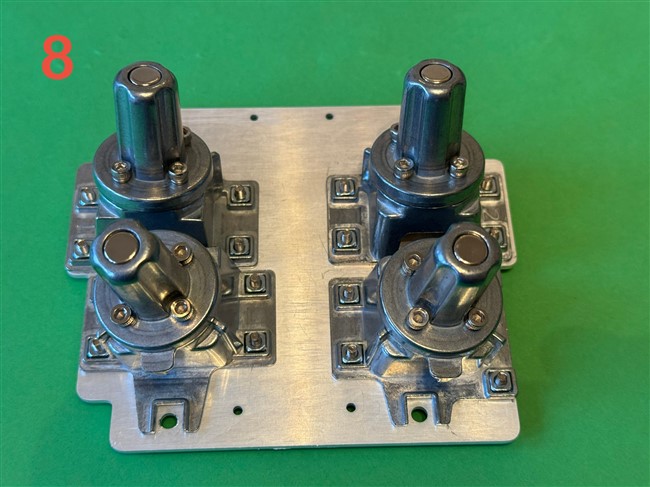

The Spider Leg Supports
Insert one of the shock absorbers (they are both the same) into the number three leg support, picture 1. Prepare four J bolts and place a washer on each one, and using an allen key, screw the four bolts so the shock absorber is secured to the support, picture 2.
Insert one of the magnets inside the shock absorber, noting which way around it sits, picture 3, then one of the rubber dampers over the magnet inside the shock absorber. Fix the assembly to the support by using 4 x J bolts and washers as before, picture 4.
Do the same with the number four support, picture 5.
Prepare four H bolts with a washer as you did before in the previous issue.
Now place the number 3 support onto the support plate, picture 6. Each support will have a number on it to show which support is which. Insert an M4 nut into the top corner of the support, then turning the assembly over and fixing the bolts to the nuts, picture 7.
Do the same with the fourth support.
Picture 8 shows the completed assembly for this issue.

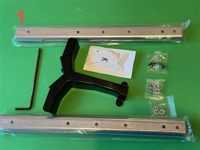

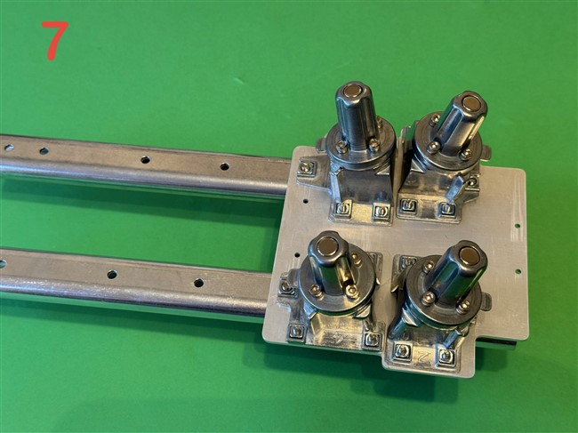

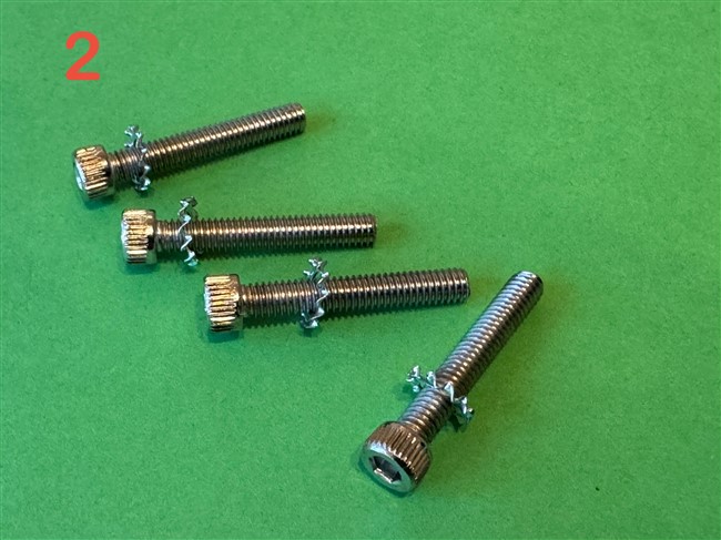

Issue 50

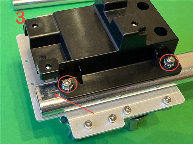

Prepare four of the type K bolts by threading a serrated washer on each, picture 2.

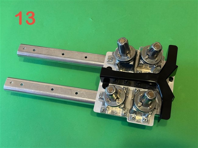

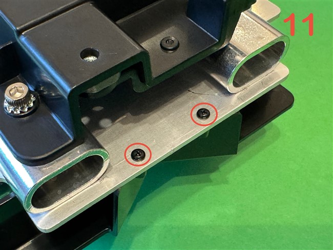

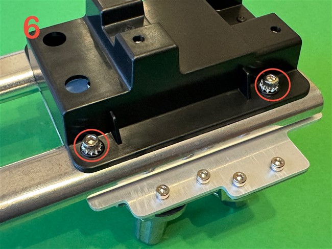

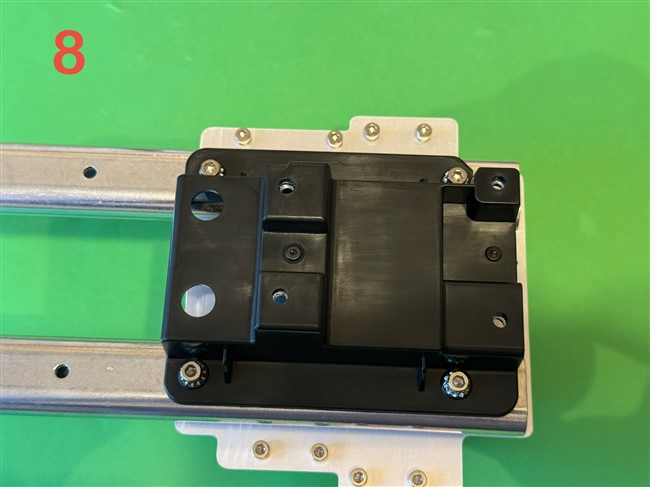

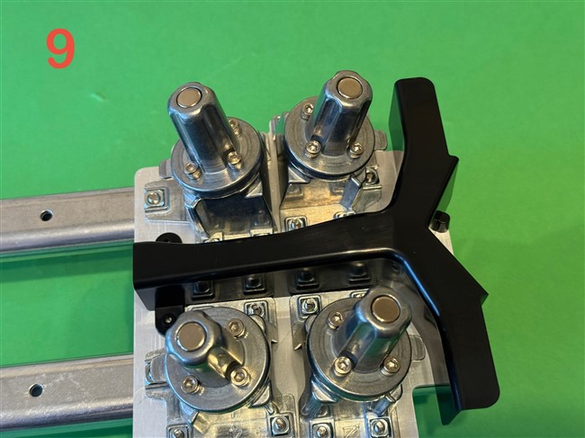

Retrieve the assemblies from the previous issue and issue 47. Place the structure from issue 47 one of the two bars that came with this issue and position the hole at the top of the bar, next to the arrow point upwards. Place the bottom of the bar onto the flat side of the support plate and place one of the prepared bots as shown in picture 3. Turn the assembly over and place 2 x M4 nuts as shown in pictures 4 and 5, tightening the bolts into the to secure the structure.
Do the same with the second bar as illustrated in pictures 6, 7 and 8.

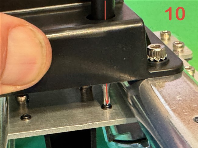

Push the fixed connector into position as shown in picture 9, then turn the assembly over and secure this in place using 4 x E screws, pictures 10 and 11. Note: Picture 10 shows that two of the screws need to be threaded through two holes on the back of the structure from issue 47.
Pictures 11 and 12 show the completed assembly for this issue.
