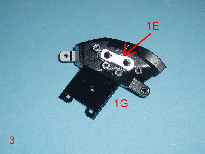

STAGE 1:
Hood and headlights.
Pic 1: Locate the light body 1F and the light unit 1D.
Pic 2: Fit the light unit into the back of the light body as shown.
It will only fit one way.
Pic 3: Assemble the other light with parts 1E and 1G in the same way.
Pic 4: Store your parts safely for now.
