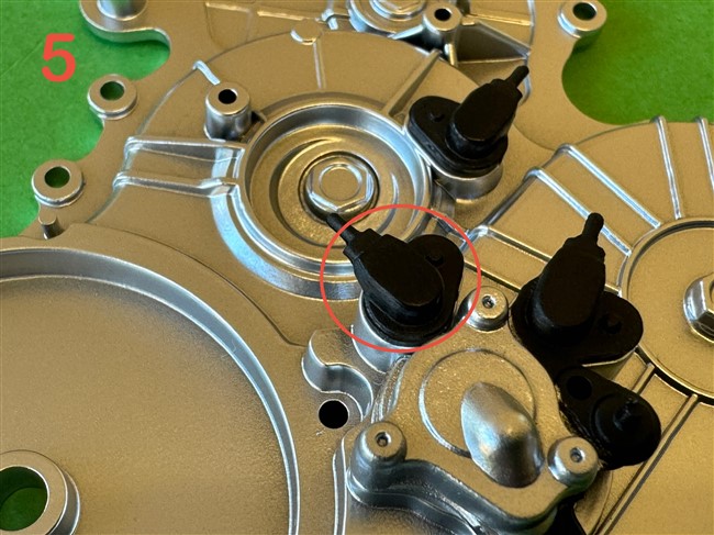

Place the engine cover (14A) onto a flat surface then place sensor 1 (14A) into position, pictures 2 and 3. Take the sensor 2 (14D) and place it into the slot as shown in picture 4, then place the other sensor 3 (14C) in place, picture 5.
Picture 6 shows the complete assembly for this issue.
