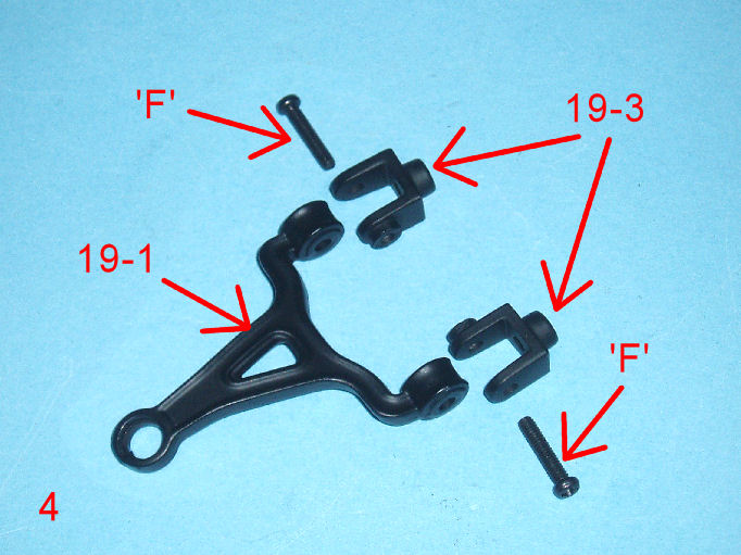

Pic 4: Assemble the lower swing arm 19-1 and 2 x brackets 19-3 fixing them from the outside with 2 x ‘F’ screws.
Pic 5: Parts assembled.
