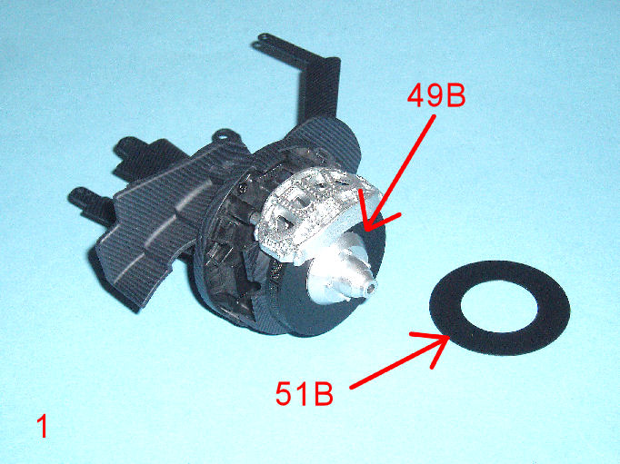

STAGE 51:
Rear left suspension 8.
Pic 1: Retrieve the assembly from the previous stage and locate the outer disc 51B.
Pic 2: Peel the backing from the disc 51B and press it into place on the disc 49B as shown.
Pic 3: Store all parts safely for now.
