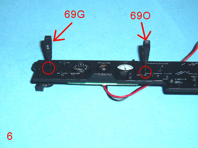

Pic 6: Press-fit the control stalks 69G and 69O into the locating holes in the dashboard where shown.

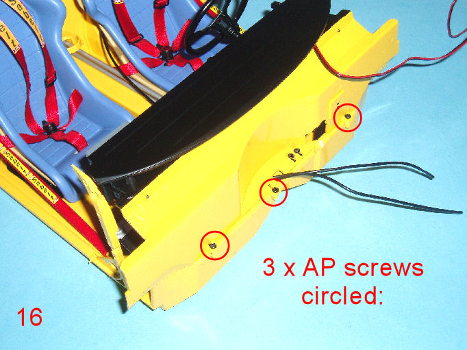

Pic 16: Fit the dashboard assembly in place with the two cables passing through the small rectangular opening.
Fix the parts with 3 x AP screws.

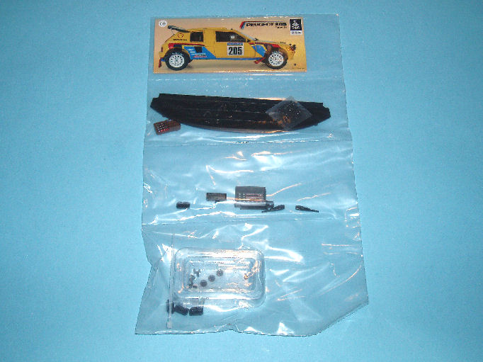

STAGE 70:
Lower left fuel tank.
Pic 1: Cut the wire 70E into 5 x 60mm pieces.
Pic 2: Position the mesh 64H at the rear of the roll cage as shown, in an ‘L’ shape.
Using the 5 x wires, fasten the mash at the upper edge to the roll cage where indicated, twisting the wires to secure them.
Pic 3: Cut off the excess wire.
Pic 4: Retrieve the main car assembly and place it upside down.
Fit the fuel tank part 70B in place as shown.
Pic 5: From the other side, fix the tank using 4 x AP screws where indicated.
Pic 6: Fit the fuel pipe 70C into the slot at the end of the tank part 70A.
Pic 7: Fix the cover 70D in place with 2 x AP screws.
Store everything safely for now
