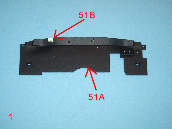

STAGE 51:
Firewall panel.
Pic 1: Press-fit the relay 51B into the locating hole on the upper left of the firewall 51A as shown.
Pic 2: Fit the brake pump 51C into the locating hole on the upper right of the firewall and fix from behind with 1 x CP screw.
Pic 3: Retrieve the main assembly and connect the orange tube 51D to the front pin on the small circular chrome fuel filter as indicated.
Pic 4: Detail the connected tube.
