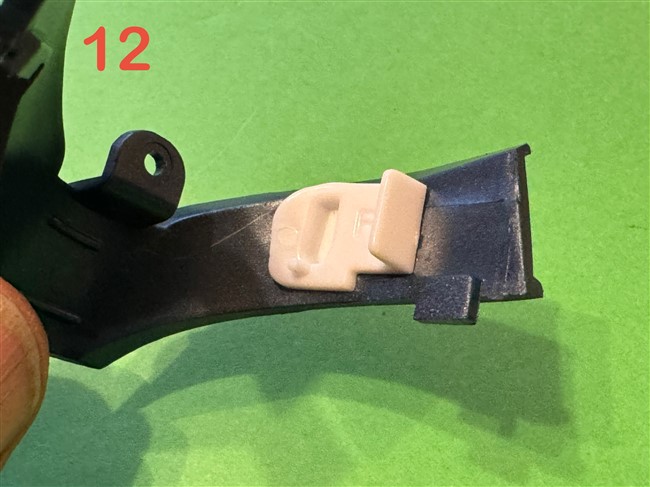

Issue 61 Part 2
The Right Leg
Position the right LED cover inside the blue shin plate, picture 12. Place the assembly over the right shin frame and secure using a type E screw, picture 13. Next, fit the upper gold detail, securing it from the inside with 2 x type F screws, pictures 14 and 15.
Take the calf assembly and fit it to the right leg, securing it using 2 x type G screws, pictures 16 and 17. Now attach the shin piece to the leg, securing it in place using 2 x type G screws, pictures 18 and 19. Finish the assembly with two type E screws at the rear of the leg, picture 20.
