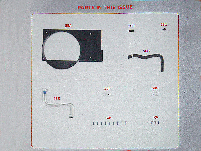

STAGE 58A:
Radiator 2.
Pic 1: Retrieve the radiator from the previous stage and locate the shroud 58A.
Pic 2: Fit the shroud as shown and fix with 4 x CP screws.
Pic 3: Fit the LED strip 42C over the shroud as shown and fix with the press-fit clips 58B and 58C.
Pic 4: Fit the brackets 58F and 58G as shown.
Pic 5: Temporarily remove the horn 20D from the chassis frame.

#6 Posted : 16 April 2026 10:06:24
Posts: 5,816
Points: 17,600
STAGE 58B:
Pic 6: Fit the radiator assembly in place, starting with the relay as indicated.
Pic 7: Fix from underneath with 3 x CP screws.
Pic 8: Attach the blue and orange hoses as shown.
Pic 9: Fit the air conditioning radiator 57A in place and fix with 2 x KP screws.
Pic 10: Re-fit the horn 20D.
Pic 11: From underneath, fit the hose 58D locating the blue end on the radiator and the other end on the black fitting just behind the alternator.
Pic 12: Fit the top hose 58E in place as shown.
The angled engine end should be fitted to the thermostat housing after fitting the blue radiator end.
Store the model safely.
