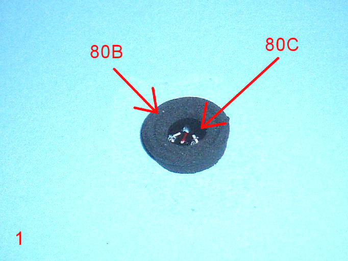

Press-fit the gauge 80C into the surround 80B from behind.
Pic 2: Fit the assembly into the underside of the cowl 80D as shown.

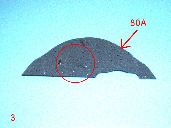

Pic 3: Press-fit the assembly into the top of the dashboard 80A as shown.

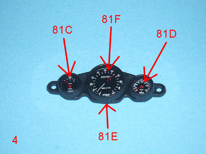

Pic 4: Fit the gauges 81C, 81F and 81D into the surround 81E.
NOTE – These parts are a loose fit and will very probably fall out so a small amount of clear adhesive such as UHU might be advisable.

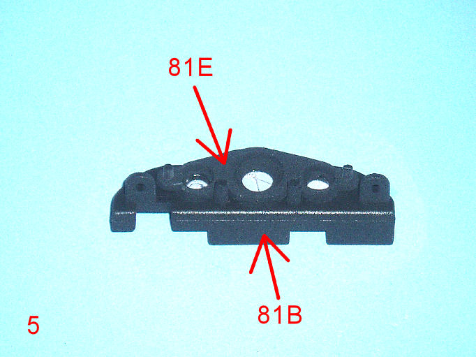

Pic 5: Press-fit the assembly onto the frame 80B.

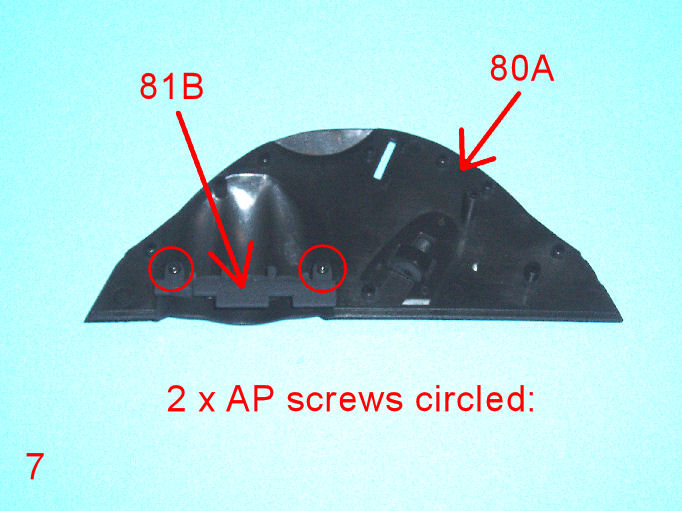

Pic 6: View from the front.
Pic 7: Fit the assembly to the underside of the dashboard and fix with 2 x AP screws.

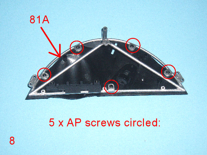

Pic 8: Fit the frame 81A in place as shown, noting the front bar locates under the gauge assembly.
Fix with 5 x AP screws

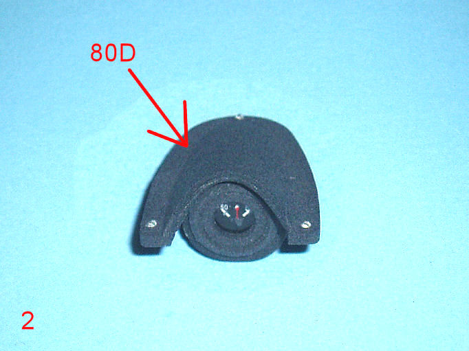

Pic 1: Press-fit the ignition switch 82H into the dash panel 82A.
It will only fit one way.
Pic 2: Press-fit the 6 x 82D switches in place where shown.
They will only fit one way.
Fit the collar 82F onto the end of the switch 82G, and then fit the assembly into the top hole on the dashboard where shown.
Press-fit the choke knob 82E in place as shown.
Pic 3: Fit the gauge 82J into the surround 82L and then fit the assembly into the dashboard.

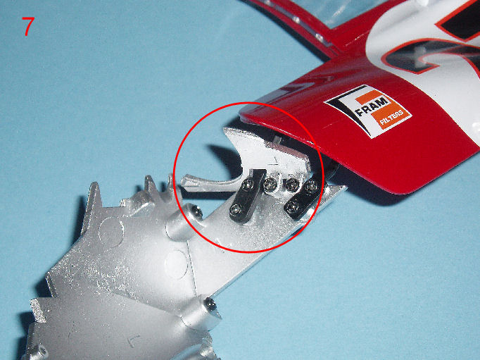

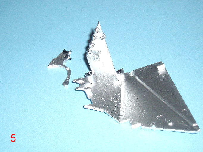

Pic 4: Retrieve the left front panel assembly and remove the highlighted bracket indicated.
Do not lose the screws.
Pic 5: Bracket removed.
Pic 6: Fix the door hinges to the bracket where shown using 4 x AM screws.
Make sure the screws are fully tight so the door will not ‘wobble’.
Pic 7: Re-fit the bracket that you removed.

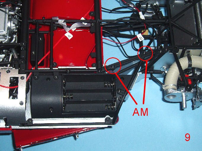

Pic 8: Retrieve the main car.
The front panel attached to the door hinges will fix onto the chassis frame where indicated.
Pic 9: Wiggle the panel into place and then turn the model upside down.
Fix the panel to the frame using 2 x AM screws.

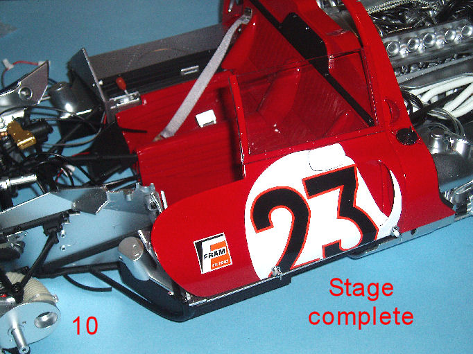

Pic 10: With the car the right way up, close the door.

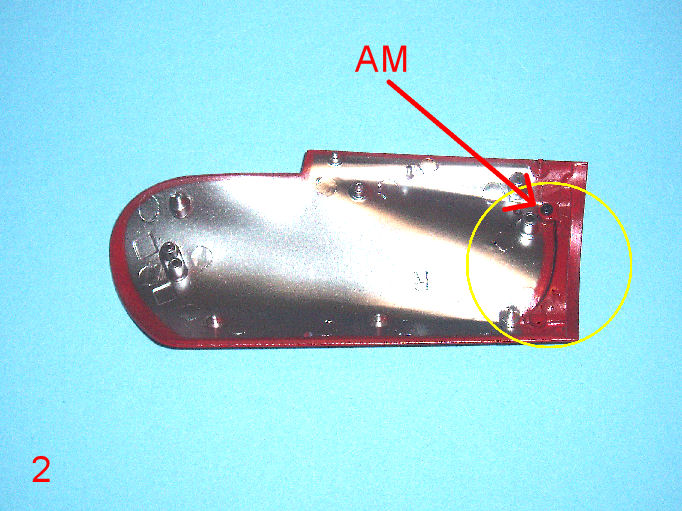

Pic 2: Fit part 86B in place on the end of the door inside, as indicated in yellow.
Fix with 1 x AM screw.
