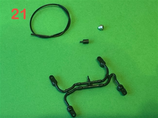

Issue 21
This issue is quite fiddly and will need a bit of patience when fitting the heat protection sheets.
You get four sheets for this process. I did mine using two sheets, but feel free to cover the part differently if you need more than the two, I used. I started at the back of the lower intake box and had the sheet to just one side, so it covered the top, front and back using the double-sided tape to stick the foil to the part, pictures 2,3 and 4.
I then used the second sheet in the same way, so it covered the opposite side, picture 5. Once you have covered the lower intake box, using a craft knife carefully cut away the excess and the two holes as shown in picture 6.
Retrieve the engine assembly and place the lower intake box between the head area, securing it in place using 6 x BP screws as illustrated in picture 7.
Picture 8 shows the assembly complete for this issue.

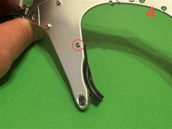

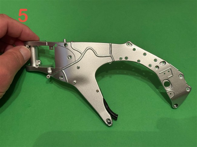

Issue 26
Fit the carbon component to the left frame section using an AP screw, pictures 2,3 and 4.
