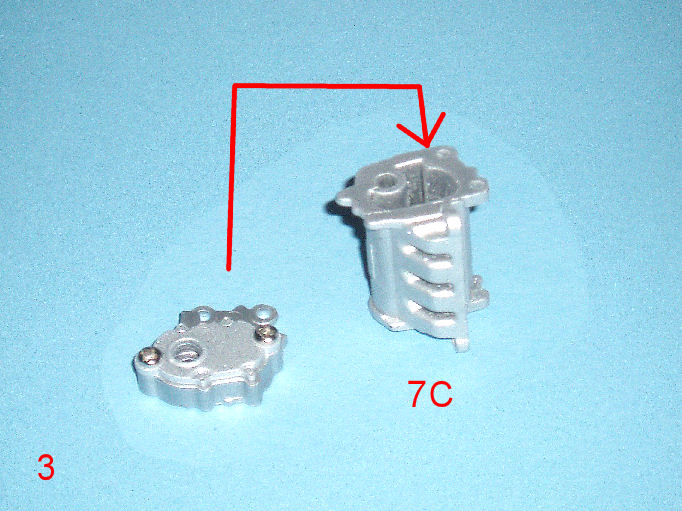

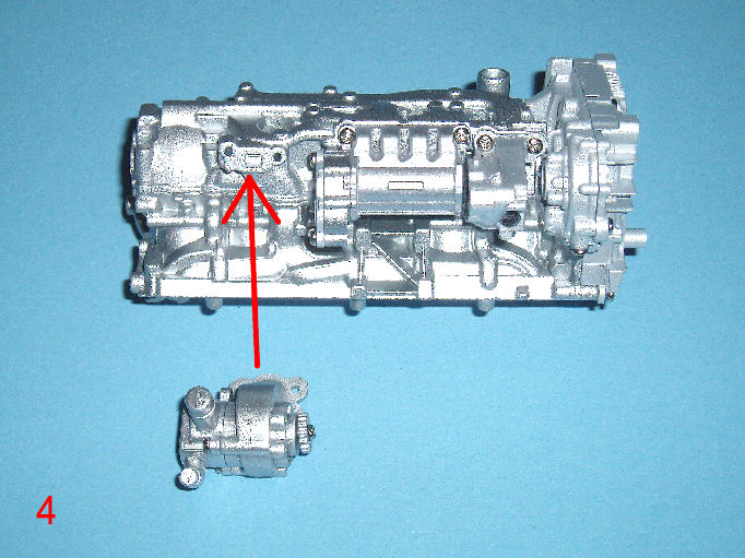

STAGE 7A:
Engine components.
Pic 1: Locate the oil pump parts 7A and 7B.
7A will fit on top of 7B.
Pic 2: Fix together with 2 x F screws.
Pic 3: The assembly will fit on top of pump part 7C.
Pic 4: Fix together with 2 x F screws.
Pic 5: Retrieve the engine from the previous stage.
The assembled oil pump will fit where indicated in red.

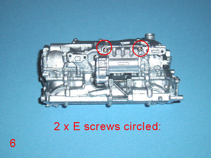

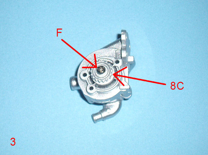

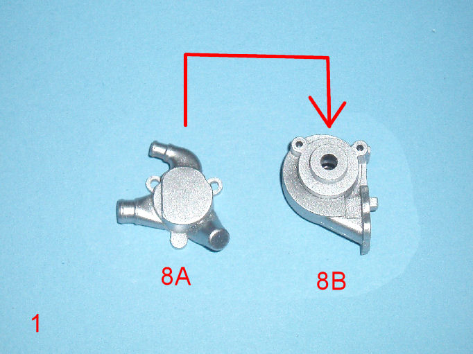

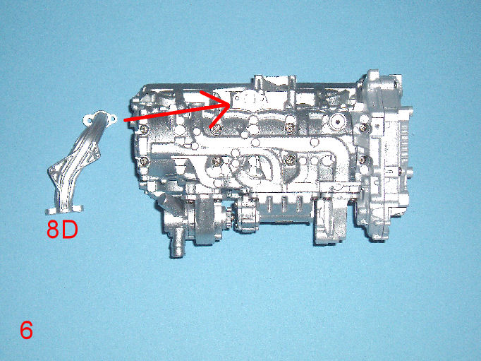

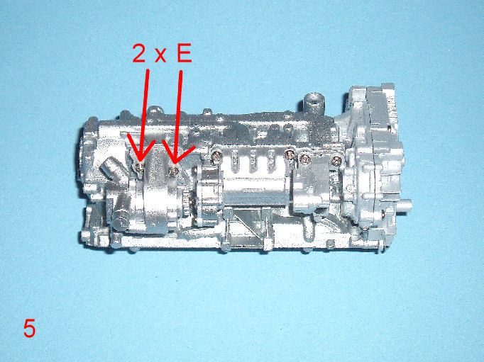

STAGE 8A:
Coolant pump.
Pic 1: Locate the pump parts 8A and 8B.
They will fit together as indicated.
Pic 2: Fix the parts with 2 x F screws.
Pic 3: Fix the gear 8C with 1 x F screw.
Pic 4: The pump will fit to the engine where indicated.
Pic 5: Fix with 2 x E screws.
Pic 6: The coolant hose 8D will fit where sho
wn.
#5 Posted : 03 May 2026 12:20:36
Posts: 5,829
Points: 17,639

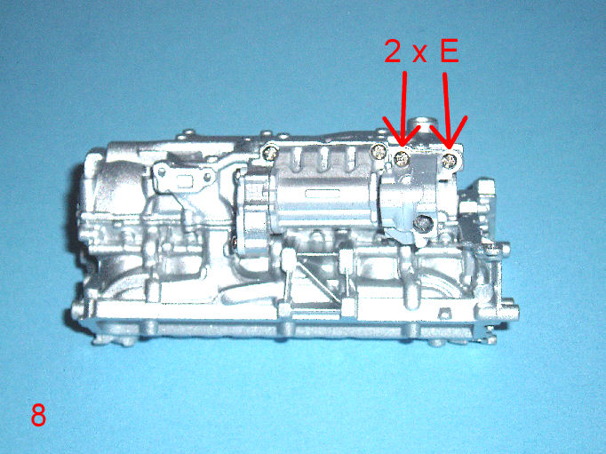

STAGE 8B:
Pic 7: Fix with 2 x E screws.
Pic 8: Fix the other end with 2 x F screws.
Pic 9: Fit the upper coolant hose 8E where indicated.
Pic 10: Fix with 2 x E screws.
Pic 11: The bracket 8F fits over the hose just fitted.
Two pins on the bracket fit in two holes on the engine case.
Pic 12: Fix using 2 x E screws.
Pic 13: Store everything safely for now.
