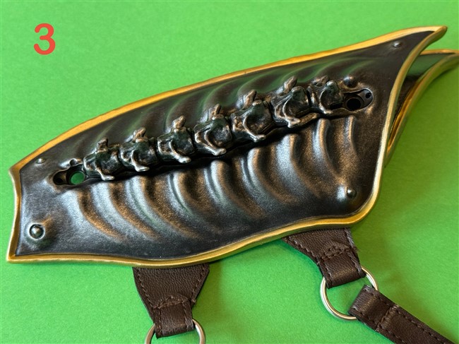

The Right Leg Outer Protection
Place the spine of the protection (51B) onto the right leg assembly from issue 50, pictures 2 and 3. Secure in place using 2 x LP screws, picture 4.
Place the fastening straps (51D and 51E) on the inner pegs securing each strap using 2 x SP screws as illustrated in picture 5.
Picture 6 shows the assembly complete for this issue.

The Left Leg Outer Protection
Place the spine of the protection (54B) onto the right leg assembly from issue 53, and secure in place using 2 x LP screws, pictures 2 and 3.
Place the fastening straps (54D and 54E) on the inner pegs securing each strap using 2 x SP screws as illustrated in picture 4.
Picture 5 shows the assembly complete for this issue.
