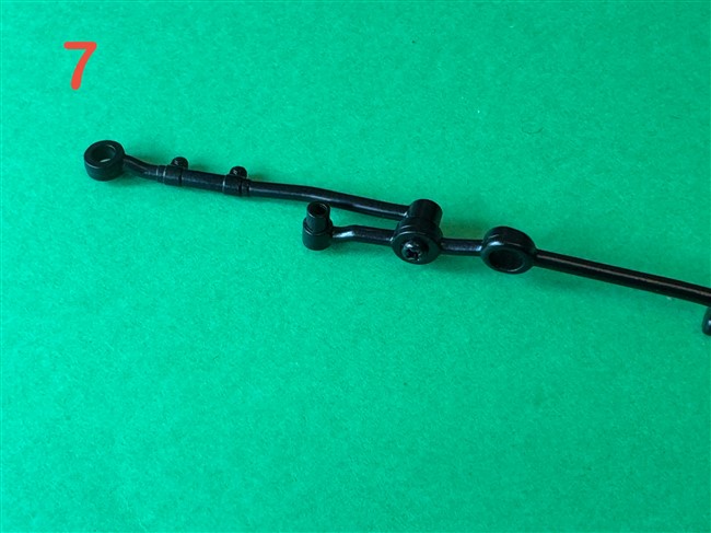

Retrieve the linkage assembly from issue 53 and attach the steering tie rod as illustrated in pictures 6 and 7.
