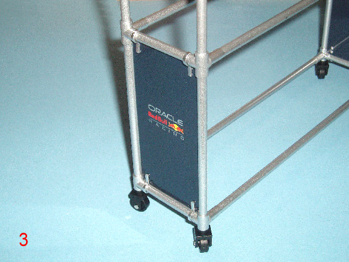

#4 Posted : 16 May 2026 11:48:42
Posts: 5,856
Points: 17,720
STAGE 66:
Tyre rack 2.
Pic 1: Peel the protective film from both sides of the panels 66A.
Pic 2: Press-fit the 8 x brackets 66B into the ends of the panels as shown.
Pic 3: Retrieve the tyre rack from stage 62 and clip one of the end panels in place as shown.
Pic 4: Fit the other end panel in the same way.
Store the tyre rack safely for now.
