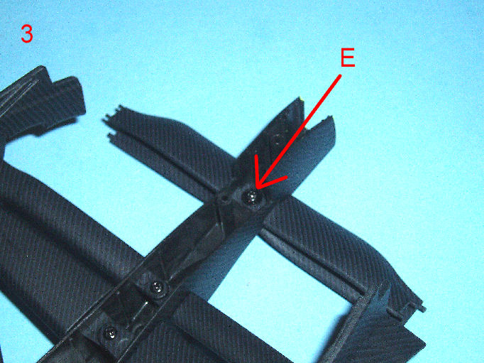

STAGE 71:
Beam wings 1.
Pic 1: Retrieve the rear body assembly and fit the lower wing plates 71B and 71C into the slots at the rear as shown.
Make sure the wings are tilted up at the rear.
Pic 2: Fit the upper beam wing 71A in place and add the support plug 71D in the middle.
Pic 3: Fix from underneath with 1 x E screw.
Pic 4: Retrieve assemblies 70B and 70C.
Fit 70C in place on the body and then fit 70B on top.
Fix from underneath with 1 x A screw.
Store safely for now.
