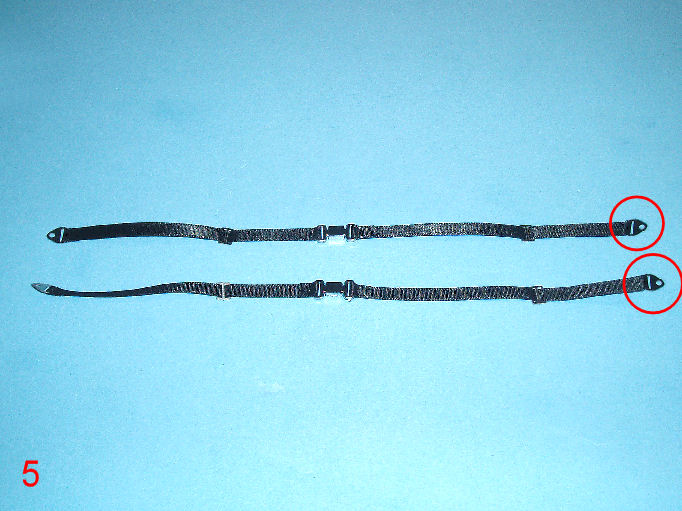

#5 Posted : 20 June 2026 11:53:30
Posts: 5,816
Points: 17,600
STAGE 72B:
Pic 7: Make 4 sets the same.
Pic 8: Lay two of the straps 72J upside down in the position shown and lay one of the 72A assemblies on top, also upside down.
Fit two tabs 72K to the ends of the straps 72J where indicated.
Pic 9: Peel the backing from the tabs and fold the straps over as shown.
Pic 10: Make another set the same.
Pic 11: Retrieve the floor assembly and fix the two sets of straps in place using 4 x EP screws where indicated.
Make sure the strap fixings are positioned as shown.
Pic 12: Fit the passenger seat to the floor so the straps are over the seat and the long straps go through the slot in the upper seat back.
Pic 13: From underneath, fix the seat with 6 x JP screws.
Do not tighten the screws so the seat can slide backwards and forwards.
