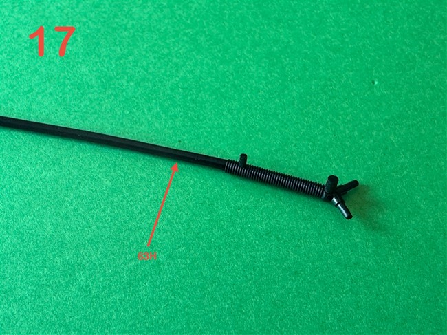

Turn the car over and place the cable 63H onto the parking cable as shown in picture 17. Place the parking brake on the side of the chassis floor and the free and of the cable in the hole, illustrated in pictures 18 and 19.
That completes Part 2 of this assembly

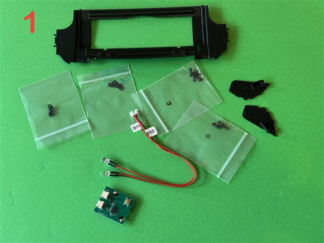

Picture 1 show the parts for this issue.
Fit the two pins of the brake light lens into the housing, picture 2. Note each housing has the L and R on the inside, picture 3. Fit both the brake lights pushing the two pins into the rear bumper, pictures 4 and 5.
Push fit the licence plate onto the bumper as shown in picture 6.
Align the two tabs on the rear bumper with the holes on the rear of the chassis and secure the bumper in place using 2 x F screws, pictures 7 and 8.
Start by placing the left and right panel supports on the trunk panel, picture 2. Turn the assembly over and place 2 x D screws to hold them in place, picture 3.
Retrieve the trunk hatch from the previous stage and place the hinges inside the trunk panel, picture 4 . Secure both the hinges using the hinge brackets and 4 x D screws, picture 5.
Fit the trunk panel onto the rear trunk floor, picture 6, and secure it in place using 2 x G screws, picture 7.
Fit a CR2032 battery into the LED tester and test the two lights. Note: The battery is not included in this issue, picture 8.
Attach the two lights to their corresponding cables in the rear of the chassis as shown in picture 9. Feed the cables in the left and right slots in the chassis, making sure you have the correct orientation of the lights, (D12 to the left and D11 to the right), picture 10.
Place the rear trunk floor onto the rear of the chassis feeding the cables into the slot and secure in place using 4 x G screws from the opposite side as shown in pictures 11 and 12.
