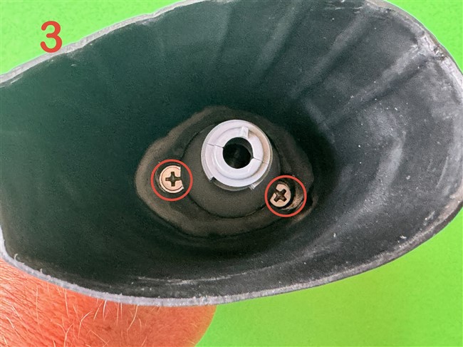

The Left Hand
Insert the left glove cuff into the opening of the glove hand, picture 2. Secure the two parts in place using 2 x L type screws as shown in picture 3.
Picture 4 shows the assembly stage complete for this issue.
