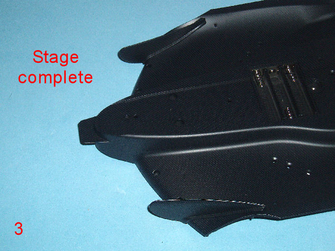

STAGE 77:
Venturi baffles.
Pic 1: Retrieve the floor panel and place it upside down.
Fit the venture baffle 77A as shown and fix from underneath with 1 x A screw.
Pic 2: Repeat on the other side with baffle 77B.
Pic 3: Store safely for now.
